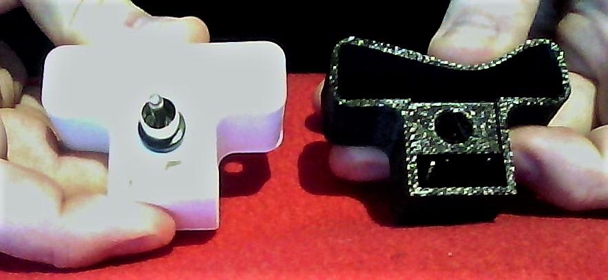

Hi all,
I have a really strange problem: I printed a part in white PLA (ColorFabb I think) and then changed the infill from 20% to 100% and printed it with black PLA from Material4Print. The black part which should be sturdier, is nearly flexible: On the picture I press both parts equally, the white one hardly flexes at all and the black 100% infill part flexes as if it would be Innoflex! The layers on the black part seem to be only connected in the Z-Axis but have close to no adhesion between parallel passes of the nozzle. The wall of the part that I press on feels like layers of paper standing upright next to each other.
What could I change to print proper parts with the black PLA?

I checked that. I use the builtin PLA profile of the UM2. I also did a quick check with the caliper and both filaments seem to be more or less the same diameter: The white PLA was 2.84 and the black PLA was even a little more, more like 2.88. So I would expect a little over extrusion but not such under extrusion, or?
