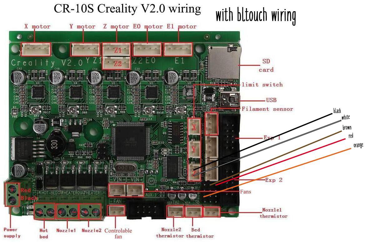

It appears that the Bl-Touch is wired incorrectly for your CR 10.
Brown wire is ground, Red wire is power.
Look Here for More information
Connector Pin exchange

I do not know! I found the Creality CR 10 Wiring diagram for BL-Touch was keeping it for myself if I decided to add BL-Touch.
When I saw this post thought it couldn't hurt so posted just in case it would be helpful in this case.
