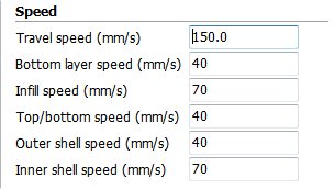

Inside Cura At a Speed of 86 if you hover over the Print Speed is shows
"You are trying to print a more then 8.0mm^3 of filament per "
"second. This might cause filament skipping. (You are printing at "
"9.6mm^3 Per Second)"
Is this correct or is my settings causing my printer to print at a different rate.
Mind you that my prints come off at almost exactly Cura's estimated time.
I am thinking because the Slicer sends the F2400 the speed are not correct, but 80 percent of the set F3000.
So that would make my print speed of 86 actually 73.96 or
"8.3mm^3 Per Second"
Is my understanding close to correct, if not please direct me to how to calculate my actual print Speed.

Maybe I stated it incorrectly - How do I calculate my Print Speed in a way that can be understood.
