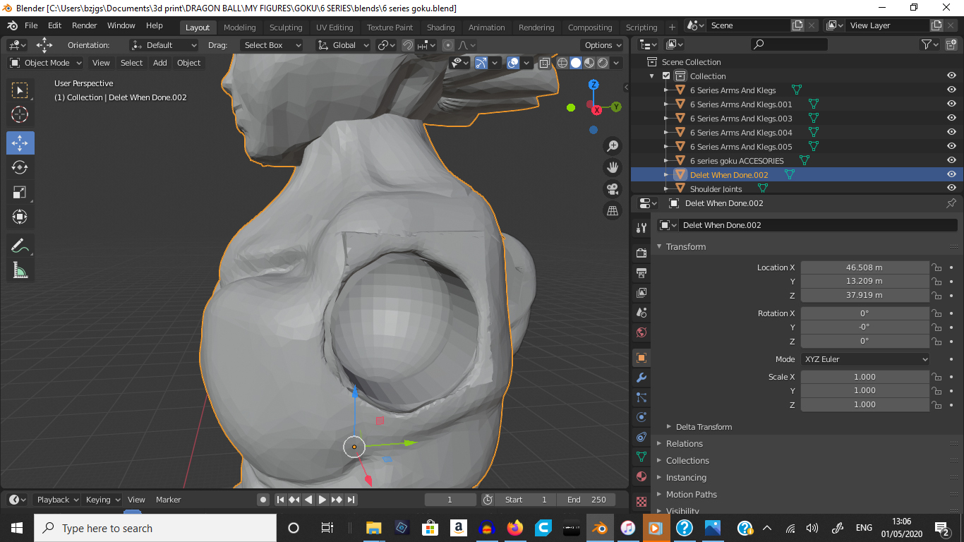

unfortunately, I don't have a pic of the print gone bad. once it was done I wound up drilling out the extra material but here is a pic of the blend itself.
that rounded area is supposed to be a hollowed-out portion of the print but it keeps filling with pla, no matter how i orient the print

A 3D printer should only print where you have placed your model on the board in the 3D software. This is a hardware issue for sure.

Can you show a screen capture of the Model sliced, I assume you are using supports everywhere an showing the supports will show this.
When using Prusaslicer you can add a modifier that you use can to tell the slicer not to add supports around the holes.
If you need help we can help you get it setup.
