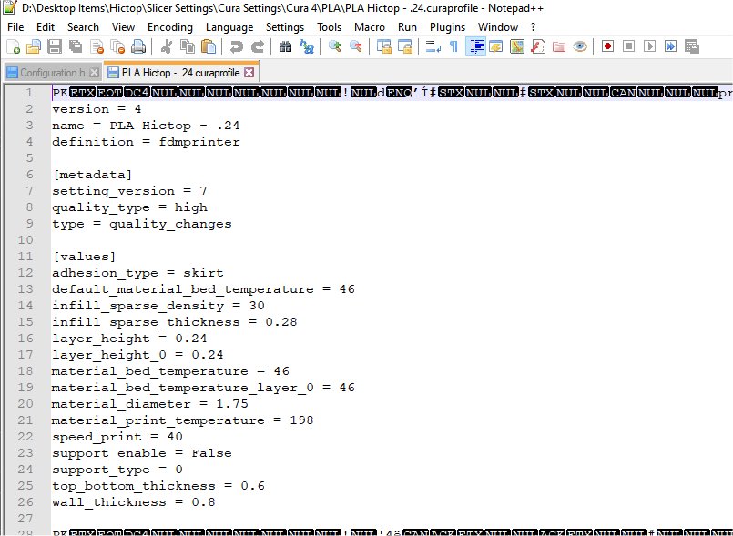

The easiest way I know of would be to save the Profile.curaprofile open with Notepad++ and print.

Thanks. I just gave this a try. Obviously it does show you what the setting are but a little hard to read. Good suggestion, though.
I put the page breaks in to try and sort it out a little...

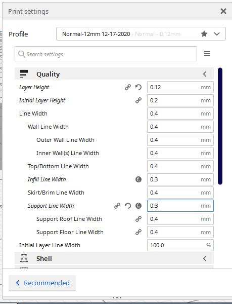

Other option is to make screen shots and save. Cismontguy
Re: Is there a way to print out Cura's setting under Profile?
The Screen shots are actually the best, it does take many screen shots sometimes.

That's strange I open mine with Notepad++
Are we talking about another file.
