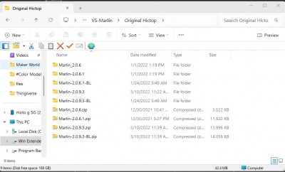

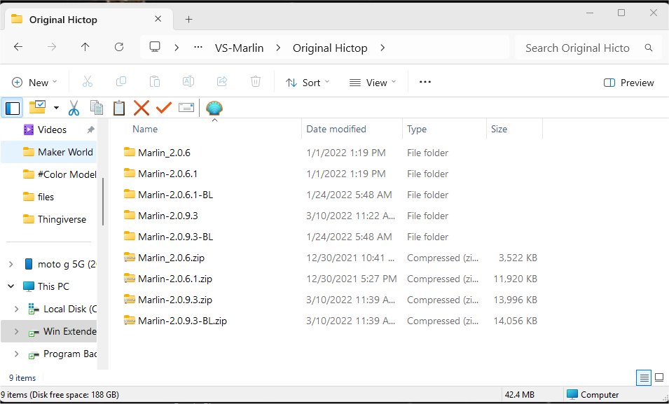

Re: Update to marlin 2 3dp12
I use Win Merge to convert one version configuration to another version,
Loading an older working version sub file example(Configuration.h From working version and version to configure.
Compare them line by line updating what you want. As you progress you may note they changed some variable names.
You can even download the Marlin source from Hictop though it is so old it will take a long time learning how convert it.
This is mostly what I changed in Marlin 2 versions. Ps I started with Marlin_Chip Luck's version:
I converted 06.13.16, HICi3-1.1.0-RC6-Bugfix though many Marlin 1 & 2 versions then said not much more firmware can do.

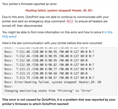

I'm not sure, I keep getting failed jobs due to heating failure before it starts, even if I don't probe.

I've been doing more investigating, could you try turning off THERMAL_PROTECTION_VARIANCE_MONITOR
https://community.octoprint.org/t/therm ... e0/41836/2
