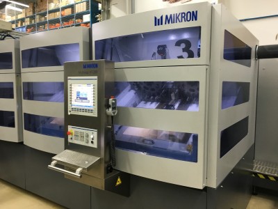

Hi Paul,
yes we have a machine to test customer applications. it has loading cell and 2 5xmilling modules.
This machines are made for mid and high volume productions.

Boy do I have some R2 drawings I'd like to see you CNC with thatRoland wrote:Hi Paul,

Re: Water cooled hotend
That would be small... the maximum size is 200 x 200 x 200 mm
