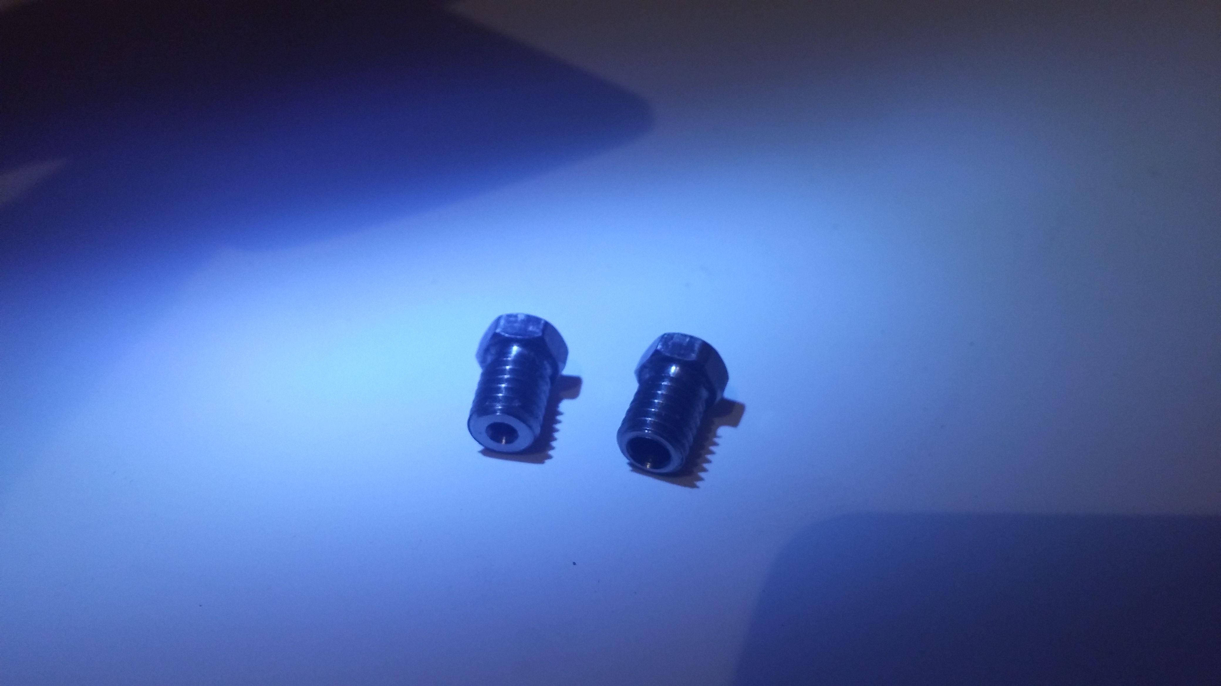

I also try to create new versions of nozzles with high resistance to impact. In my case, they are made of titanium alloy. If not all available volunteers, who printing with exotic filaments, are already busy by testing the new ruby nozzle, I'd be happy to send the nozzles to test. A fresh set of photos below:

Nice, do you have some rough number of the thermal conductivity of that titanium alloy?
As I said in the email, we have been discussing medical applications previously where titanium would be preferable.
The possibility of coating these with harder or more slippery materials is also interesting.
Some of those really hard coatings used for machining tools are titanium based, which makes it likely a titanium based coating will stick well.

2 neotko By the way, Yes, I like the idea of electroplating with tungsten, considering its thermal conductivity in the area of 0,31 at 20 degrees Celsius. In the city there is a shop, they work with chromium, nickel and cadmium ,but I'm not sure about the tungsten . On Monday I'll know for sure.
2 LePaul Thanks!
2 Anders approximate analogue of these alloy in German classification, it DIN,WNr 3.7034 or DIN,WNr Ti2. Becose of this thermal conductivity is equal 18.85 at 20 degrees Celsius. In any case we need a heater with a capacity of 35 watts or more, and new delay setting in the UM2 firmware for guaranteed to heat the nozzle fully. I think about the idea that the titanium disulfide is a perfect solid lubricant. What if to cover the inner surface of the outlet nozzle? Will there be the possibility of obstruction less?

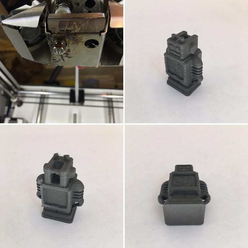

Today Ken aka Skinny-kid from umforum send me this message
Well since I have no patience and the carbon fiber filament won't be here til until tomorrow, I went ahead and started using the Stasinless steel filament from Proto Pasta I have.
Last time I tried this filament was with a slightly used ptfe coupler and a brass nozzle. It never printed, only clogged that way!
I put in a new coupler before I ran the silver PLA and have already printed out the Ultimaker robot as a test piece. It printed well at 220 degrees, .2 mm layer, at 45 mm/s.
I am now running a second print but wanted to show you how things have gone so far.

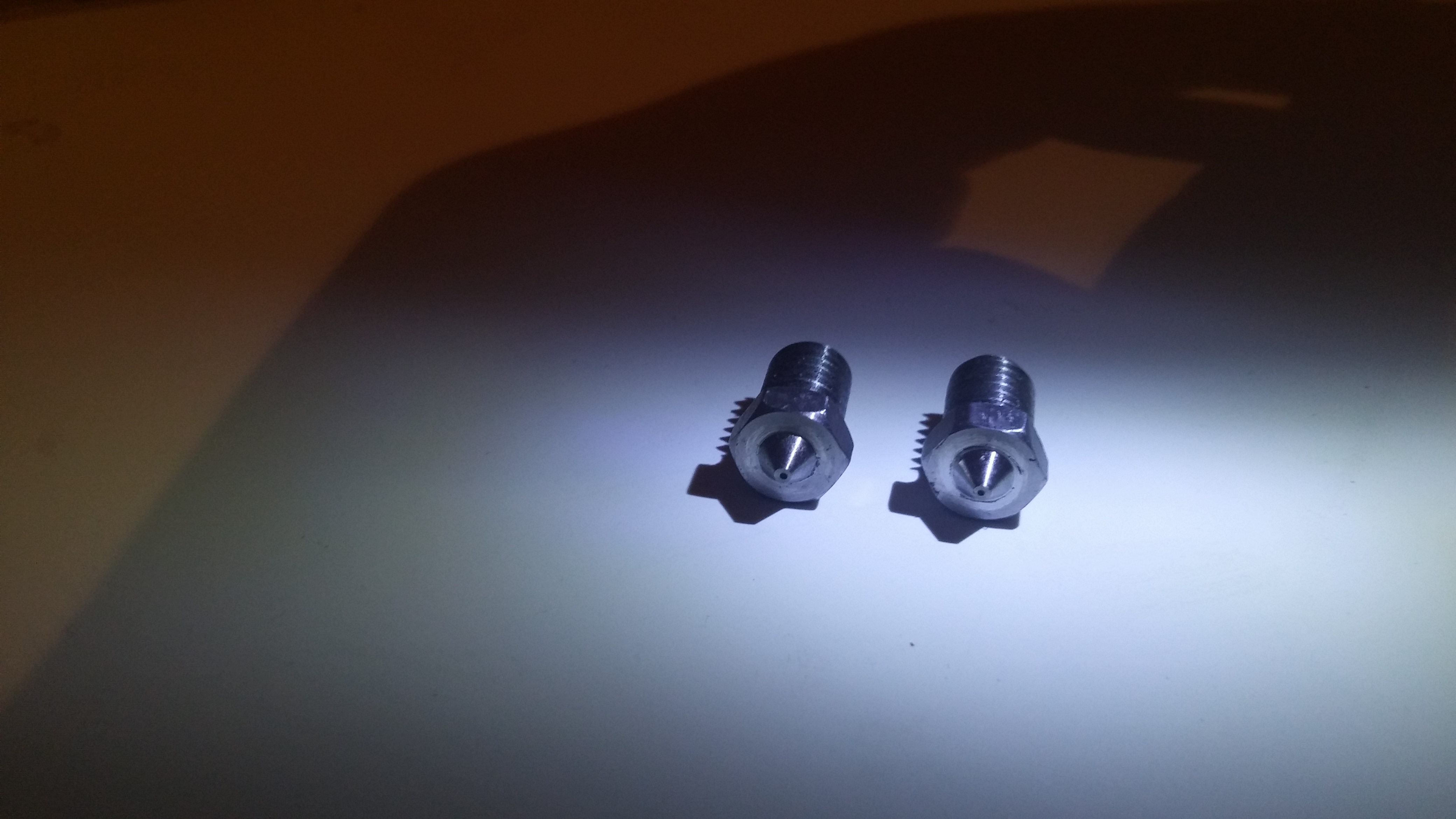

I sent the titanium nozzles that I got from Ivan to a company that does chemical nitriding on titanium, which creates a relatively thick layer of titanium nitride on all surfaces of the nozzle. Here is a picture of how they look after the nitrogen treatment: As I am quite busy, if anyone here wants to test them I would be more than happy. Ivan has priority of course and I only have three nozzles, one 3 mm and two 1.75 mm, so Ivan has to decide first if he wants them.
I could actually keep one of the 1.75 mm nozzles myself, but the two remaining I am happy to have tested.
Testing with abrasive materials is of course most interesting since titanium nitride is supposed to be very hard.

Hi Guys, they look great, how does the inner bore of the nozzle look? Nice and smooth, round and to size?
