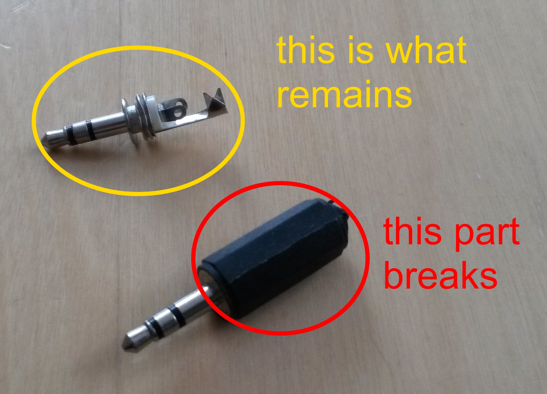

Hi all,
I have a couple of 3.5mm audio jack plugs here where the plastic cover is so brittle that it breaks into pieces on the first touch. Since these covers are not too complex, I had the idea of printing new ones. The only problem is the thread that connects the metal part of the plug with the plastic housing. I have no idea what thread size it could be as it seems to be a non-metric thread. The outside diameter of the metal thread is 0.3 inches, the inner diameter seems to be something around 0.285 inches. Under which name could I find such a thread in Fusion 360?

Threaded inserts will not work in this case I think:
I would like to create a spare part for the black cover.

I have one 3.5 jack plug under hand and it seems the same of yours shown on the pic you posted :?:
I print a test before share the files, I had just to screw easely with the the fingers.. :roll:

when seeing your pic, the thread of the metal part is very deformed, may be the problem is here !?
