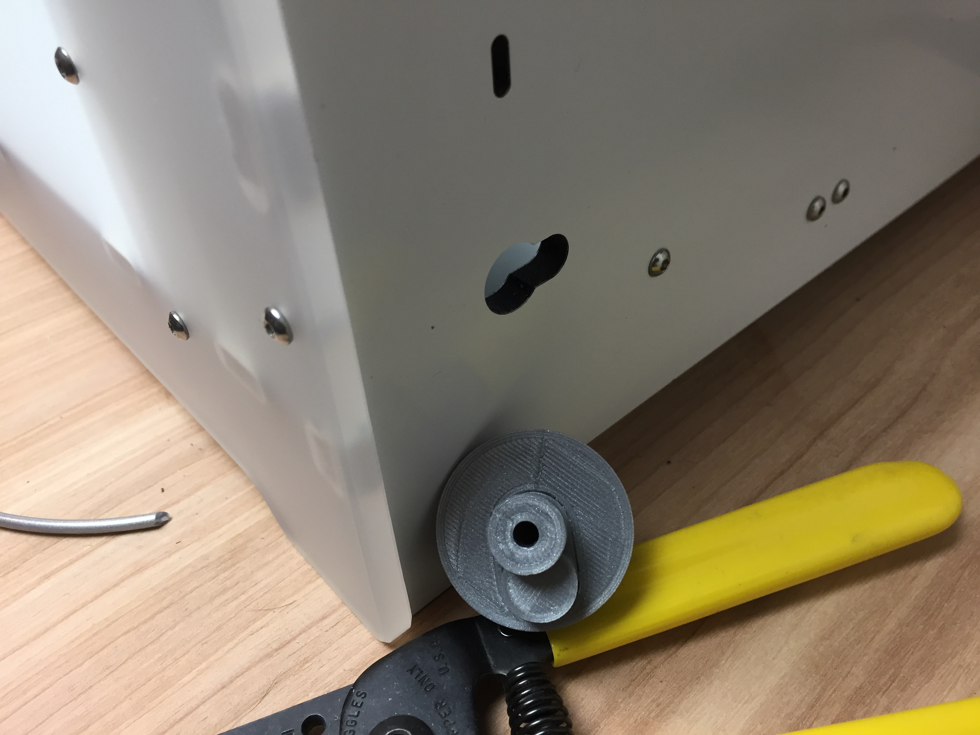

Your model looks like the M4 is screwed just into the plastic of the last part. Maybe there is a thread modeled or the hole is just a little undersized and the screw will cut its own thread.
Good point. I have an M4 tap if it comes to that.
Then....on to this part....sized up a tad so i can get the bearing in without breaking it
https://www.thingiverse.com/thing:858734

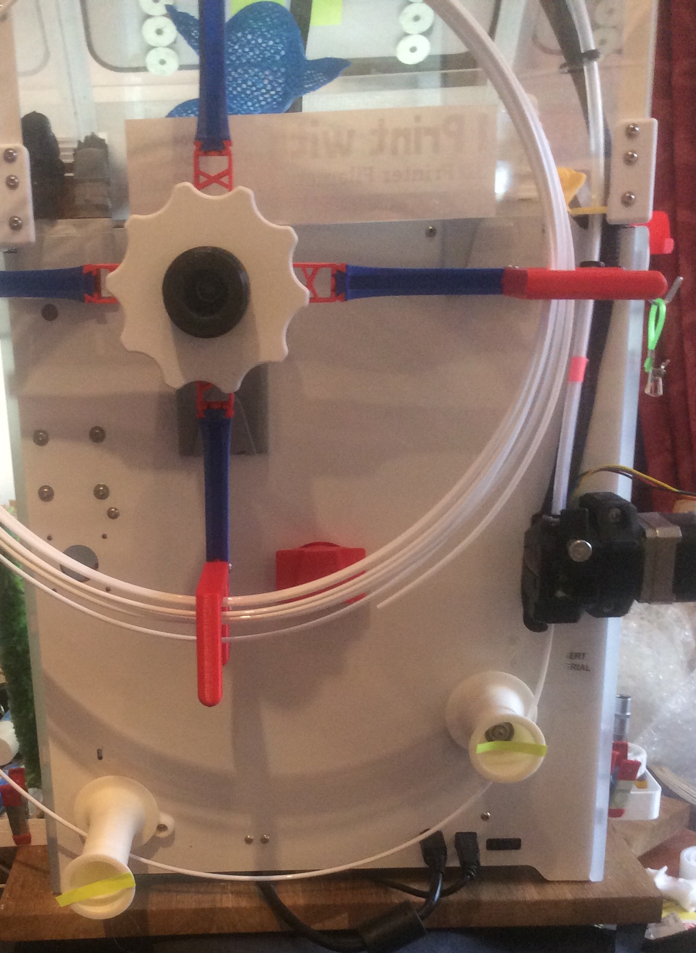

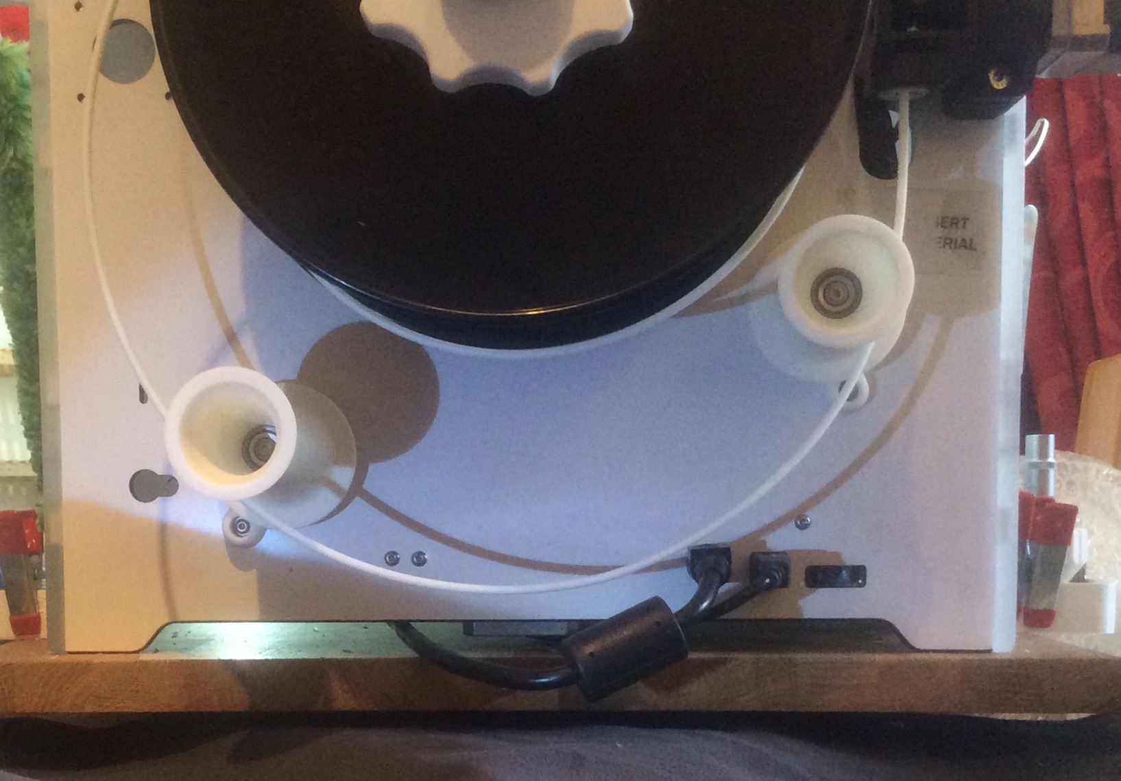

Finished printing and installing my new bearing guides, photos below, details of the parts and bearing and screws etc if people want them will follow and also be put on YouMagine.
They are attached via the screws used on the back although slightly longer screws are required, and the swivel about the mounting points to all alignment.

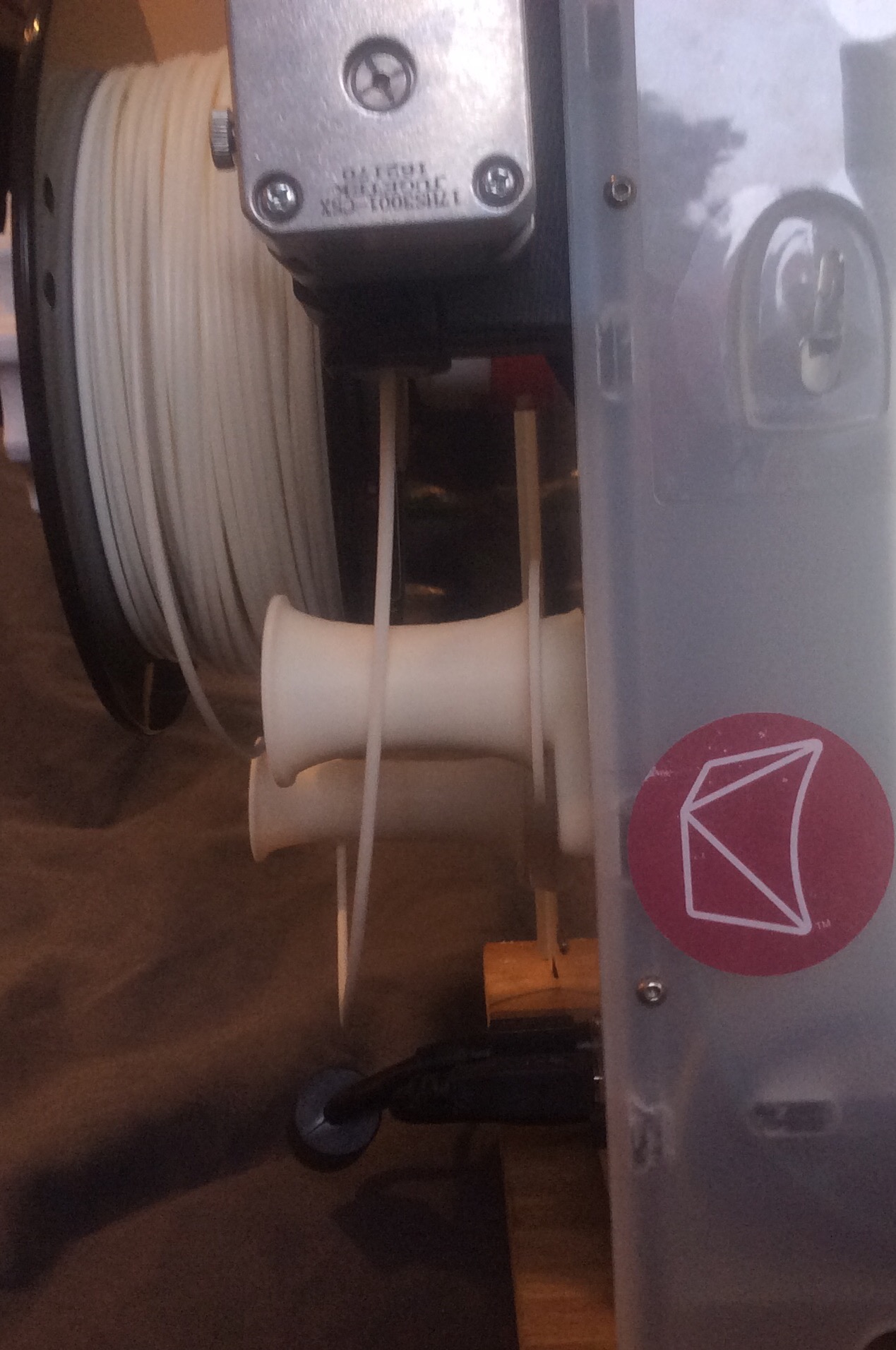

So how is this supposed to sit flush on the back
Ok....asked on Thingiverse and got the answer
Better way...remove Y motor cover and install
101% on the other filament guide fit perfect!
Installed. Let's see how a 14 hour goes!
Izzy; i've created a new bracket for the BondTech Feeder. you can just use 2 longer M3 screws on the top, it bolts right on the back, the feeder is sitting on back very high on top and you can use the original brackets.. no need for all those filament guides...
(i've never used any of those and i've logged some pretty impressive hours without failures)

Hi Korneel, I looked at your Bondtech mount but it interferes with my mounting system and the large filament holder.
I'm fairly happy where the feeder sits at the moment but I'm considering fitting a USB driven cooling fan and duct about the Bondtech feeder body as it gets a tad warm on lots or retractions, although a raspberry pi with a temperature sensor that can control the fan might be better.
