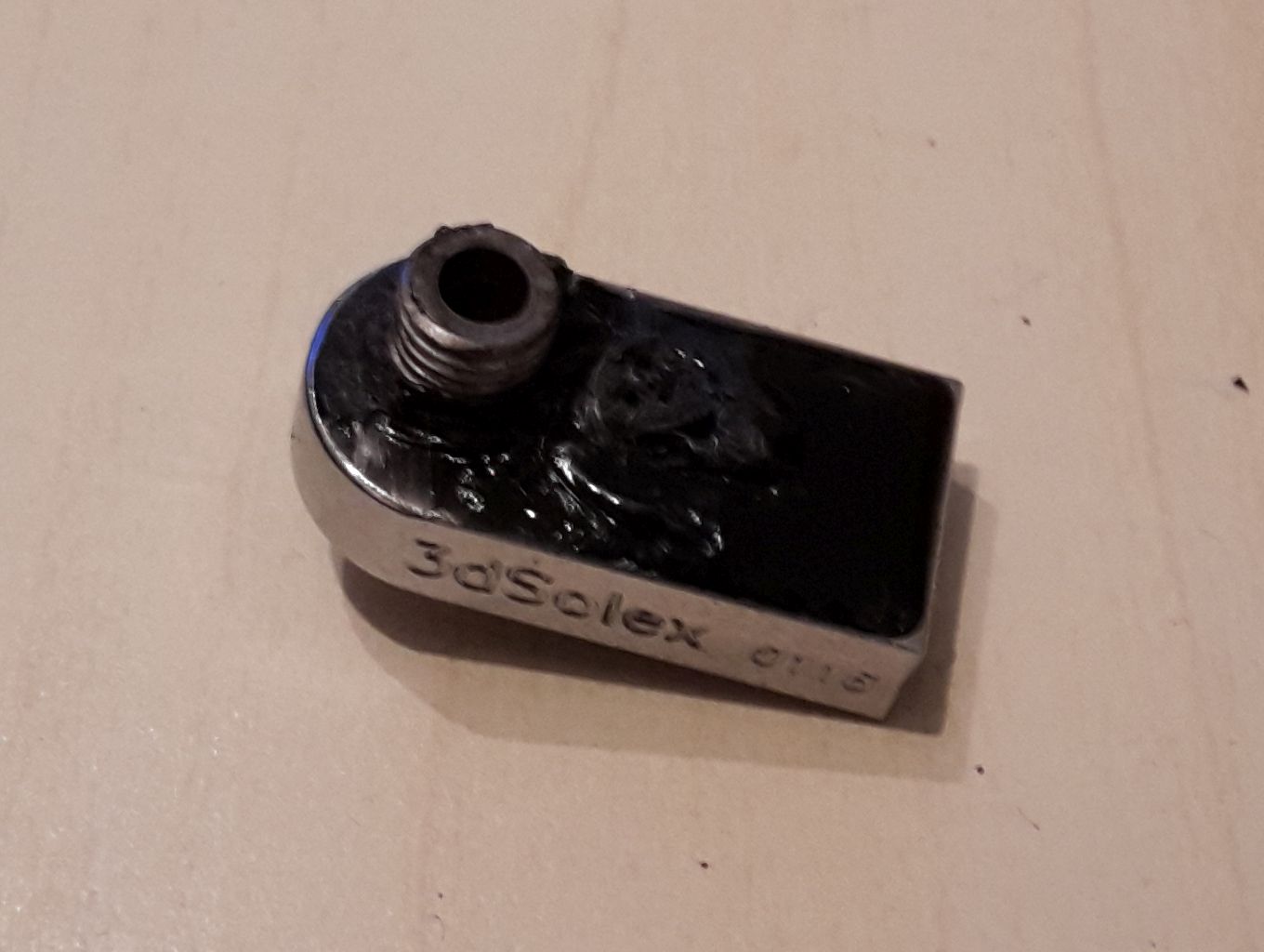

I recently had an "accident" while printing and now the underside of my block is covered with a thick layer of black PLA:
Do you have any tricks on how to best clean that off? I thought about a Dremel with a wire brush tool but maybe there is a more gentle or easier way to do this?

Can you heat the block with a soldering iron and at least scrape it away while warm?

Best way is to heat it to 100-110 and pull it out. Or a hairdryer and pulling it out. At certain temps it goes out as one.

Removing the block of plastic isn't difficult but can require some patience and time. Let's say that the plastic in question is PLA, start by heating up the print head to ~100C and let the heat transfer into the plastic for a couple of minutes to soften it. If you're lucky you will now be able to remove the block of plastic in one go. At the very least you should be able to get rid of the worst of it. If the plastic wont budge, start increasing the temperature in increments until it starts to give in.

I tried with my tiny little hair dryer but that was not too successful. I will try it again tomorrow with my heat gun.

I use the 'korneel' method: gas burner and alcohol.
