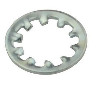

The washer was also changed early 2016, from one that looks like this:
Old washer.jpg (16.41 KiB) Viewed 14456 times
To one that looks approximately like this:
New washer.jpg (8.71 KiB) Viewed 14456 times
The new washer is mounted on blocks sold by Ultimaker and by 3DVerkstan and their resellers from early 2016.
Posts: 510
Location: Stuttgart, Germany
Re: Dimensions of the heater fastening screw and washer on the block?
Post by reibuehl »
The new washer is a DIN 6798 A. I ordered 10 now.
