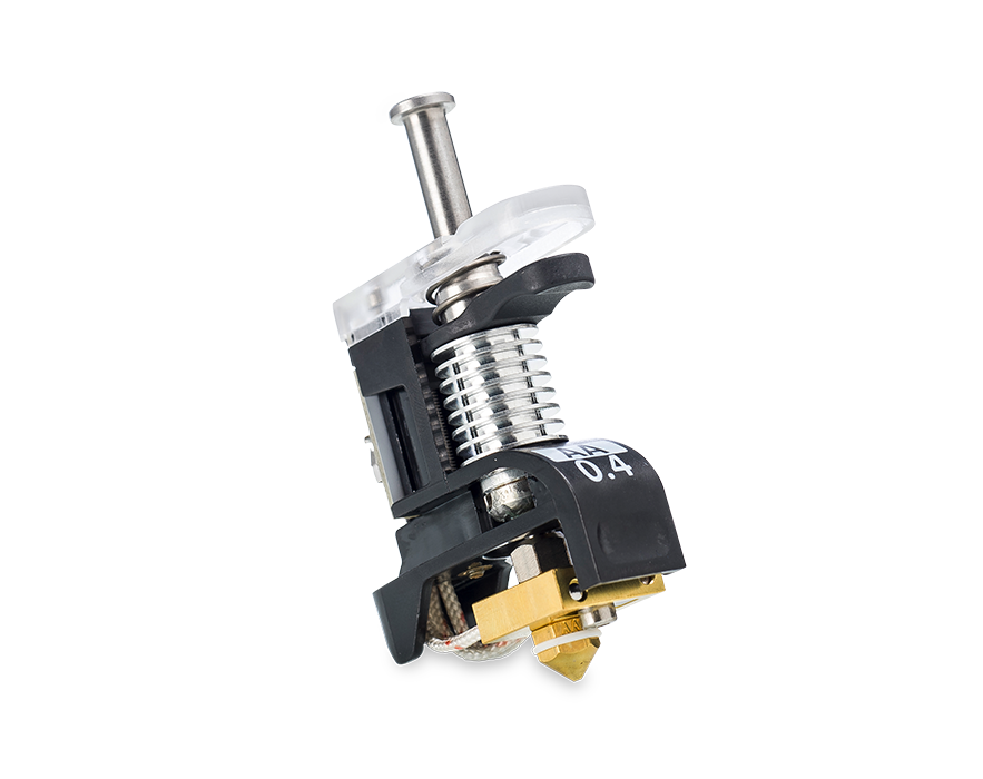

Yeah! Finally dongle chips for nozzles to prevent stuff like exchangable nozzles.
How much are these per piece - just in case you need a new one after every 5 rolls of CarbonFill?

Re: Teaser for the New Ultimaker....here we go!
I suppose you can still replace the nozzles on them...?
Not to my knowledge. You are supposed to replace the whole print core as far as I know.
Judging by the photos, the brass portion is pressed to another, wich made either of steel or titanium. No way to change.
At €120 for a print core I honestly can't imagine they're supposed to be disposable...
http://www.makerpoint.nl/en/3d-printing ... r/4241486/
Also it just doesn't make sense to throw the heater, sensor, cooling block, etc., away when all that needs to be replaced is the nozzle.
Well they can sork 280C continuously and I think that their max temp is 350C but that could damage them. So max normal use is 280C and you can go higher at your own risk.MTVDNA wrote:At €120 for a print core I honestly can't imagine they're supposed to be disposable...
There are threads both in the heater block and in the heatbreak and the nozzle goes right through the block into the heatbreak.ivan.akapulko wrote:Judging by the photos, the brass portion is pressed to another, wich made either of steel or titanium. No way to change.
So you can unscrew the nozzle, assuming that you use 7 mm spanner to prevent the heat break from rotating.
If you put too much force on the heat break, like trying to unscrew the nozzle while holding further up on the print core, you will destroy the heat break.
In theory, one could replace the block with something where you can put standard nozzles, but in practice you would destroy the heatbreak when you tighten the nozzle. (That does not mean it is impossible to make an "Olsson block" for the print cores though, I already designed one for my own experiments which I will test shortly
If you unscrew the nozzle by the way, you must get it back so that the number of threads between the heat break and the block are the same, or it will not work.
The proper way to mount it is to start with the block and the nozzle and add the rest of the components of the core in order.
That however requires some special tooling, just attacking it with normal pliers can work but it will leave scratches on the components.
