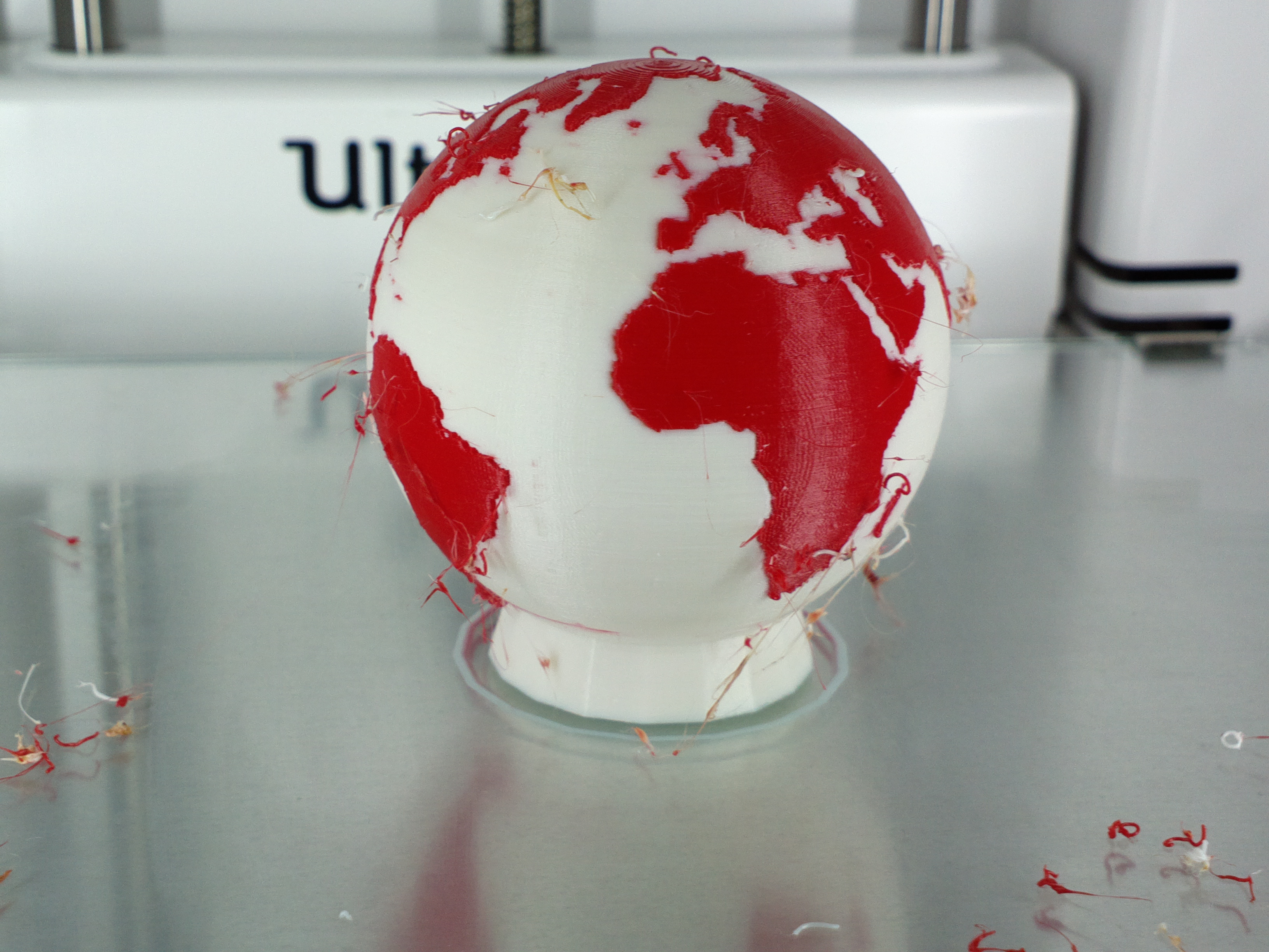

I suppose I am allowed to post Ultimaker 3 prints now, in case some of you who did have the opportunity to play with one yet are curious :-)
So here is how the globe came out in ABS, I think it is this model: http://www.thingiverse.com/thing:15658

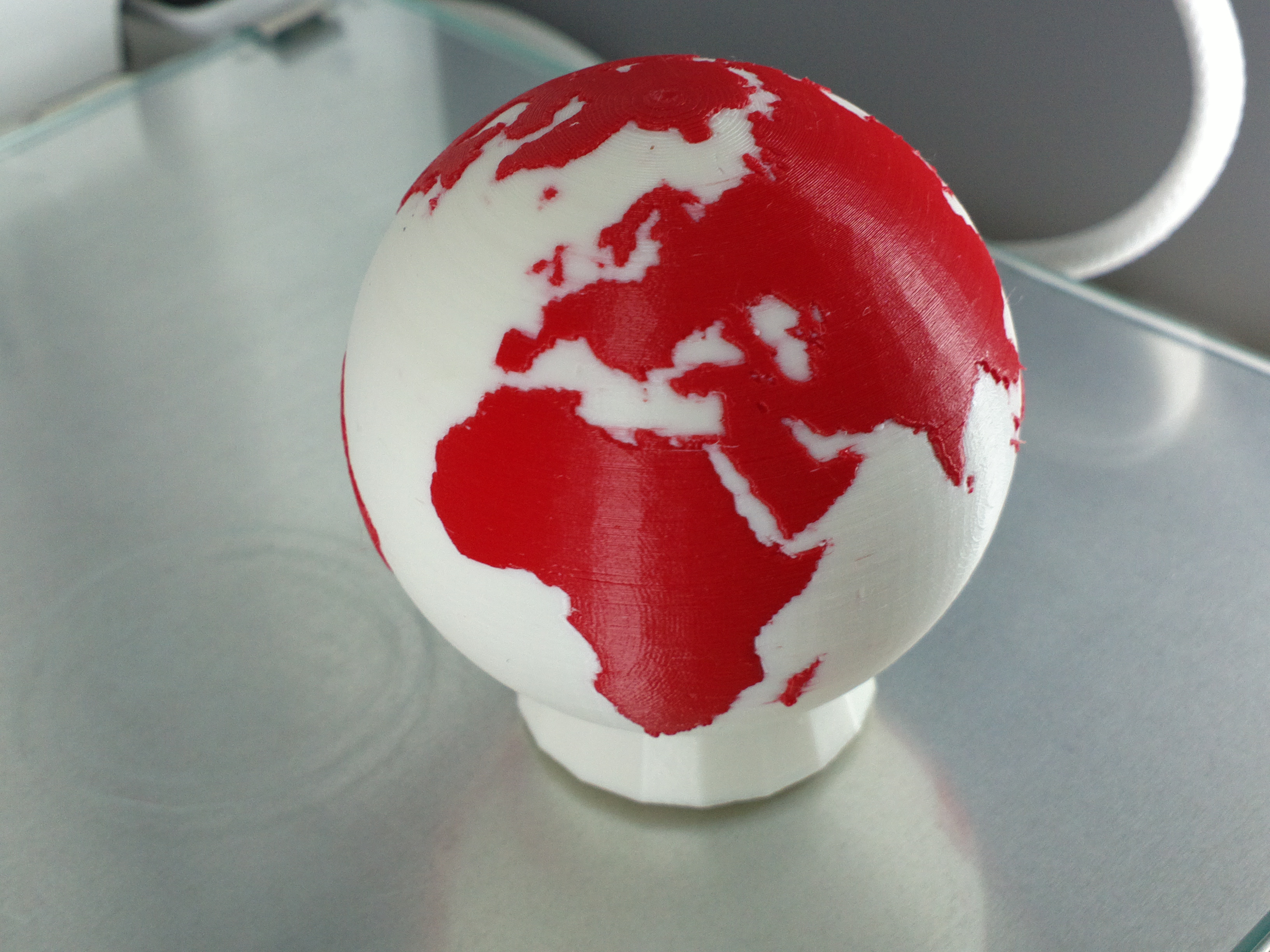

And after vacuum cleaning the surface it looks like this:
Considering that I was not using a priming tower, that the UM3 does not have any wiper for the nozzles and that this was still on beta firmware and software, I think that was a pretty good result! :-)

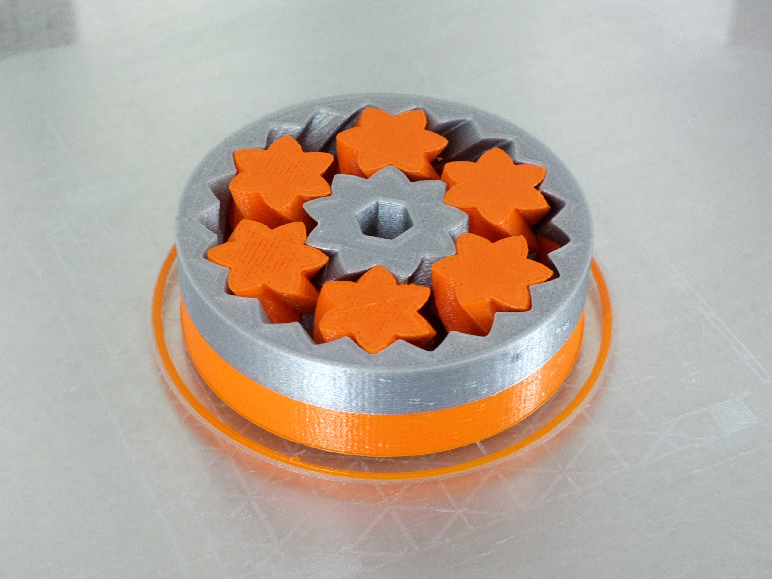

Simple geometries like this gear, printed in PLA, prints even better:
No wiping tower or tricks there either.
