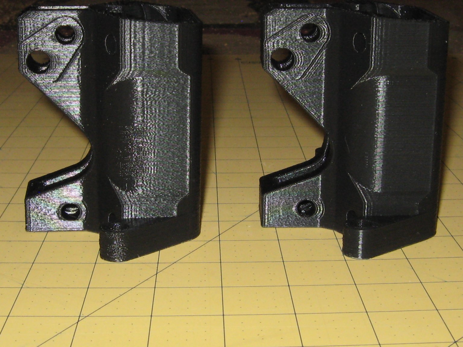

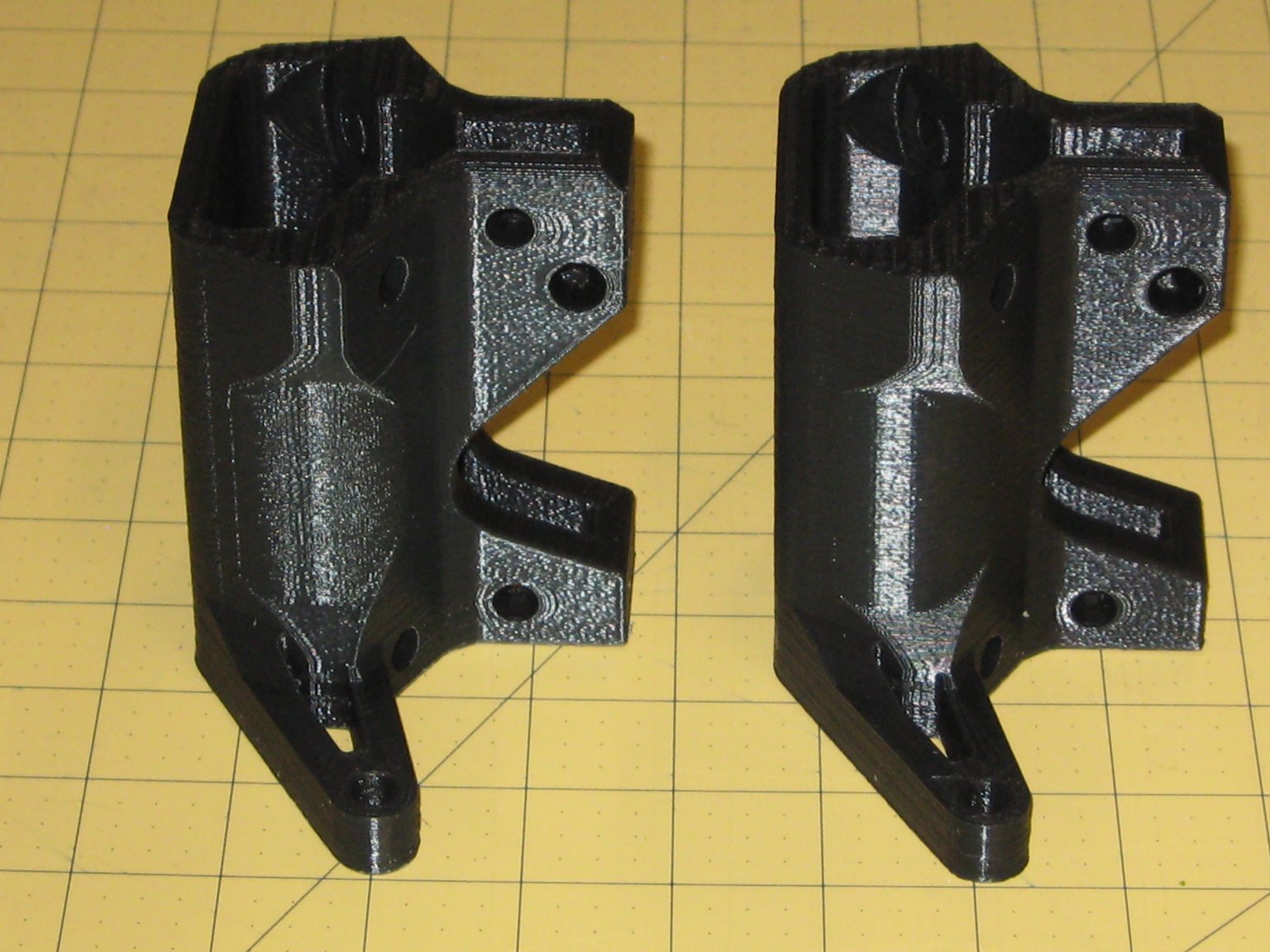

I have noted a distinctive difference between the SD card Print and the OctoLapse Print textures.
Noted: in the Photos above the model on right was printed with the SD Card While Model on the left within OctoPrint's Octolapse.
You will note a distinct texture difference. Will print another model using same ABS filament with SD card to verify if smoothness returns.

- Posts: 4059
Re: V1 Engineering's Piper
What print speed?
There's a well documented issue with artifacts happening with Octoprint/USB connection at speeds higher than 45-5- mm/sec
You can go a bit faster on SD
It also depends on your controller board's UART/IO controller

- Posts: 1480
I slice with Preset known good Saved Cura settings. With Print Speeds between 7.8^3 - 9.6^3 Per Second. (" 70-86 ") Percent.
Using Cura 15.04.6 " 76% is my average speed (if cursor is hovering over "Print Speed" 8.5mm^3 Per Second). "
Sliced the Models first store in G-Code Sliced folder on D: Drive copied to MPCNC folder on SD then printed from SD Card. All printed Great.
Uploaded from G-Code Sliced folder on D: Drive to Octoprint Files directory then printed. Printed fuzzy.
Do not get me wrong, it is acceptable just fuzzy, as you can see it just is not as good as it could be...

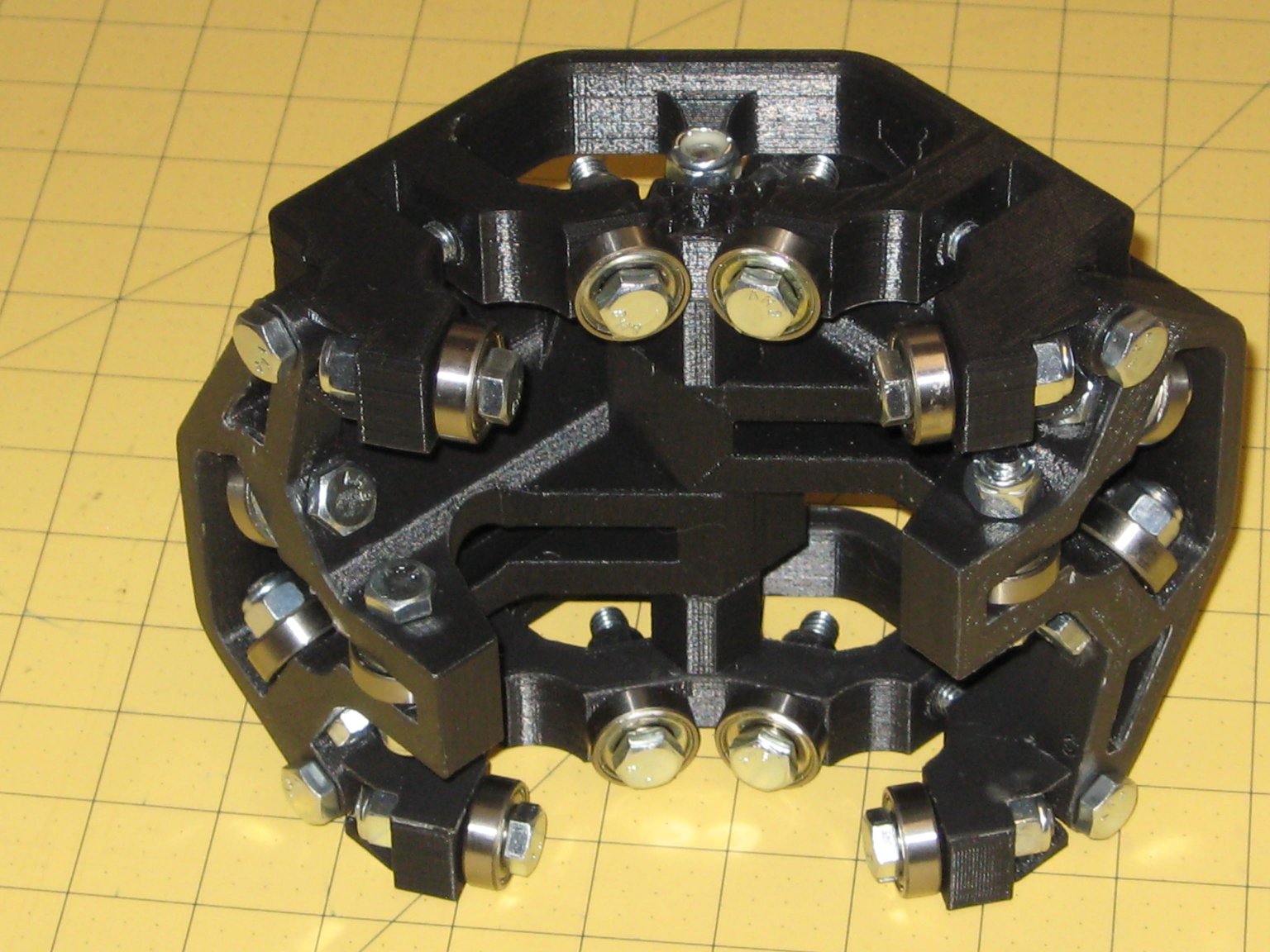

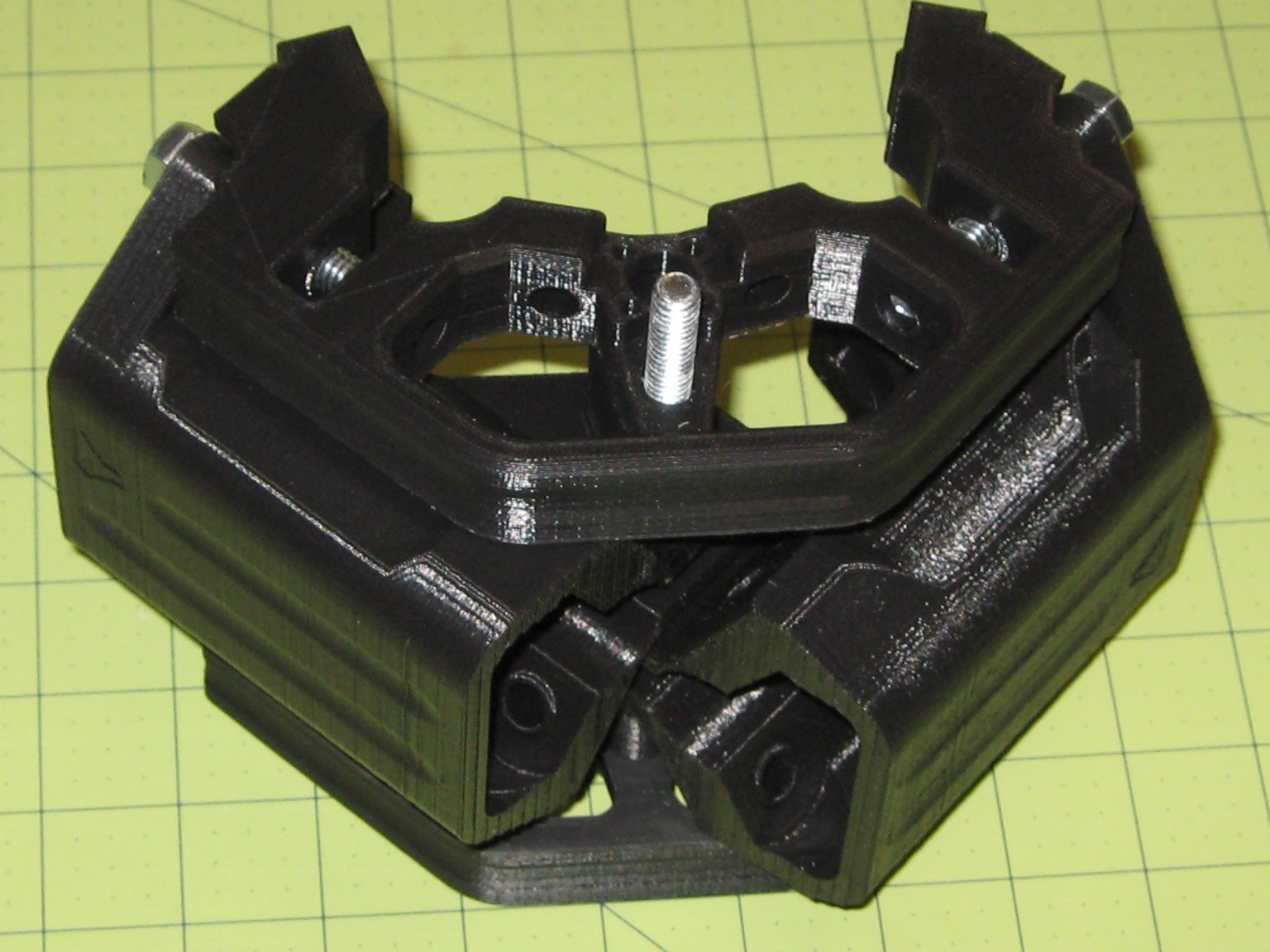

Assembled the Middle Assembly today still need the conduit to assembly the remaining frame Assemblies.

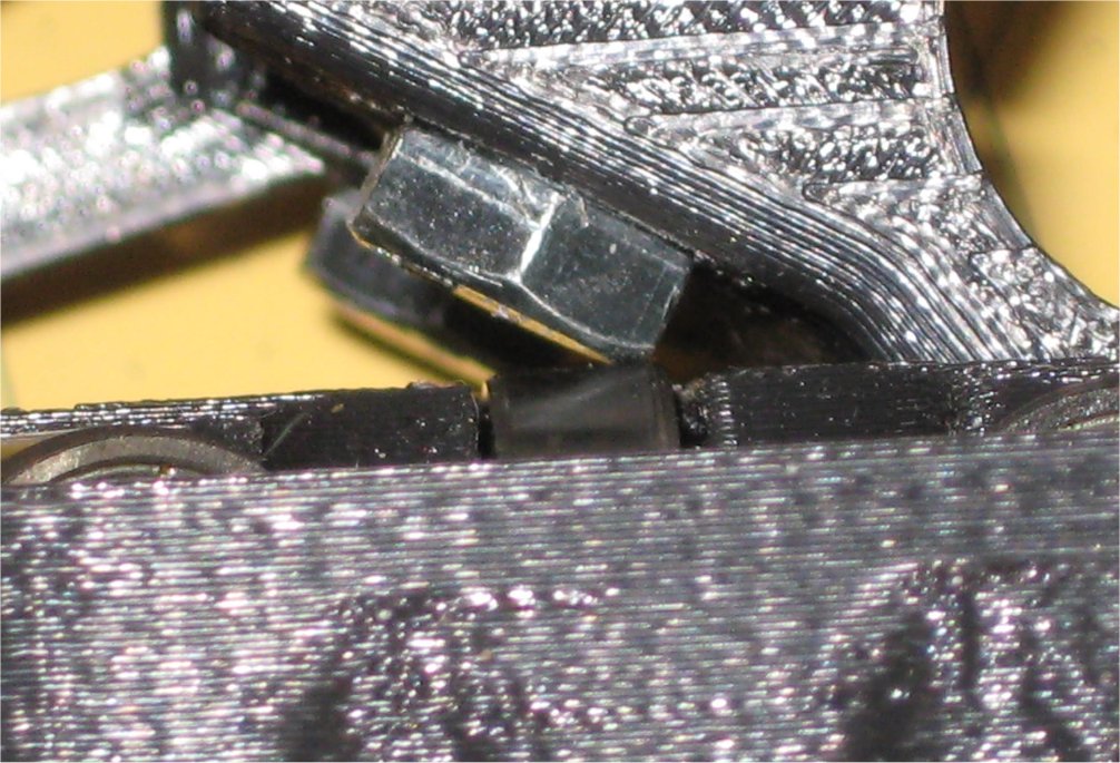

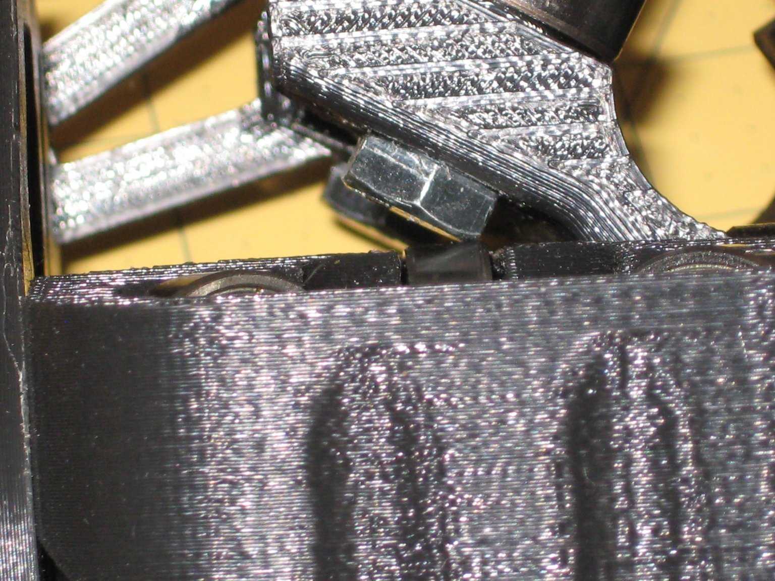

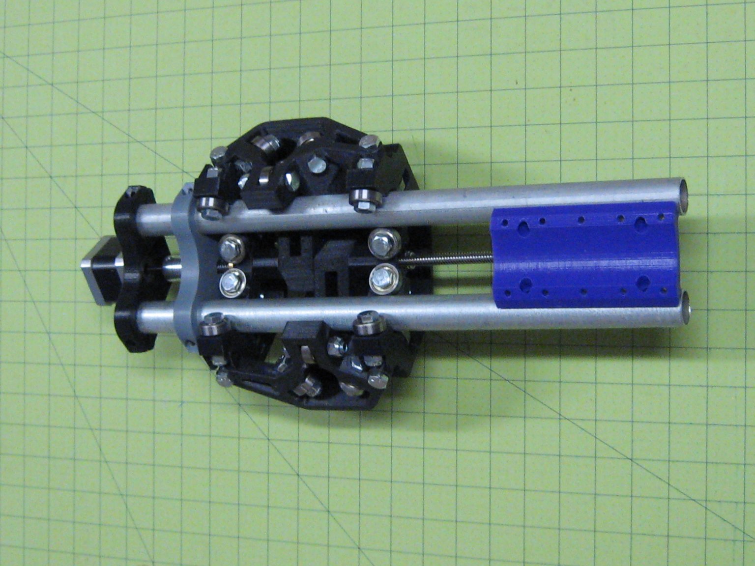

Found a problem with the MPCNC Design.
You can see in the middle assembly, that the 5/16 bolt head and the Bearing are touching, This will have to have thinner Bolt Head.
Will be Grinding about 1/2 the thickness of the bolt head away to allow the bearing to freely spin...

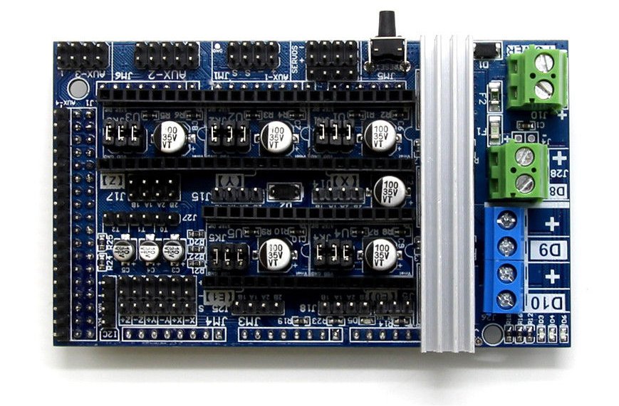

The build is going quite slowly, simply because when I started this project, was hoping to use some of my spare 3D Printers parts.
This scenario is quickly proving not to be the case with the MPCNC carriage growing heavier than expected,.
Decided on the controller, drivers an lead screw. An Arduino Mega with Ramps 1.6, this one is equipped with a mosfet heat-sink
Decided to use the T8-2 lead screws this is a trapezoidal 8mm lead screw that has a pitch of 2mm per revolution.
Decides against my spare parts stock T8-8 lead-screw as the weight will allow the carriage to drop when power is turned off.
T8-8 Lead-screw Gravity test
As you can see the carriage has been assembled with a minor setback again needing to order stronger steppers and a new T8-2 Lead-screw.
This by no means will stop me from partially assembling the MPCNC's other components while I wait for the remaining parts to arrive.
Assembled with a temporary 56oz Stepper an T8-8 Lead screw
