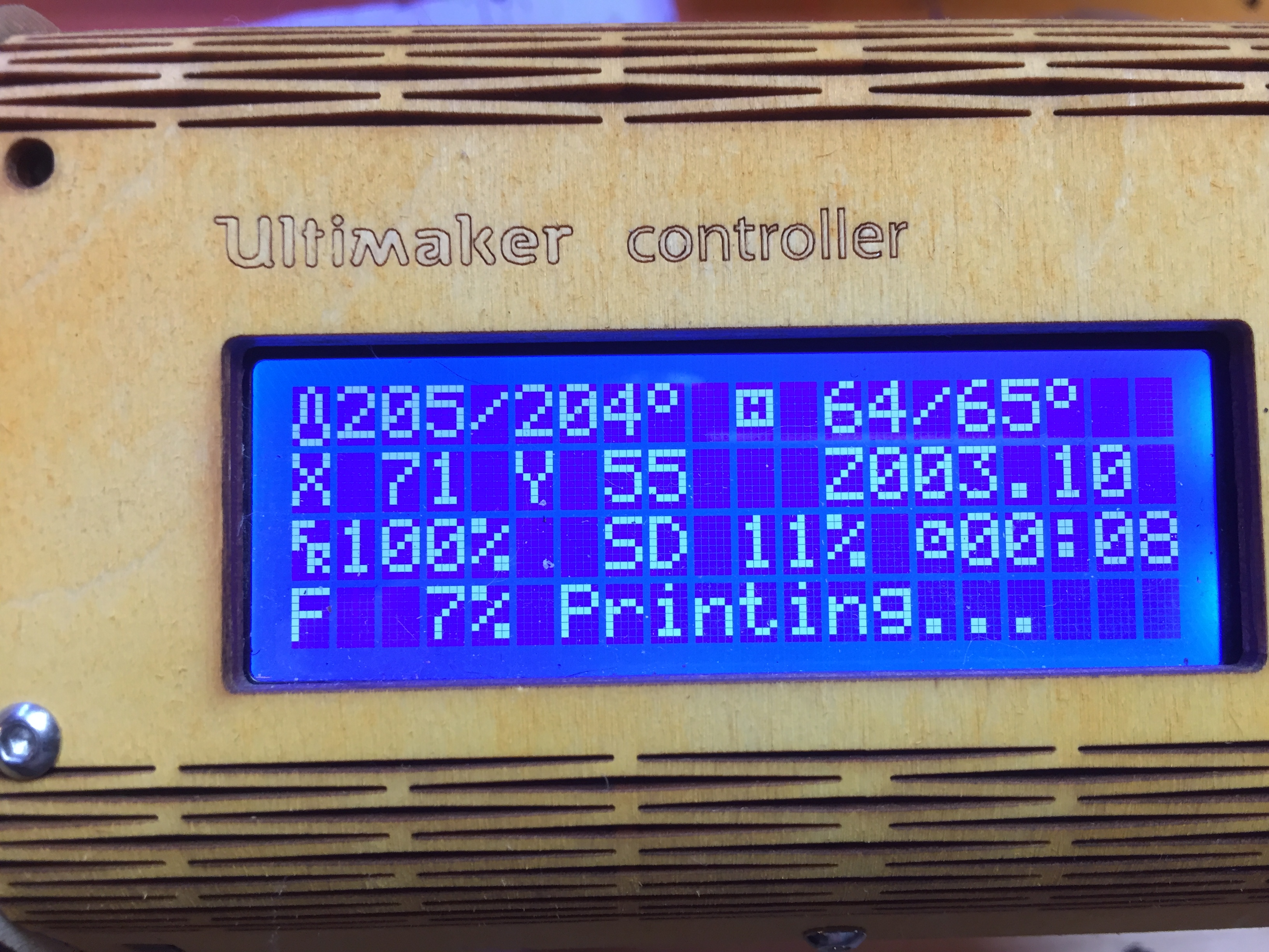

Amedee, one thing I did tonight...(asides addressing the pulleys in another thread)...
I'm a little confused on the fans and not sure it's Cura or firmware.
Fan Speed Min (%) is set to 2 (Fan speed equals 5.1)
Fan Speed Max (%) is set to 20 (Fan speed equals 51)
(I cheated and used this link to calculate percent of 255 values)
Now my question...on the Ulticontroller, fans show 100% but when i look at what the fan speed shows, it shows the Fan Low value.
It was beyond the "Full On" height
Which leads me to wonder...for example with nGen, which wants 50% fans, how to force that into Cura (or do I need to upgrade from 15.04.2)

LePaul wrote: Now my question...on the Ulticontroller, fans show 100% but when i look at what the fan speed shows, it shows the Fan Low value.
I am pretty sure you are looking at the feed rate, not the fan...
With the legacy firmware the fan percentage is not displayed, you need to enable 'Fan percentage' in my builder to get it.
Display
Display
(Note that this is an old picture, on recent builds the Fan percentage is on the left side)
Re: Testing for the new shroud?
Yes!
I need to re-compile the firmware with the fan percentage option
I recompiled with the fan percentage
Maybe my math is off. Fan was sitting at 1%
Cura fan speed min is 2. Fan speed max 20
I cranked it up to 25 in the Ulticontroller/ temp / fan speed. The display shows F 9%
Can you decide this for me?
Post by Amedee »
If you set min speed at 2 in Cura then you will have 2% most of the time. It stays at min unless layer time is to short and then can go up to max.
The fact that you get 1% when you set 2 in Cura is because of rounding for small values.
When you set 25 in the fan speed it is % whise 25/255 which is 9%, so correct as well ;)

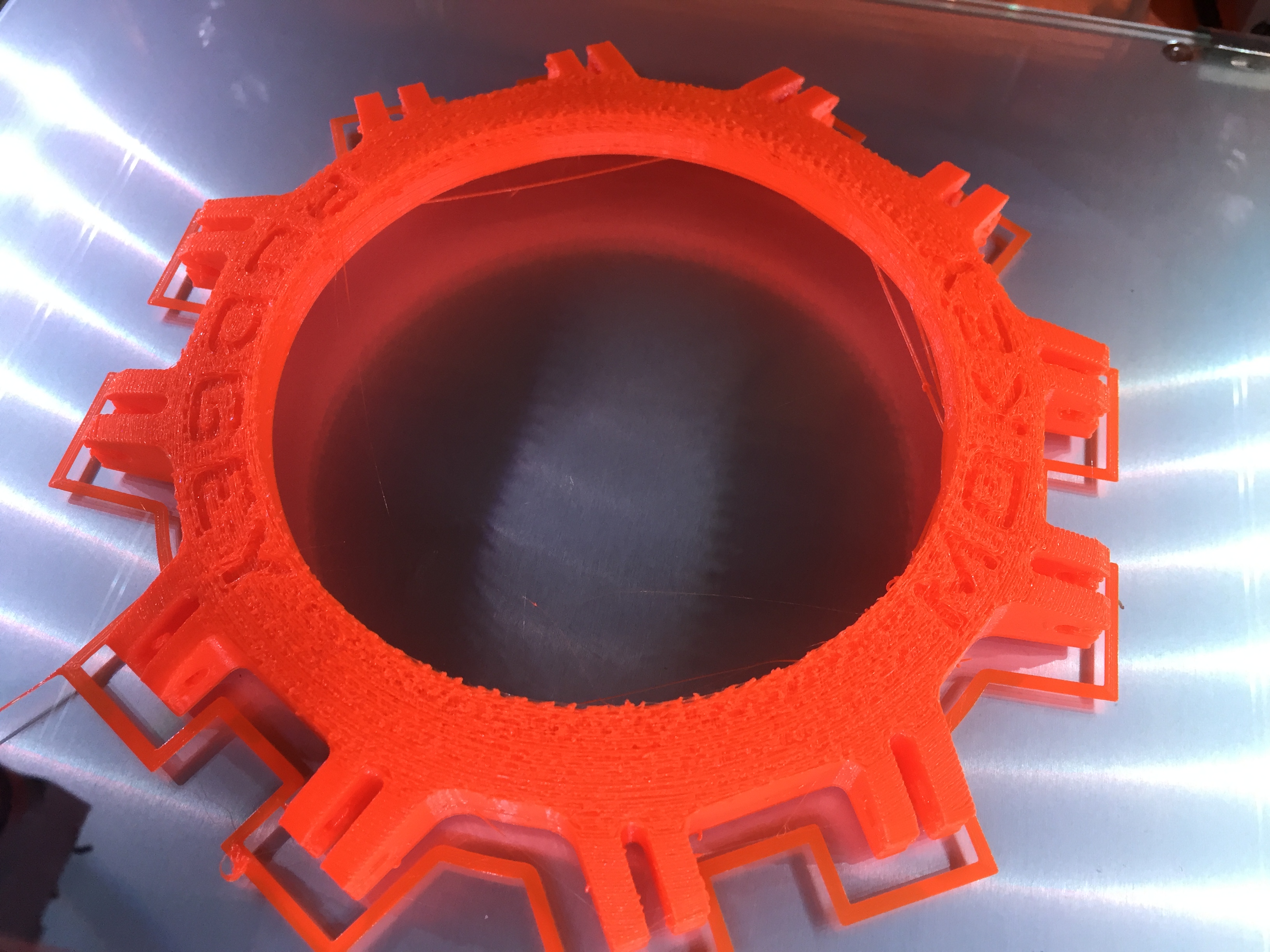

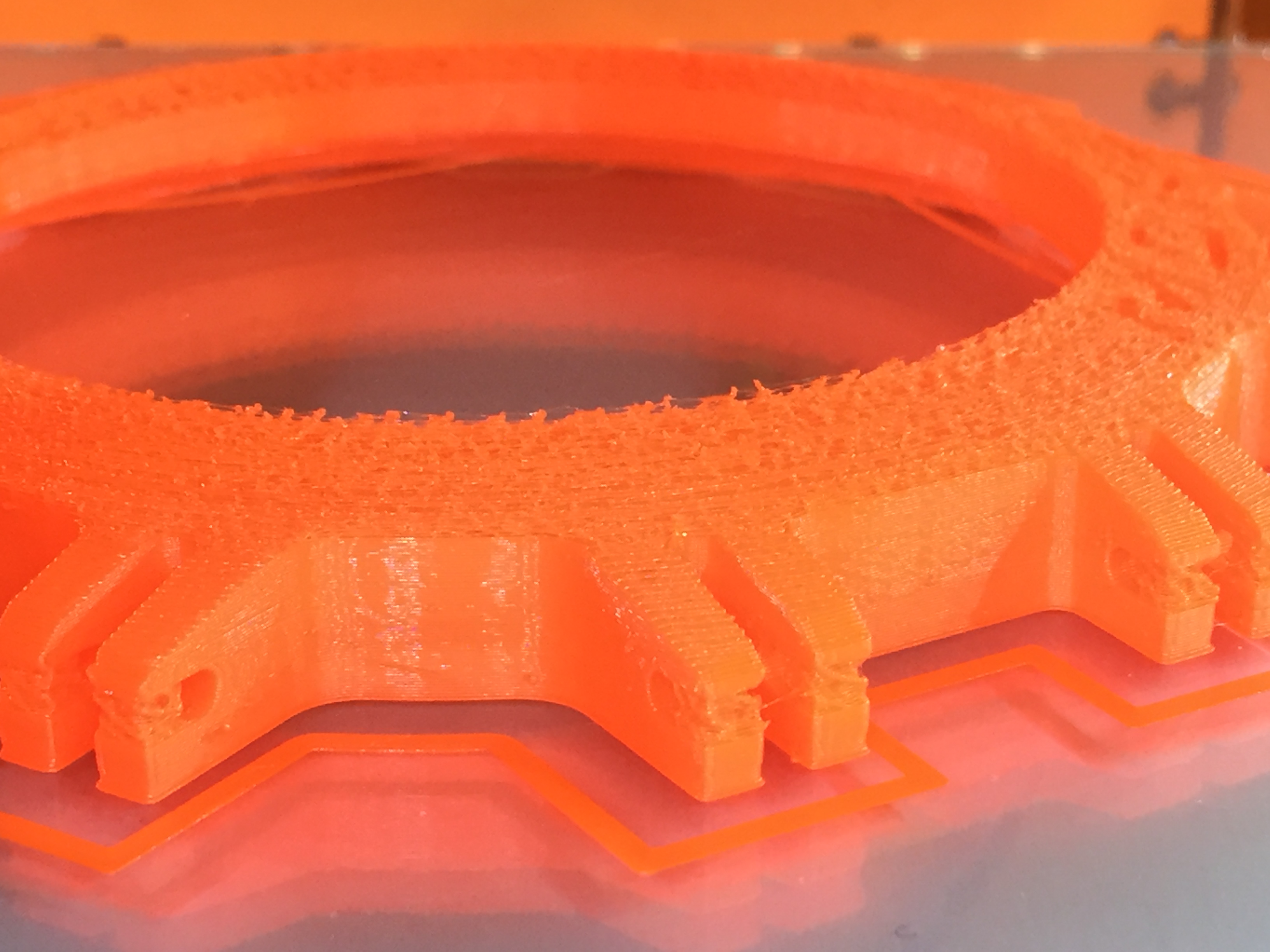

Ugly print follows....
So the question becomes...is the fans just too powerful, causing this underextrusion?
I would raise the temp by 5C intervals while printing a long tower to check if prints file. Like the ultiarjan temp tests (on youmagine search his user name)
