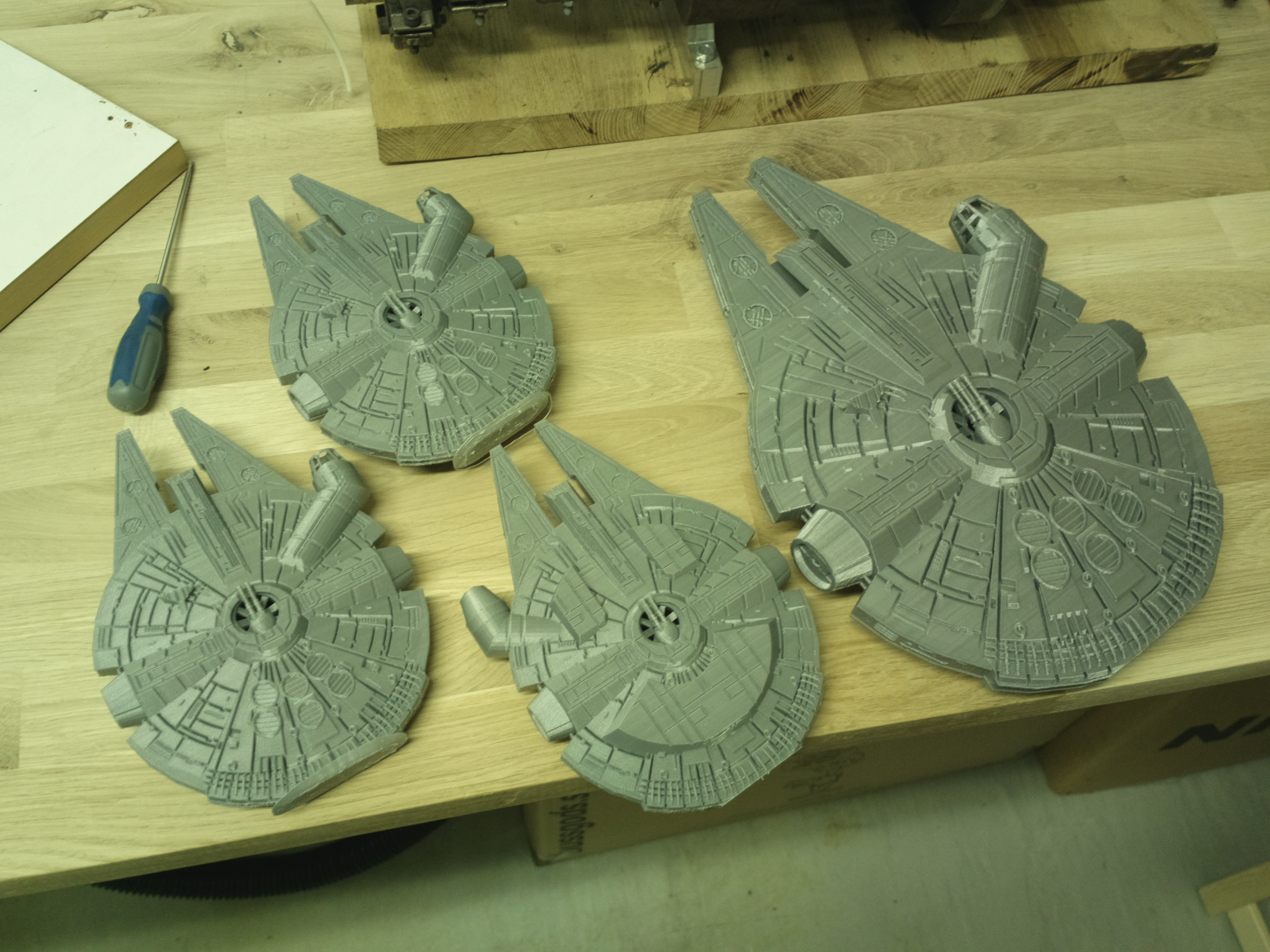

I have been printing nearly two spools of Ultimaker Silver PLA past weeks (combining nozzle testing with Christmas gift manufacturing
The first spool was an older one, probably a year old or so, and second spool was brand new.
Both of them printed well on my UM2E (with the original feeder, TFM-coupler and ruby nozzle). (Star Wars is popular now days
That said though, the blue Ultimaker PLA that came with my first UM2 is probably the most unreliable material I ever tried to print, and I have heard similar statements about the silver PLA. But I thought those issues should have been sorted by now, or is there any chance that you got an old spool?

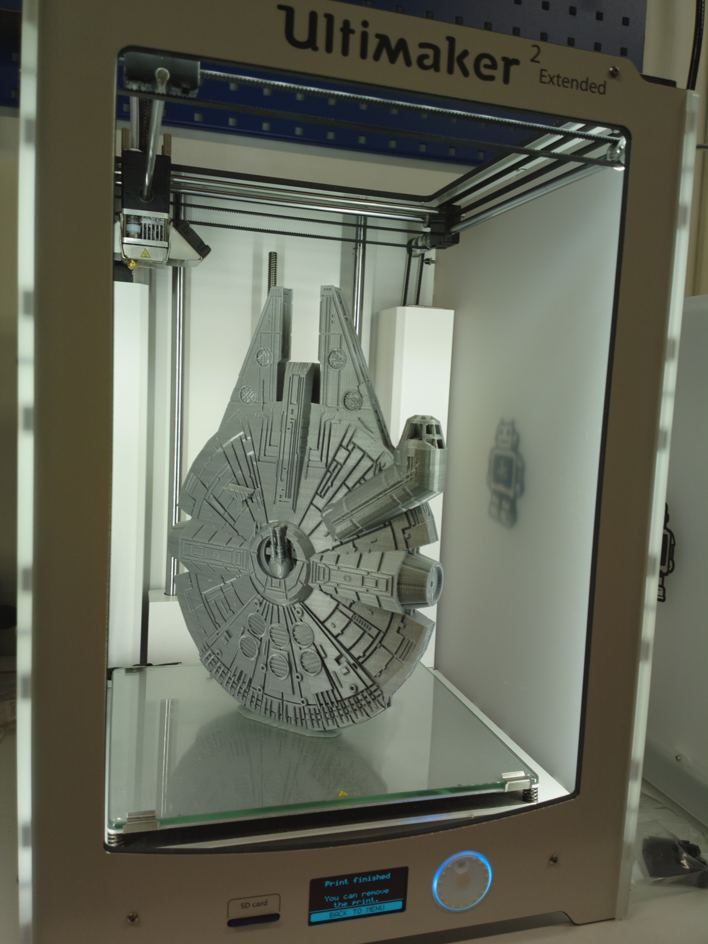

Hey Anders, how did your finger nails look after that UM2Ext print?
The contact surface is not very large compared to the height and size of that print...

Ha ha...that print did come out extremely nice

Am I the only one seeing slices in the model?
Re: Ultimaker Brand PLA
I do see a prominent line mid-way up the cockpit tube.Amedee wrote:Am I the only one seeing slices in the model?
But the rest looks good
