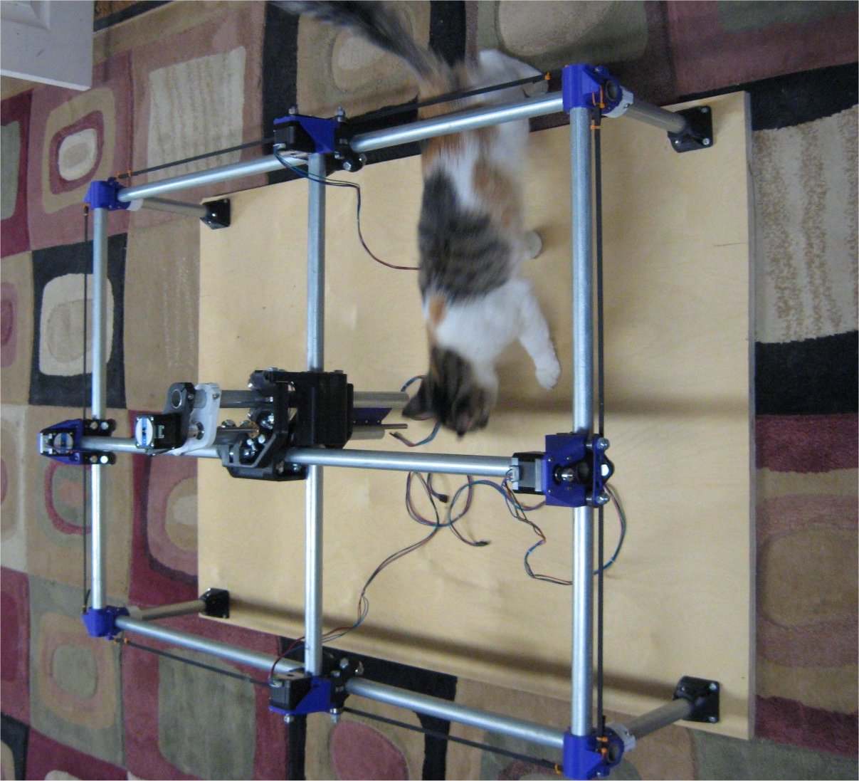

After assembling the MPCNC wanted to do one more final test before continuing forward.

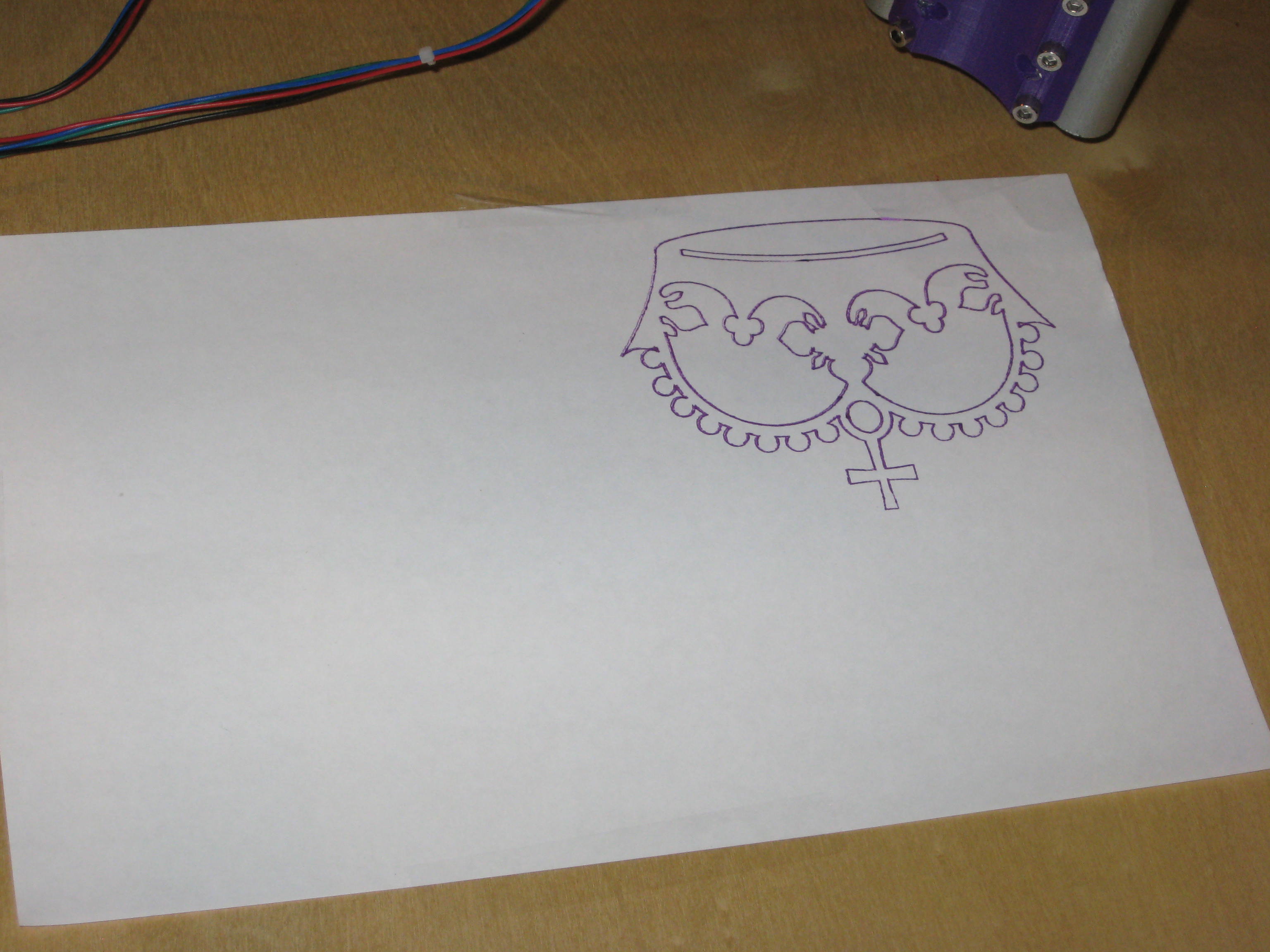

1st Test Sketch of a Crown, By George it works.
It is a little weak on the steppers V-Ref though for testing I will not worry about this until after I 3D Print a power supply case designed for it. Thinking about designing a case for the Controller and Ramps 1.6 on the back of the tool carriage, routing the cables via a series of cable chains, then will only have the power supply wires to route from the rear of the main floor to the controllers.
Will have to think about how to gain another stepper motor driver to run an extruder maybe this.
https://www.reprap.me/stepper-expander-x1.html

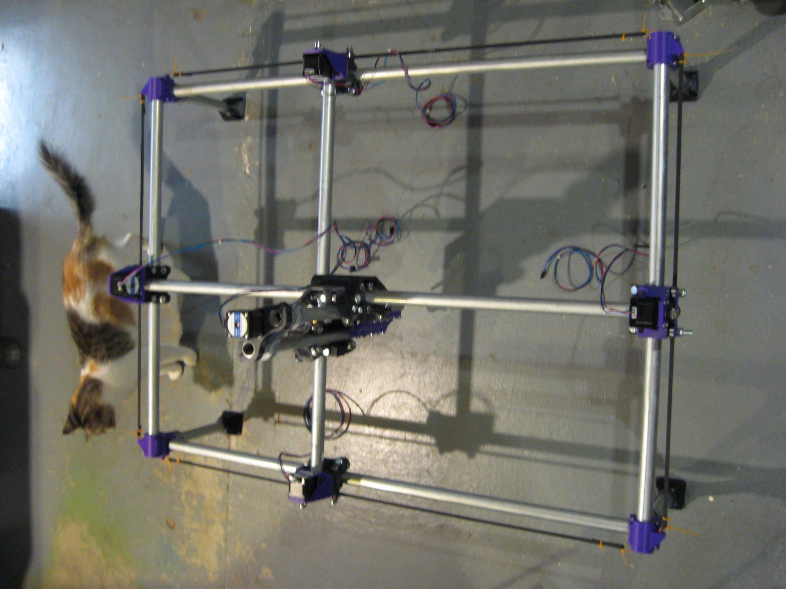

Today I decide to test test main floor platform for level.
With ~6mm above the bed then lowered the Tool plate 6mm on all four corners an dead center the platform.
Being really close to the main floor platform here, took my filler gauges out and began measuring the height.
After comparing all five locations, deturmined that the MPCNC that I just built is measuring 0.06mm from level.
Knew I was being careful making my EMT Conduit cuts, but never ever expected that I was being this precise.
This is going to be is enough to mount a Large Aluminum Plate above the floor Platform, heated or not heated.
For 3D Printing large 508 X 762 X 292mm Models WoW! this is going to take a long, long, long, time to print.
A simple Benchy 4X size will take1 day with .4mm nozzle with a 1mm nozzle prints will take 5 1/2 hours.
This may be doable.

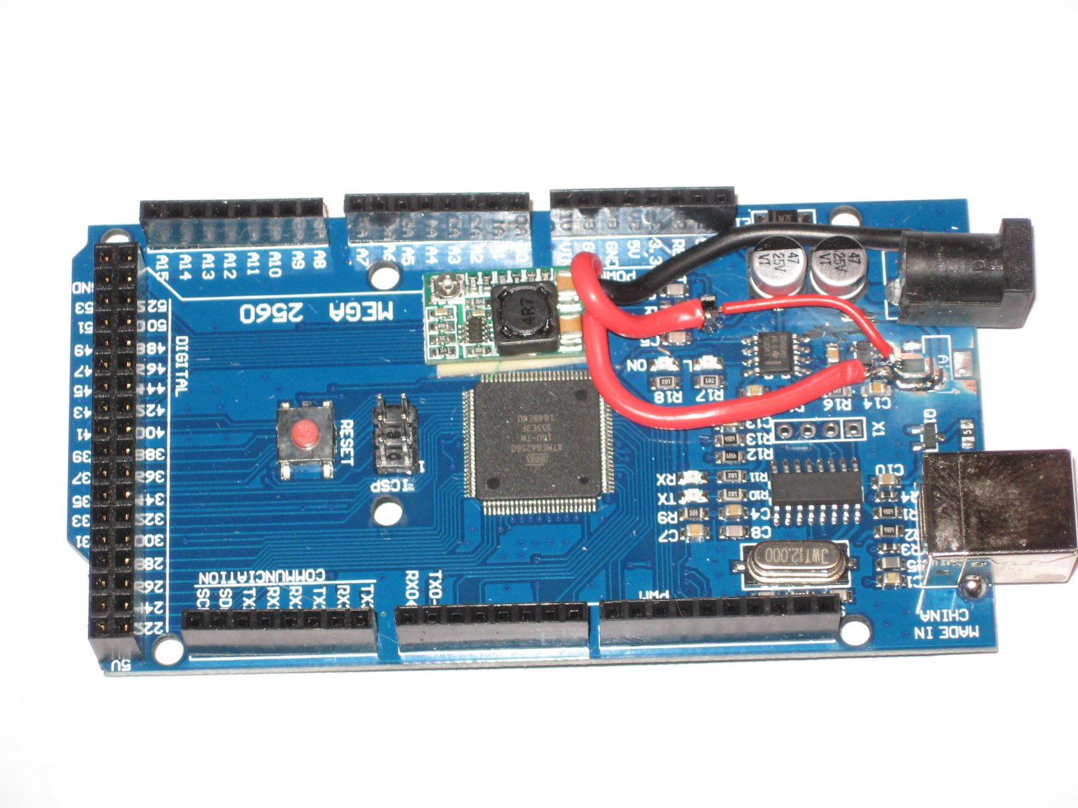

Today my DC-DC Step Down Buck Converter 1.5V 3V 5V 9V 12V and Adjustable at 3 amps came in.
I am now powering my ramps with a 20amp 24volt power supply.
I removed D1 replacing it with the output of the buck converter I soldered the diode anode side to IN (24vdc) and soldered the diode cathode side to VO leaving the GND terminal to be soldered to the Ramps ground Power Connector.
I did not install a DC-DC Step Down Buck Converter Module set to 5volts to replace the AMS1117-5.0 at this time
This was on my agenda so I could use the full graphics controller that draws to much current from AMS1117-5.0.
Will do this after the Full graphics controller arrives.

Today I duplicated my DC-DC Step Down Buck Converter to my Spare Ramps 1.6 board. I am now powering both ramps with 24volt power supplies.
Have not ordered a pair of Full Graphics controllers for my newly purchased Arduino Mega 2560 R3's and Ramps.
Though it is still on my list of parts to be ordered.
My next modification will be to remove the AMS1117-5.0 regulator on the Arduino and replace it with this same DC-DC Step Down Buck Converter. This time instead of setting it to a variable voltage will be using the set 5 volt jumper pin on the converter.
This will allow for the additional power requirements needed to operate the Full Graphics controller I will be using. All power supplied from a single 24vdc power source from the Ramps 1.6 controller power pins...

Today I believe I have the Estlcam figured out I printed a more complex sketch.
I went off the paper on the feet
After printing this sketch believe ready to setup a extra Stepper motor Driver for my Ramps 1.6 for the extruder.
Will be looking a this Stepper motor Expander
Has any one ever tried these Stepper motor expanders

Today I was wiring end-stop switches using this video on my Arduino Mega 2560 R3 an Ramps 1.6 making sure the wire were exactly the same as the video.
Well I blew the AMS1117-05 in a heartbeat so today I replace the AMS1117-05 with a DC-DC Step Down Buck Converter 1.5V 3V 5V 9V 12V 3A Adjustable Module this was set to the 5V jumper.
My question is why did this switch made by BigTree-Tech.com for maker bot kill the AMS1117-05, tested the switch it operated correctly. 2nd question is now that Arduino has a 3amp 5volt supply should be able to run a LCD 12864 Smart Controller correct.
I must be right at the max current limit for the regulator because when I power it on with the new regulator is now works correctly.
