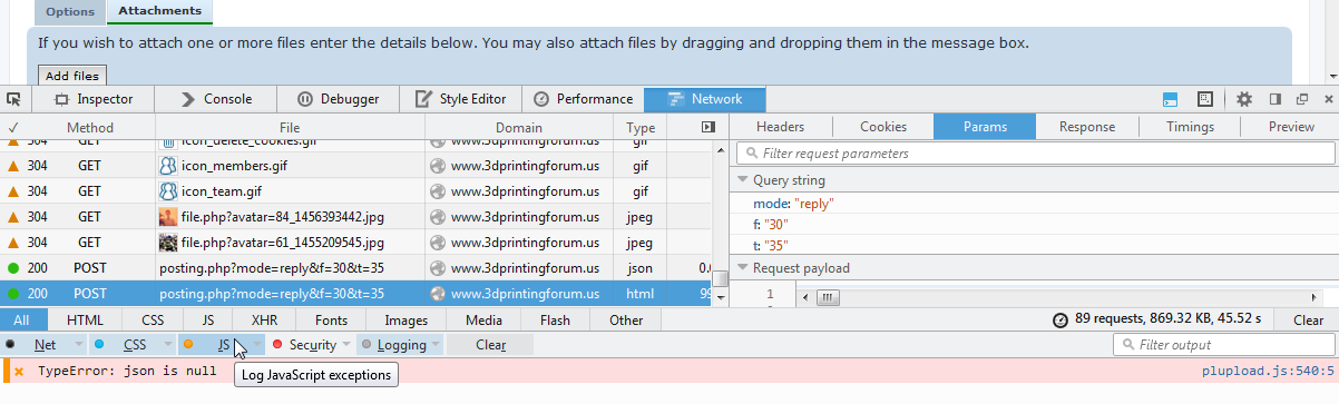

It looks like it is really file specific, I can reproduce with Anders' testcase while I can upload all my other files, even bigger ones...
So here is the story: The file is uploaded in chunks and the browser expects a JSON reply. But with Anders' file, the response to the second chunk is empty, and the javascript (in the browser) crashes with a TypeError.
So the problem occurs on the server side while processing the chunk. So either the client is not sending what the server expects or the server can't handle it properly. But I'm afraid there is some exception handling masking the error o the server side because the server returns a '200' which means success
@LePaul, aren't there any error reporting log files available?

No, the error comes much faster than that.
If we run into a limit it would rather be memory.
But then again phpBB or php would bark, here we just have nothing.
I haven't touched phpBB code since ages, but I am pretty sure there is debug option somewhere so that it is more verbose when bad things happens. It is normally turned of by default on production site as nobody wants to see php errors/warning on their board
