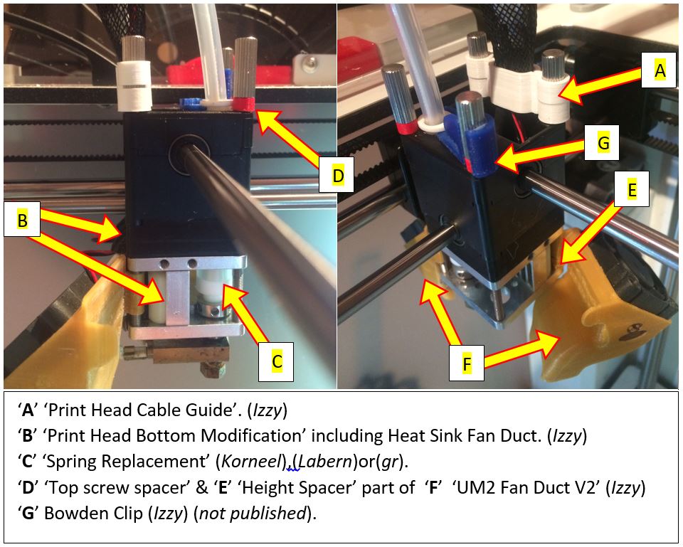

I have to say, this is my 4th set of fan ducts since I bought the printer and they seem to be doing fine.
Haven't tested them exhaustively (pun intended) but I doubt the fans can generate enough airflow either way for the different models of ducts to make a big difference. I liked these because they allow very easy access to the nozzle.
Re: Show off My latest Print
I've wondered that too...how much the direction of the airflow matters. I like the 45 degree fans on each side. Of course, if the print head was in the center of the print block, that would make things a little different
There is a slight cut out allowing for air to flow towards the very bottom of the nozzle, the idea being to cool the printed filament and not the heated nozzle, which would be pointless.
The UM2 fans don't cope with back pressure, they still function just don't produce much of a flow. Hence pointing one fan outlet at the other or directly at the printed surface to closely reduces their effectiveness.
I designed these ducts to improve the flow within the ducts and to reduce the back pressure, as well as increase the access to the nozzle and heating head. With the height adjustment you can adjust amount being directed at the nozzle, but please bear in mind the increased flow, you will need to adjust the fans percentage flow rate. (may the duck be with you), Izzy
By the way Blizz you can print the small spacers that go under the heads of the knurled nuts that then reduces the threads hanging out the bottom.
Ah that's what they're for
I printed 2, assuming they would go under where the fans clip on to keep them at a certain height. The description was so long and that was the only thing I could make of them. Not a bad idea!

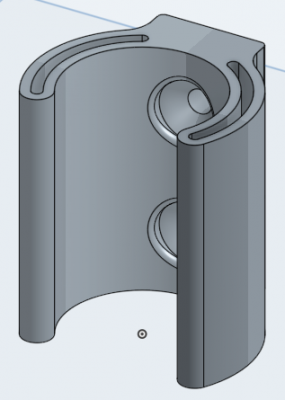

A clip to mount a plinth to IKEA "Capita" legs for our office, it is such a nice feeling when it just clips on with a snap during the first try
Printed in XT with 0.8mm nozzle, 0.25mm layers and 50mm/sec on a UM2+, will probably push it a little harder when printing the final version since we will need 25+ of them

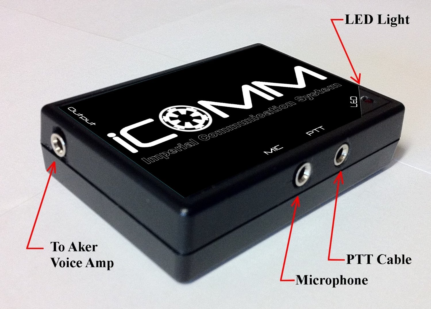

I need to take some measurements and ask for your design help, Meduza
As Stormtrooper we wear a speaker system around our neck which works well. But there is an accessory piece, a little electronic box, that makes the static cut off sounds the Stormtrooper intercoms make in the movie. If we could attach that (clip?) to the speaker piece, it would save trying to velcro, tape and make this little piece fit somewhere.

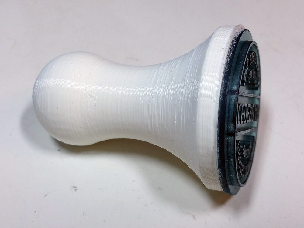

Todays print, a corporate seal for my business, since PayPal required a friend and customer of mine to submit a document with a unbiased test of the product he received on official letterhead paper signed and with a corporate seal stamped on it to process his refund request for some stuff (5000$ worth) he bought from china which did not work according to the specifications at all...
What is this bullshit that official papers need to be on pre-printed paper and be stamped btw... to me it feels like something you did 30 years ago or so, not in the digital age of 2016 :/
The handle is printed in some white crappy PLA really fast (15mm3/sec with 0.6mm nozzle, thin walls and 20% infill), and the stamp surface is printed in Formlabs tough resin on the Form1+

VoiceBooster by TK Products, LLC
Model: iComm
Color: Black
Dimensions: 3.12in x 2.25in x 0.75in
Weight (w/ Batteries): 2.3oz
Power Source: Built-in Lithium battery. Main power comes from VoiceBooster Amp

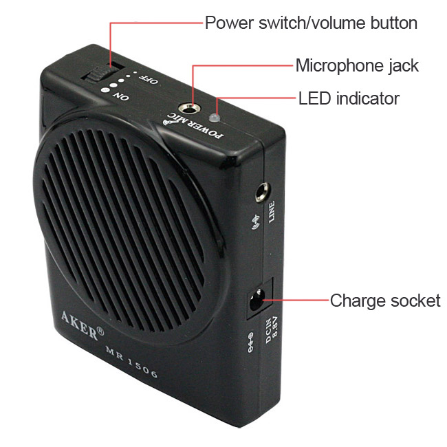

Model: VoiceBooster MR1506 (aker)
Color: Black
Peak Power output: 10 Watts
Dimensions: 3.75in x 2.81in x 1.08in (90mm x 70mm x 27mm)
Model: iComm
Color: Black
Color: Black
My "thought" was some way the ICOMM could clip into the side of the speaker (the side with no jacks, facing speaker, left side)
That belt clip is molded into the speaker...could be useful as an attachment for whatever clip piece can be made?
It's had me stumped for a few weeks...let's see what fresh eyes come up with
