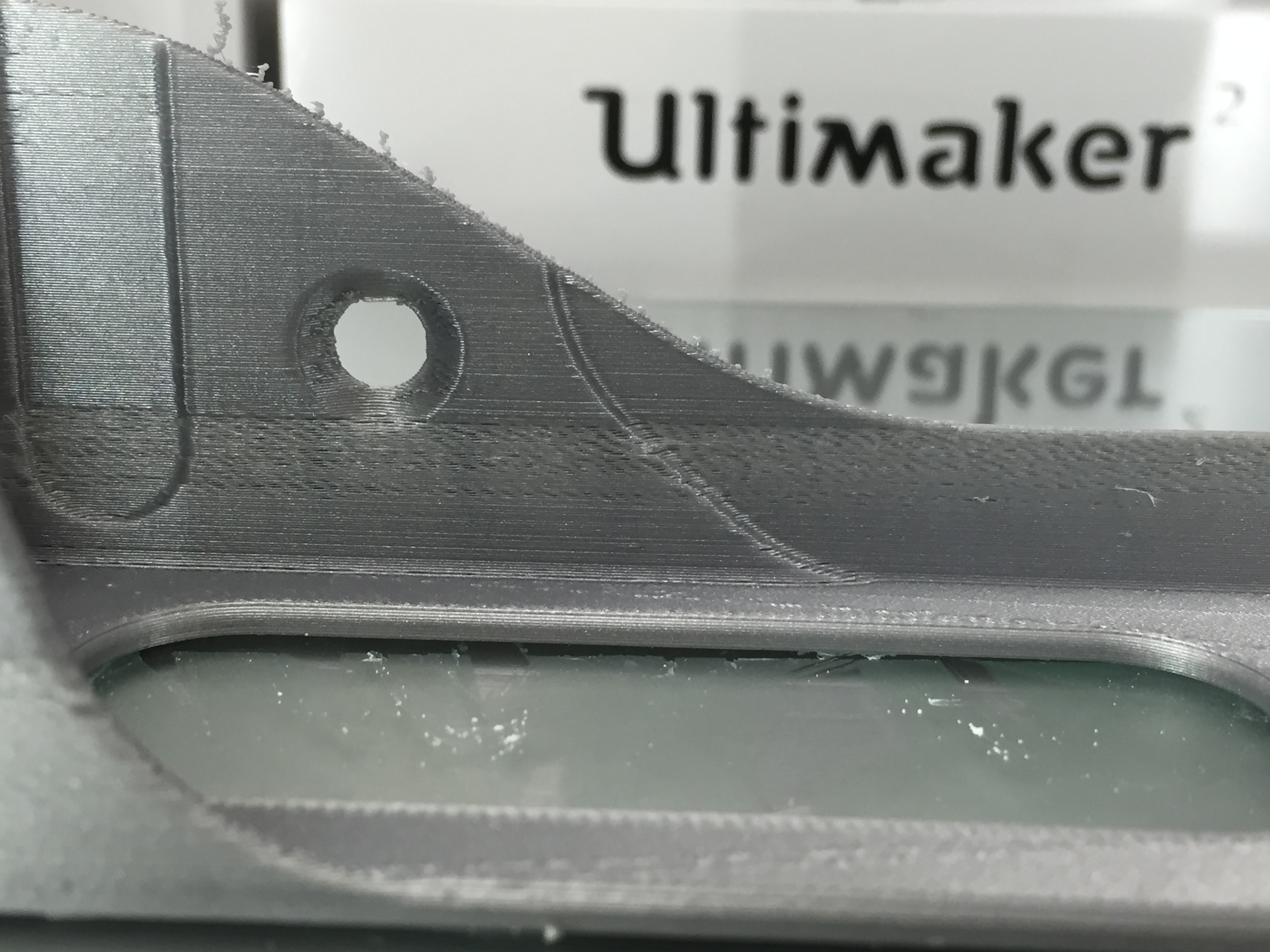

I notice Normal is now 0.1 and I had not noticed that on a small part I made on my UMO yesterday (an iPhone 6 tripod adapter). I couldn't sort out why a 30 minute print took an hour...but it looks soooo good
