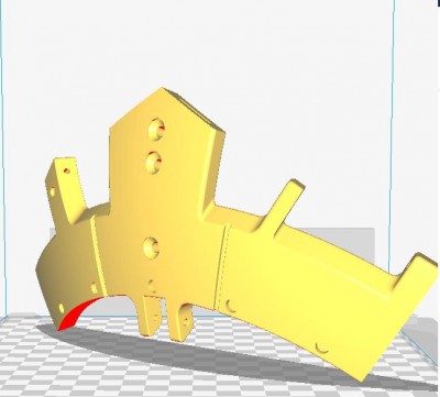

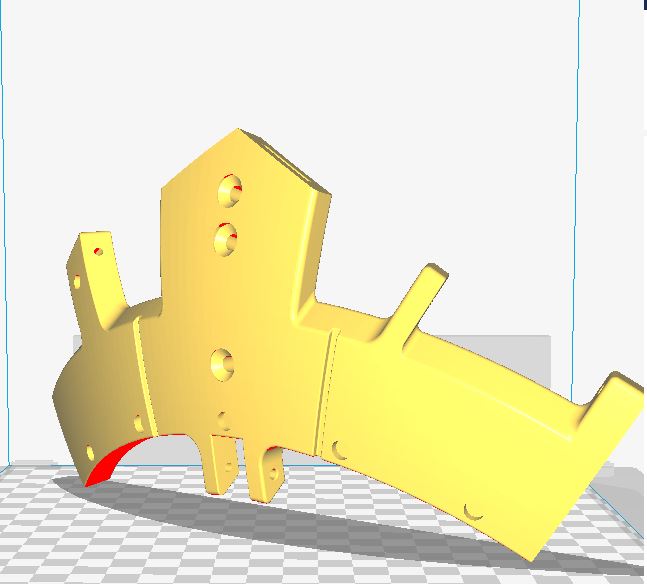

Here's the model I am trying to print in Cura, so you can see the bottom-center area that is failing lately
