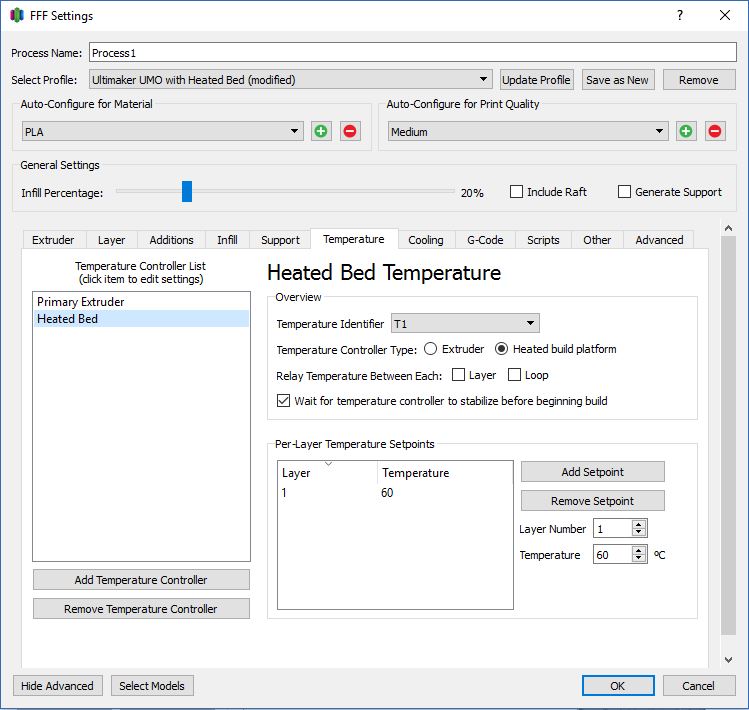

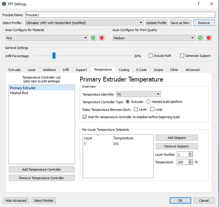

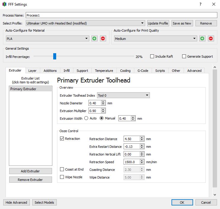

So I am struggling with the basics (still) of how to make a good profile for the Ultimaker Original with Heated Bed.
Add to that, the custom fan shroud...where 14% fan is pretty much the equivalent of 100% from the old stock fan
Extruder setting...I think this is fine? Let's start here.
Now the temperatures for the nozzle and bed

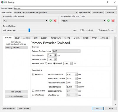

First think to change. Set extrusion ratio to 1.00 not 0.90
Ofc then you need to go advanced and change the 3.00mm diameter of the filament to the real size of your filament (2.85mm or what the caliper says)
Also change nozzle size from automatic to 0.40
On the Layer tap change first layer height and extrusion to 120 or 140. That will make a good sticky first layer (depends on your print speed/calibration)
Also remove extra retraction distance. That setting needs custom adjustments in conjunction with coast/wipe. And that highly depends on how much/less drip you have.

You can also set retraction speed to 35*60=2100 I think. At least my UMO can manage it.
