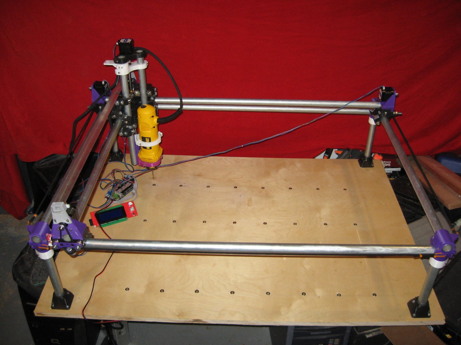

I have found some Anwenk 1/4"-20 x 15mm Furniture Screw in Nut Threaded Wood Inserts and have install an placed 32 of the them in the CNC main Deck. This can be used to attach a removable Hot-Bed quickly.
Now I can fasten anything with a simple clamp that is 3D Printed or CNC milled using many type of material. First I still want to Find a Controller Case.

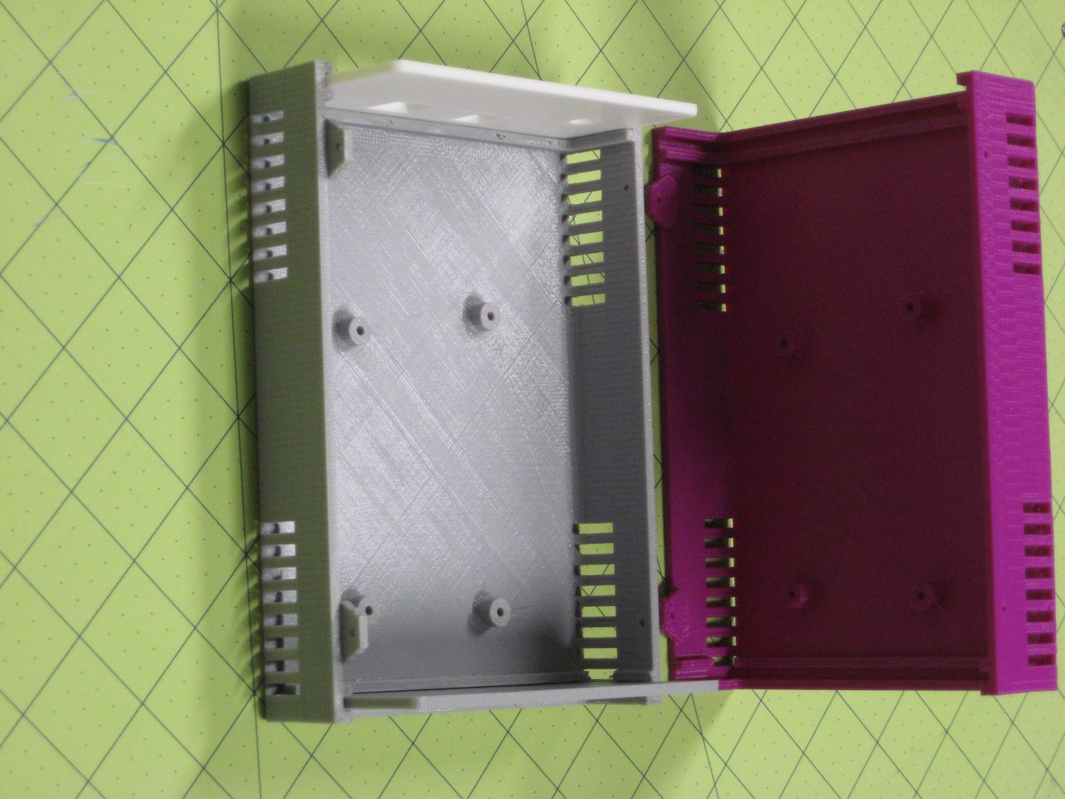

I liked this case so well that I am posting the link here so everyone can see.
This slick little case could be modified for any project.
http://www.thingiverse.com/thing:3160772

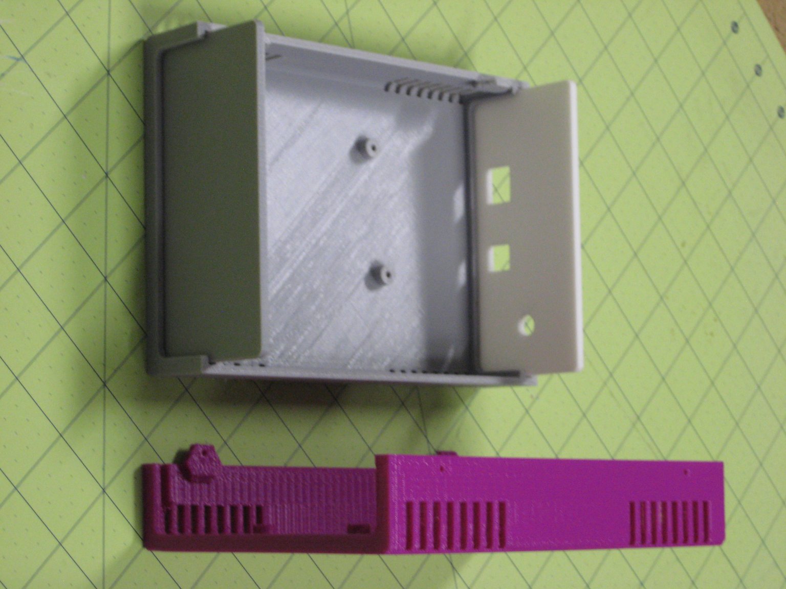

Made the Front plate without logo
