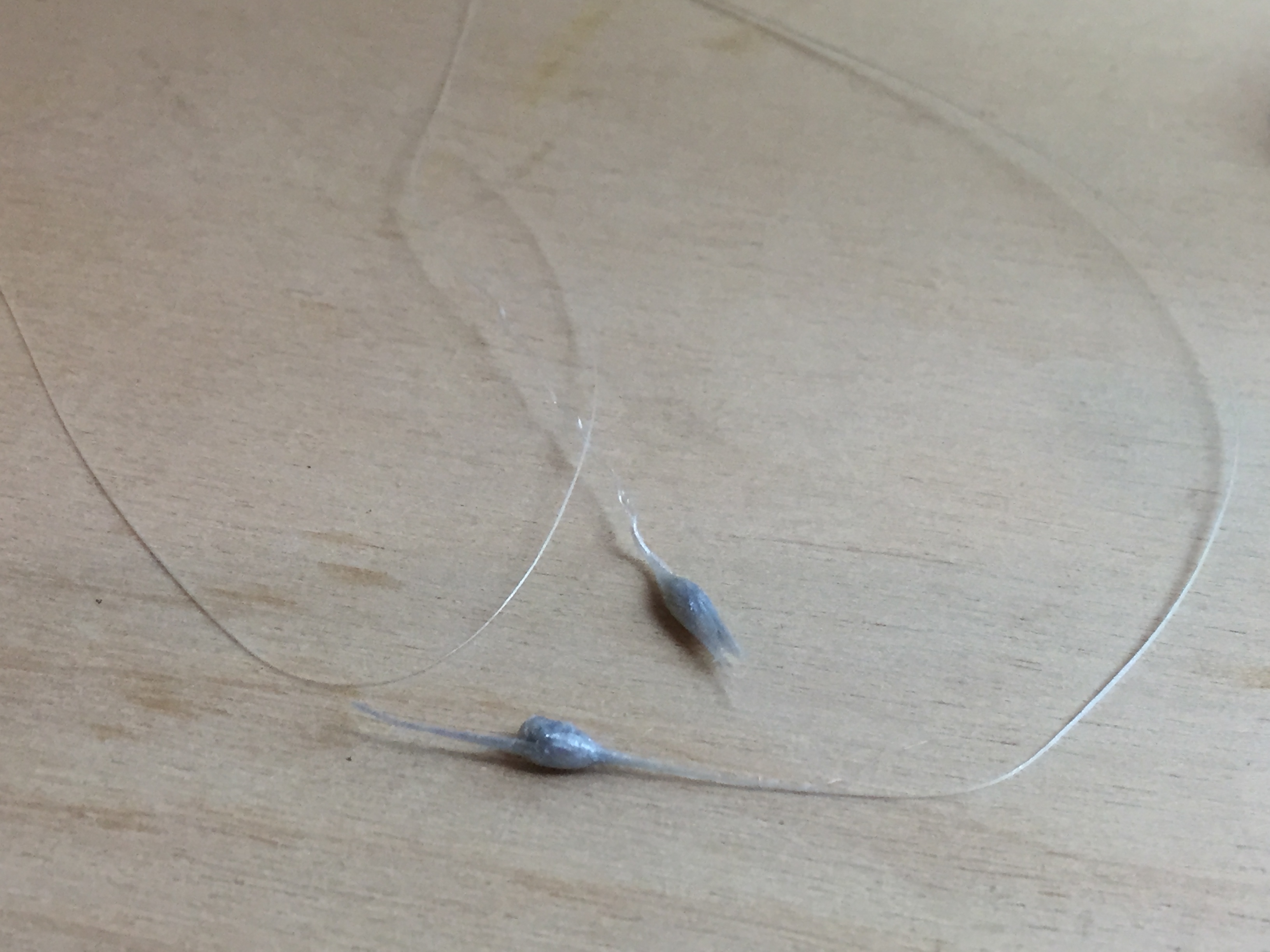

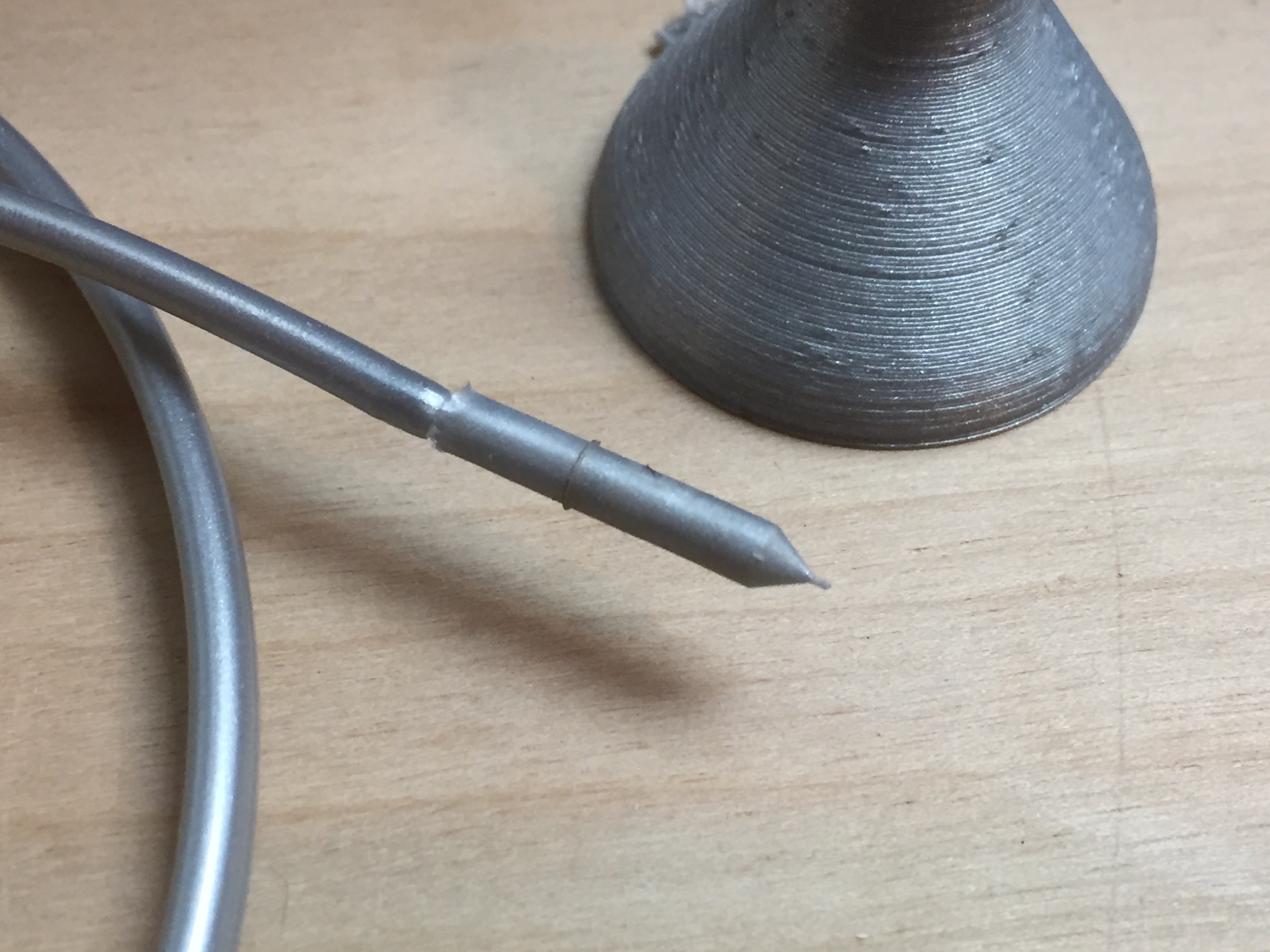

Well the Remove Material option is very prone to leaving pieces in the Bowden tube. Noticed this in the middle of the tube
But my Atomic came out very very clean

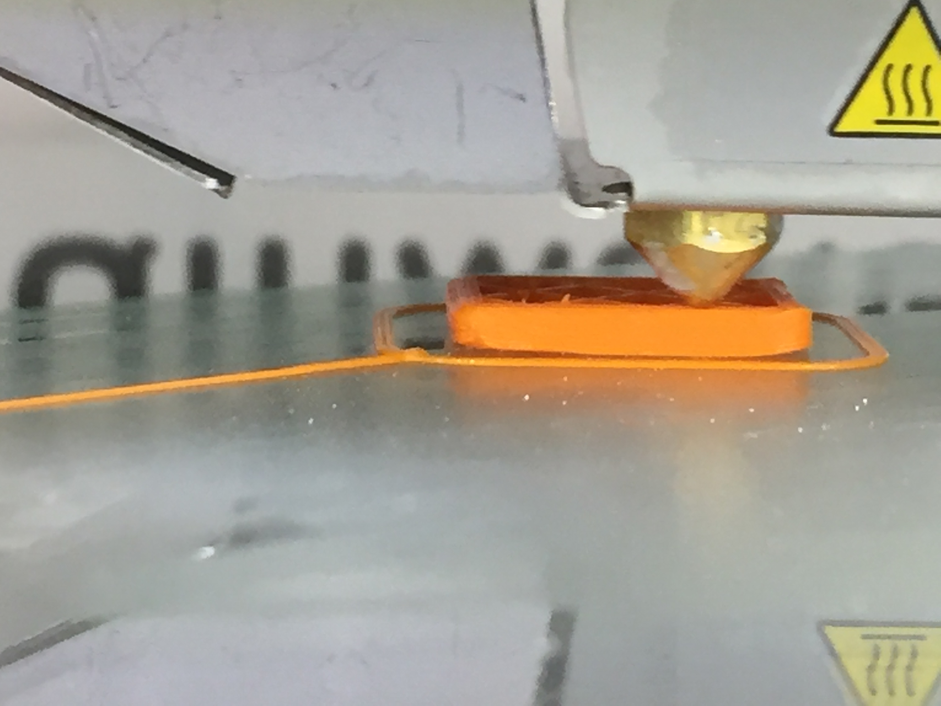

Doing a test robot now. New spool of Ultimaker Orange filament

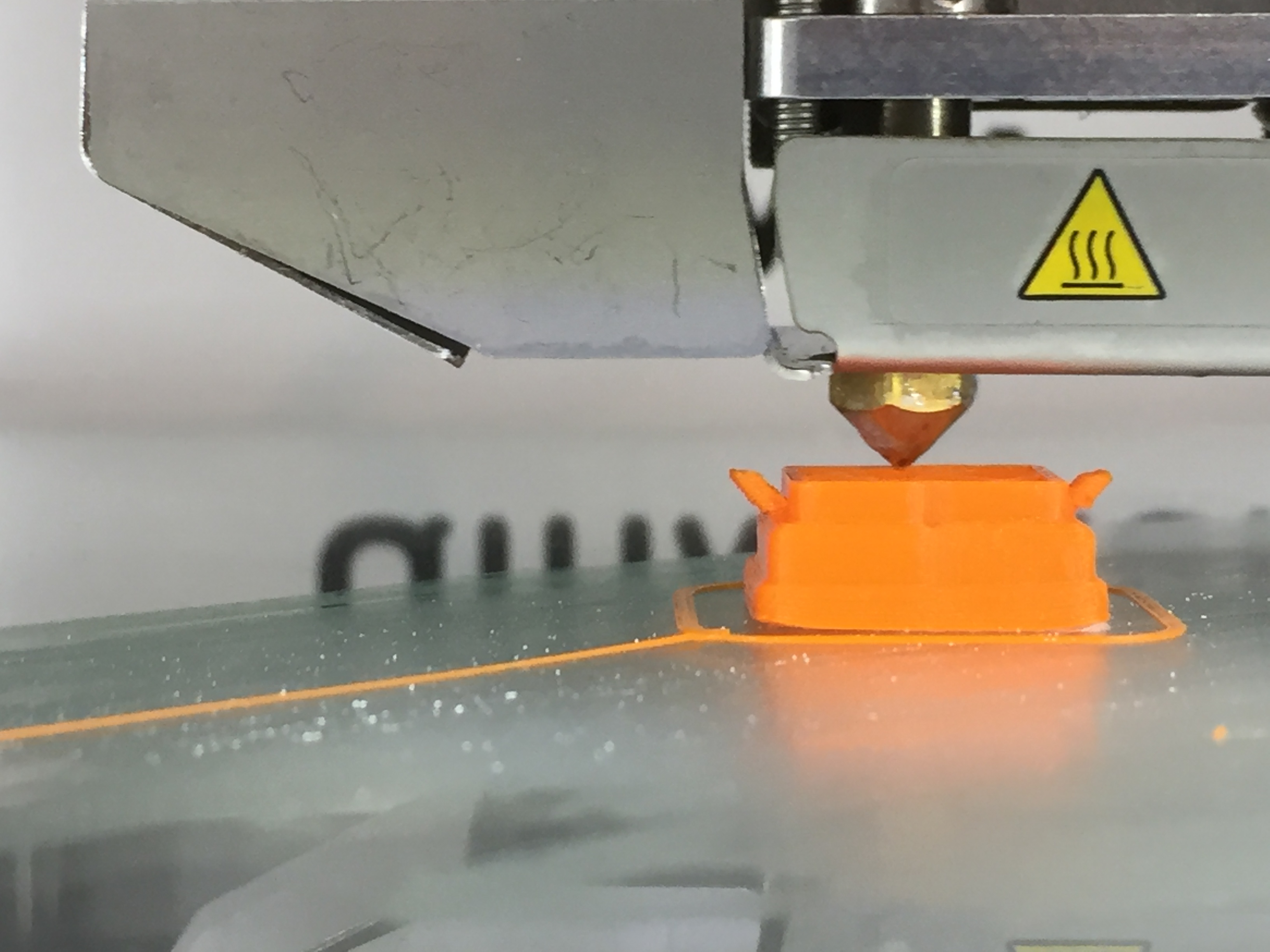

First layer lifting.
64C and glue stick
This time I tried at 69C
I aborted the previous print to see if the print heads would extrude a lot of material at the beginning. As other instances, it took a long time to ooze out 2-3 inches then started the print (where I'd usually see triple that)
Still wondering why prints are lifting. Started with clean glass (Windex).

For PLA this is really strange - especially with such small objects like the robot. I always use 60°C for PLA - often without glue, sometimes with glue - but don't see such warping. But I also haven't used Ultimaker PLA in a long time. Have you checked the bed to nozzle distance recently? I had bad bed adhesion in the past when I didn't level the bed after a nozzle change.
