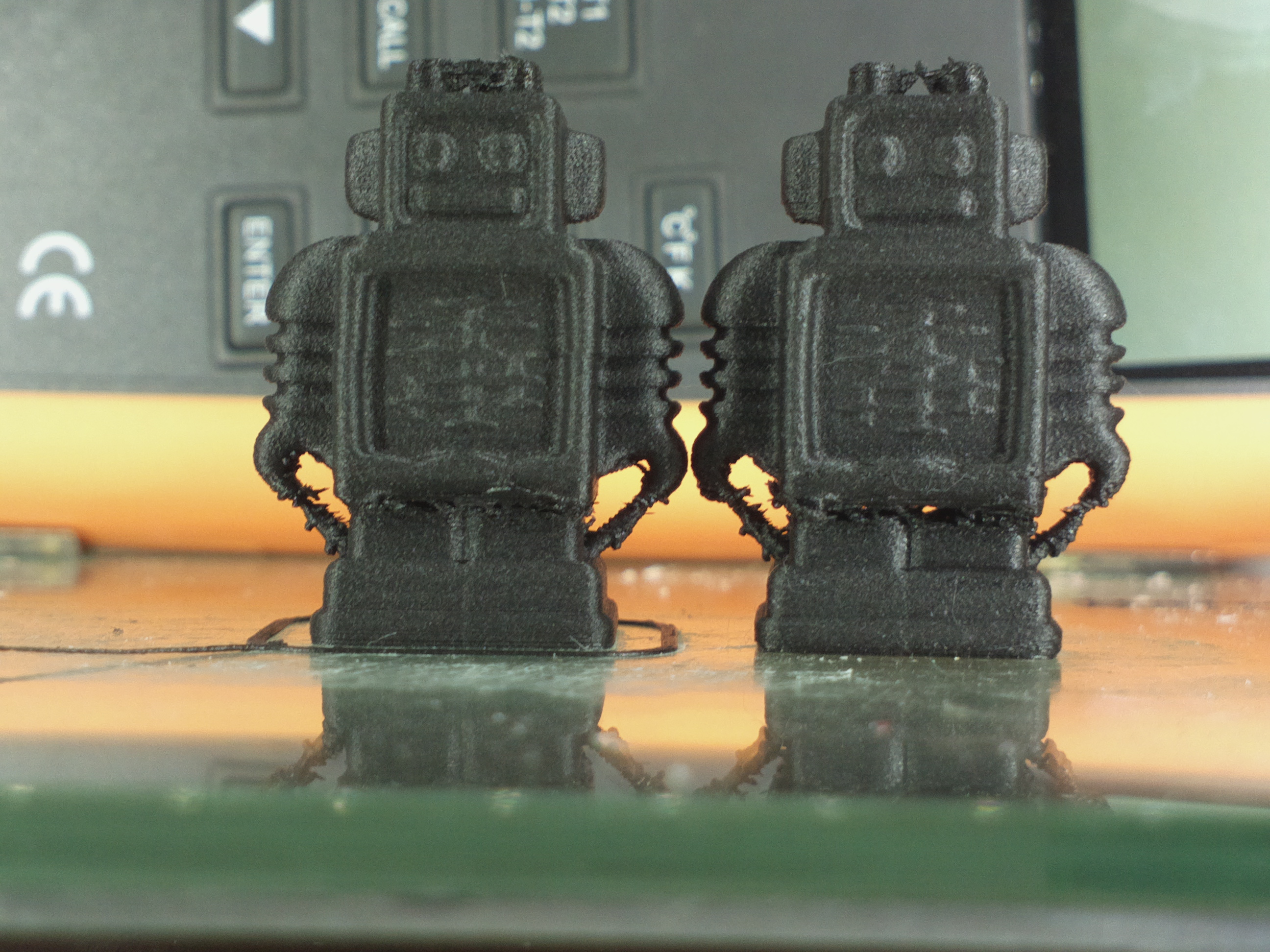

I have been printing some rather old XT-CF20 with different ruby nozzles and a hardened E3D-nozzle just to test the differences.
The UM2Go works well with the heated bed but I ended up with some rather strange feeding issues after short retractions.
(Left is Ruby, right is E3D hardened)
At first I thought it was because of the filament, but when feeding and retracting manually it works perfectly fine, no signs of extra friction.
So I am suspecting the bowden tube, it was beaten up quite badly when my printer was on loan and they did not put the print head in the correct position when packing the printer into the transportation box.
On the right model, what's going on between the leg/body? Is that where your retracting went badly?
Yes, the same under extrusion issue is present on both of them, but not very consistent. It always showed up at the supports for the robot hands, but sometime it was really bad and sometimes almost not visible even though I did not change anything in between the prints.
The problem appears only on retractions with very little printing in between and only shows up after several layers with those retractions (?)
I suspect something bowden-related since the bowden tube had lots of friction and has a very sharp bend on the UM2Go, combined with the rather weak UM2 feeder.

Hey AndersAnders Olsson wrote:Yes, the same under extrusion issue is present on both of them, but not very consistent. It always showed up at the supports for the robot hands, but sometime it was really bad and sometimes almost not visible even though I did not change anything in between the prints.
Not sure if this relates, but, on my UMO I have had the same thing, when heat creeps (higher temperatures) up after a few layers and on heavy retractions, the filament gets soft(isch) also a bit higher up and squeezes itself between every small crack / gap you might have. Somewhere in between the hot zone and the bowden. Might be your problem as well? This does not happen if the bowden is tight (but not 2 tight) and the channel from the teflon downwards is really in good condition. So... also reducing retraction distance helps (temp fix).
Yeah, I have been suspecting the teflon spacer, even though the TFM is supposed to last very long.
I might take it apart tomorrow and replace it just to make sure everything is ok.

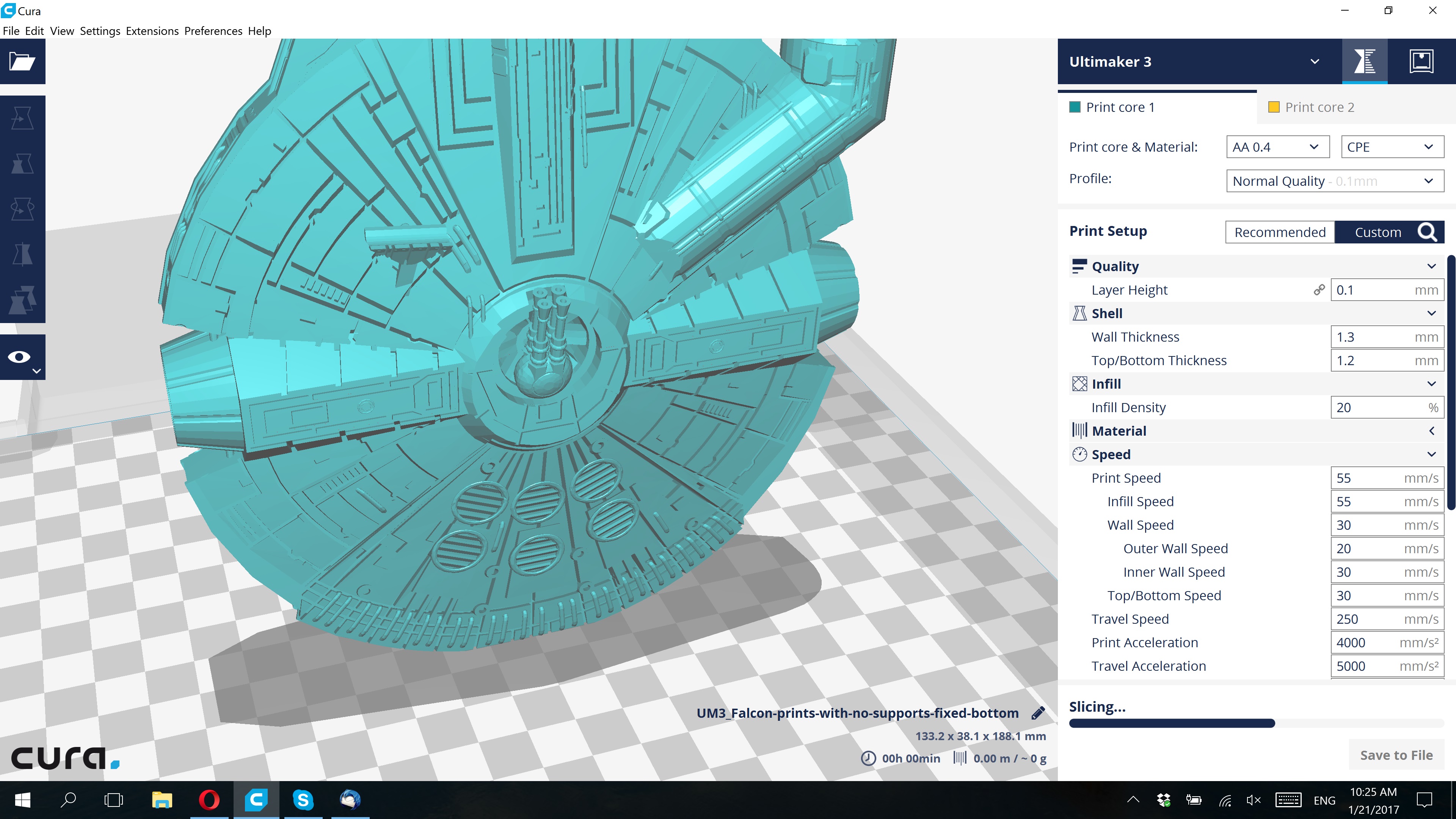

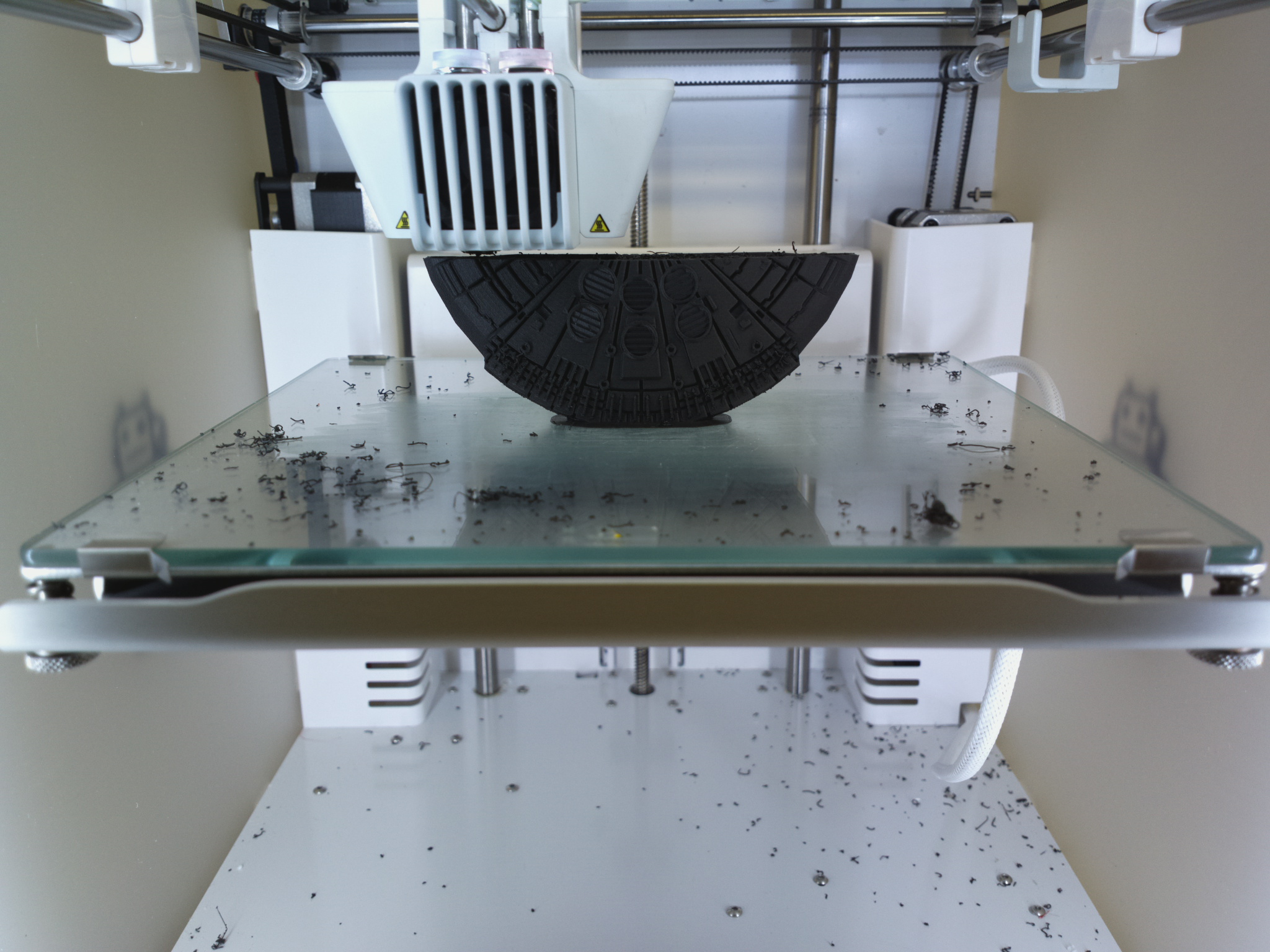

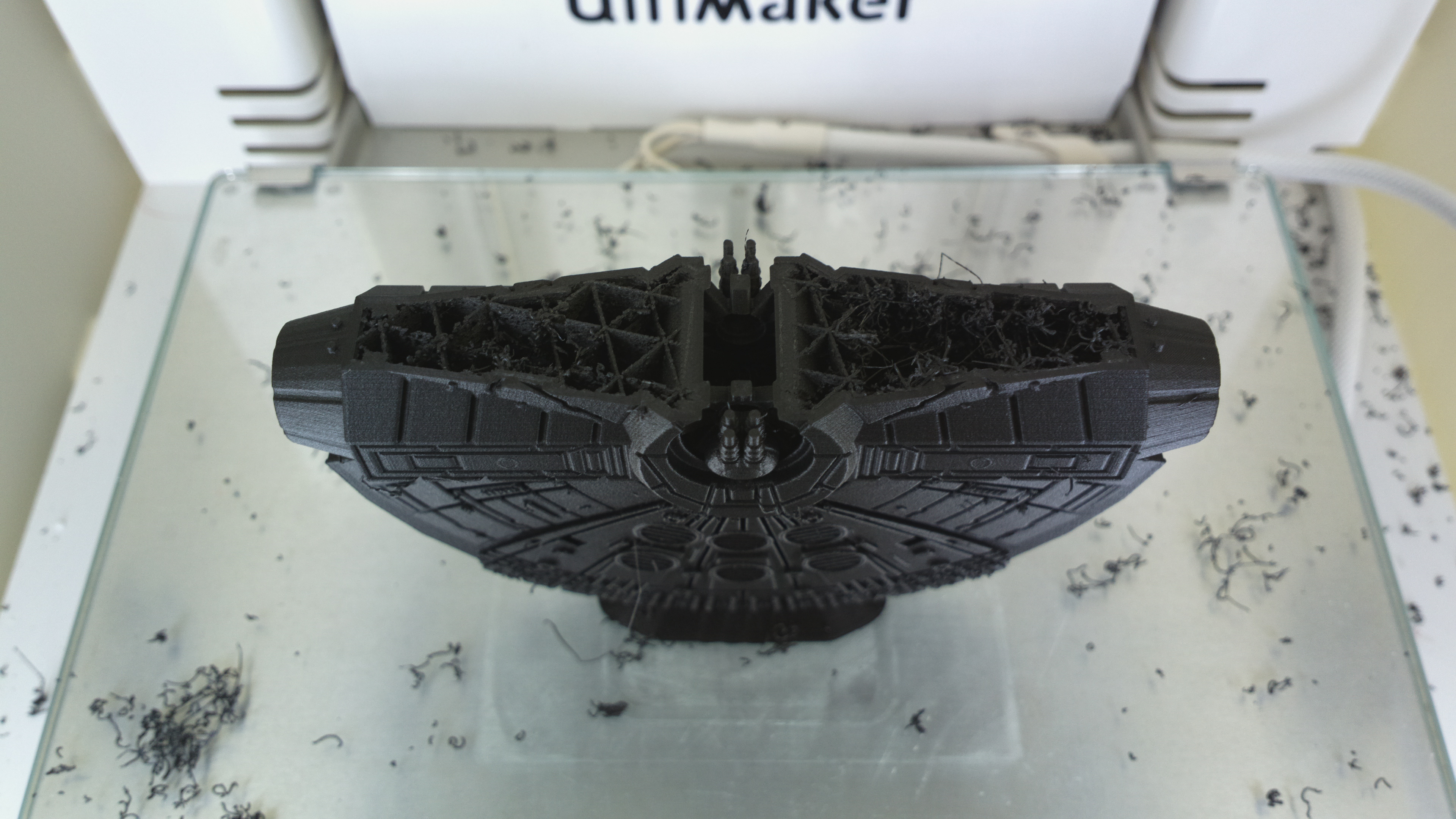

The strange thing is that the same spool of XT-CF20 printed fine on the UM3 using the same hardened nozzle, even all those small features came out nicely: (Yes, the varying speed in new Cura creates a mess with materials like this, the infill just destroys itself)Neotko wrote:IMO on my way too many ours looking at the printer, that happens when the retraction distance is too big for small details, making irregularities on the real material extruded. That along many more stuff is why it took me so long to master very small text prints. Also forget about um2 knurled bolt, is just not up to the task of precision filament movements. Get a bondtech or at least an mk7/mk8. When doing small areas the inly way to really control the filament is by heavy retractions. And even so unless you have a DDrive 2.85mm is worse on that area vs 1.75 (less material vs gravity + less temperature needed = less drip + better control of each extrusion).
So either the feeder is just on the limit on the UM2Go, or something part of the bowden/hotend is not perfectly healthy.
I thought my UM2Go was fully upgraded with dual hotends and heated bed by the way, but maybe it requires another feeder before it is fully equipped
UM3 is a world apart. The only way to test it vs is removing the acceleration/yerk control implemented on Cura that UM uses to compensate for a heavier and less stable head. For example the ringing with the same gcode on a umo+2 vs the um3 is just brutal, the um3 without the accel/yerk tricks creates waves that you can actually fell by hand. Ofc that's why they use this tricks. And to compensate for the really really slow speed, they push fast speeds on infill and less visible areas. Overall, not good for precision but works since you get a visible ok print.
Wow, why all that debris on the build plate?

Just as Neotko says, Ultimaker did all sorts of tricks to compensate for the more heavy print head on the UM3.LePaul wrote:Wow, why all that debris on the build plate?
Without these tricks the UM3 would have been much slower than the UM2, or would have given worse printing quality at the same speed.
One way they did this is to print the walls slower and the infill faster than before.
This looks rather sophisticated when watching the printer and mostly works as intended, meaning that you get really good quality with the UM3 while it is not much slower than the UM2 using default settings. However, since it is a bowden machine, there is some delay in the feeding when suddenly changing speed, which produces underextrusion in the first part of the infill.
For "normal" filaments, this is generally acceptable and does not cause any quality issues on the finished object.
Materials like XT-CF20 though (which you should not print on a stock the UM3 since it eats nozzles), does not like high speeds or sudden speed changes.
When I printed the Millenium Falcon with default settings (except the temperature increased to 250C) the result was that then infill tended to destroy itself: It would be nice with a "constant speed" setting in Cura for these materials, since it is first of all not obvious that new Cura does this on all printers, and second of all a bit inconvenient to show and adjust all those settings.
