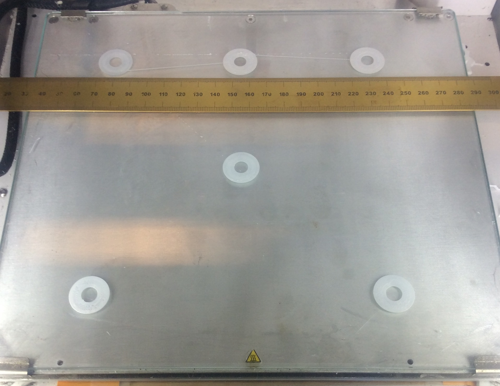

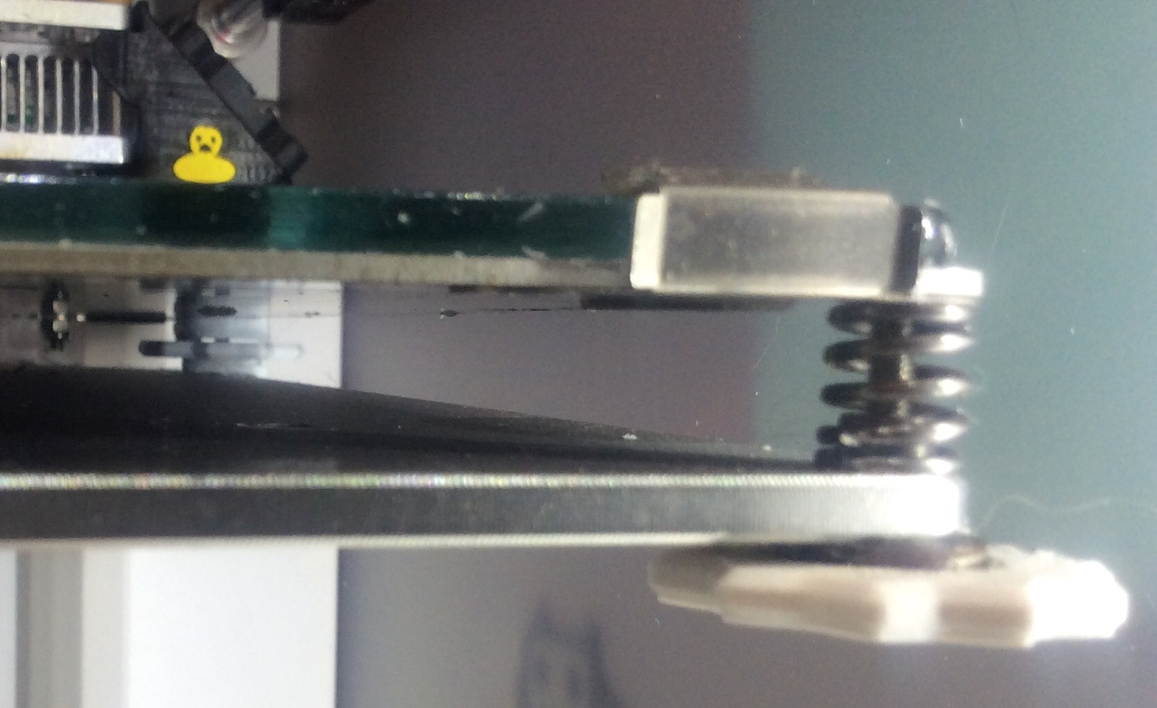

My print plate isn't fully level.
It's level to the 3 bed levelling points, but across the rear there is a slight slope from high on the left to low on the right. It's only 0.2mm difference across 100mm but enough to bug me.
So, at the moment to test the 'y' axis motor and doing short prints for a little while, I'm going to design, print and try out a couple of little 'bottle jacks' one each side of the plate at the back to just try and level it a little, I'll let you know how it goes, oh I've got some PTFE sheet to insulate against the underside of the heated build platform for the top of the little bottle jacks so not going to short it or anything.

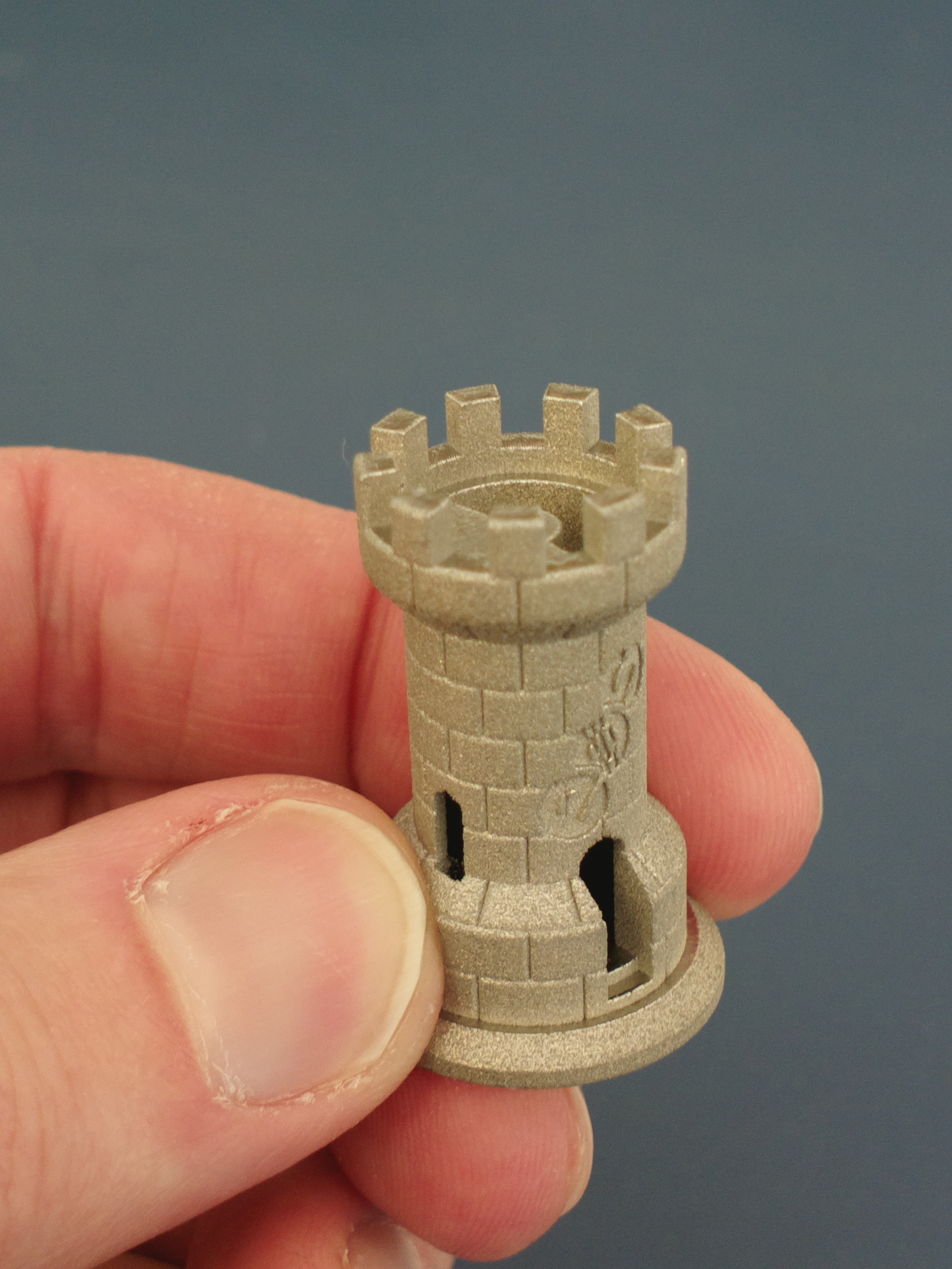

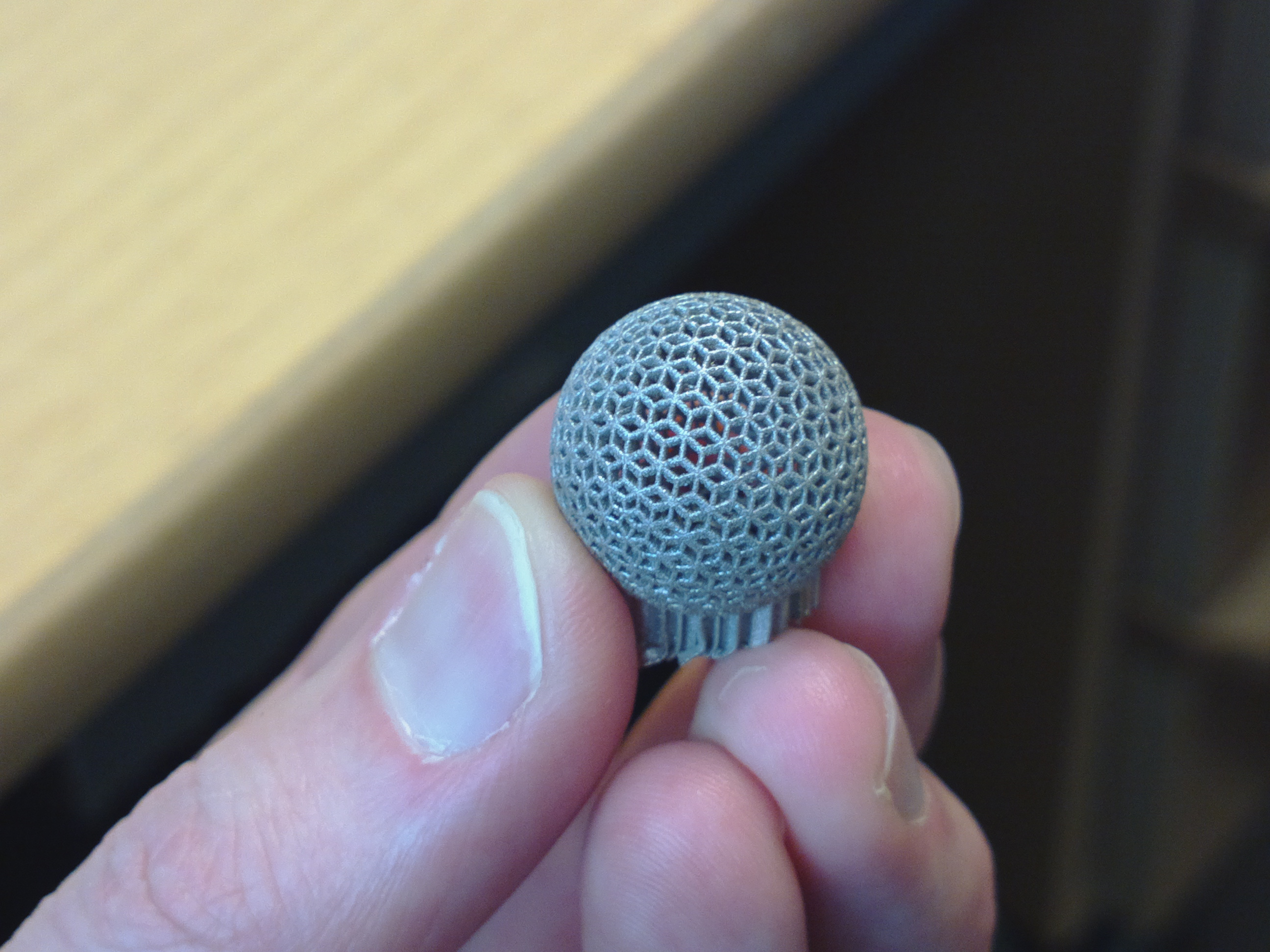

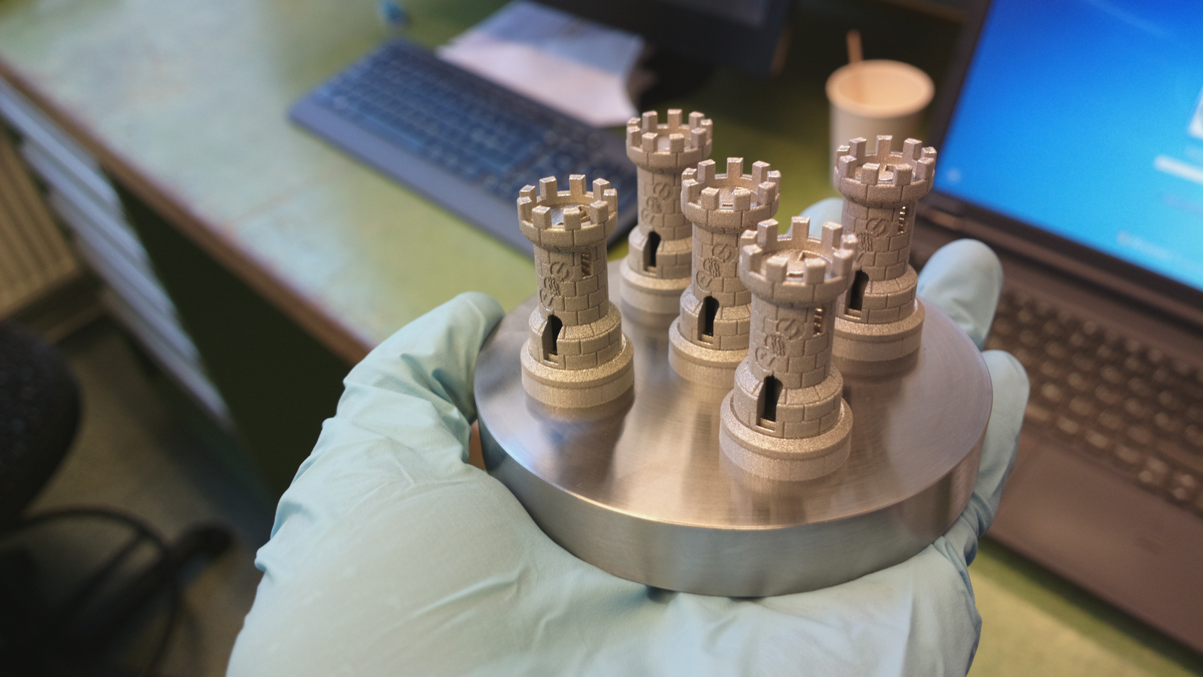

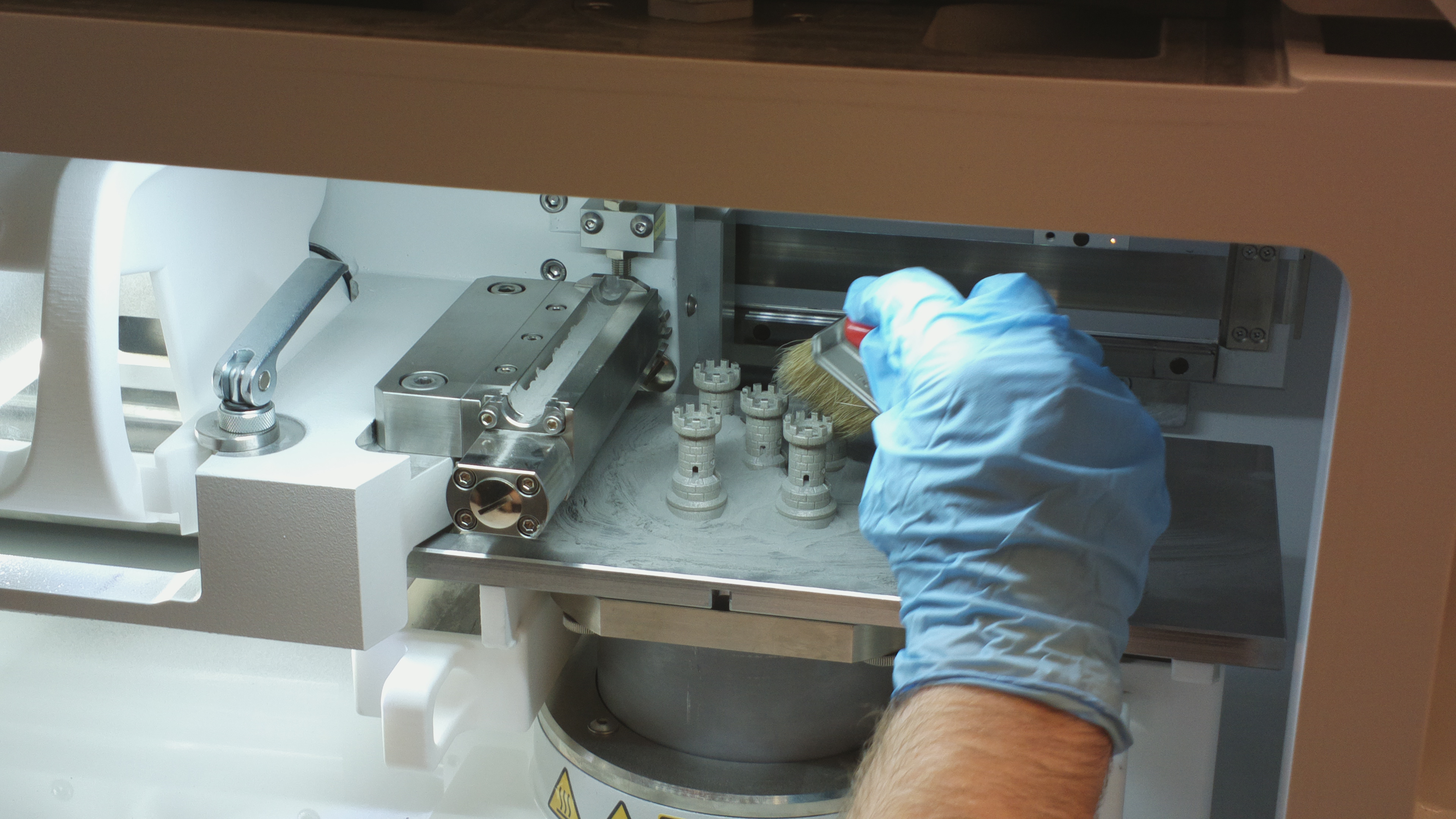

Finished the EOS training today bye the way, here are a few photos (since you asked
Everything was printed in Stainless Steel 316L (the variations in the color of the parts is caused by my camera)
The parts should normally be sandblasted after printing to remove loose particles on the surface, this has not been done on the parts in the pictures though. I am considering to start a separate thread about the EOS M 100 when I have more time, if anyone is interested in reading about professional metal 3D-printers?

Have you checked if that might be caused by the screw heads sticking out because of improper countersinking?Izzy wrote:Gripe,![]()
I had that problem when I got my printer with the UM2 heated bed resulting in bending of the glass plate.
0.2mm seems to be very well in the ballpark of being caused by that.
If so, this is an easy fix.

Yes I had spotted that all those screw heads were not countersunk quite enough but I increased the countersink depth for those back in 2015, it seems that the plate may have a very slight twist or angle across the back, if I do a 200um first layer it gets so that the nozzle will about touch the glass towards the rear left area.
I'm designing a little type of "bottle jack" that will fix between the main plate and the heater plate, one to be placed towards the ear on each side, that can then be adjusted to lift and level that point and the other side adjusted to just contact to hopefull level.
I will print and test them and then add the results in here later

I tend to have a little sag in the middle of the build plate. Measuring fro front to back is near perfect, but left to right I am looking at a valley that is V-shaped (deep in front, getting less and lesser towards the back).
Usually I just print a bottom layer with some overextrusion and go back to normal settings on layer two, or three.
I was thinking about placing an adjustable poking stick in front as well, but never felt the need to do it as I had already found my setup routine
You could easily take one of these brass standoff spacers for PCBs and a stainless steel flat head / hex screw as the stainless steel is not a very good heat conductor.
Picture just for reference.

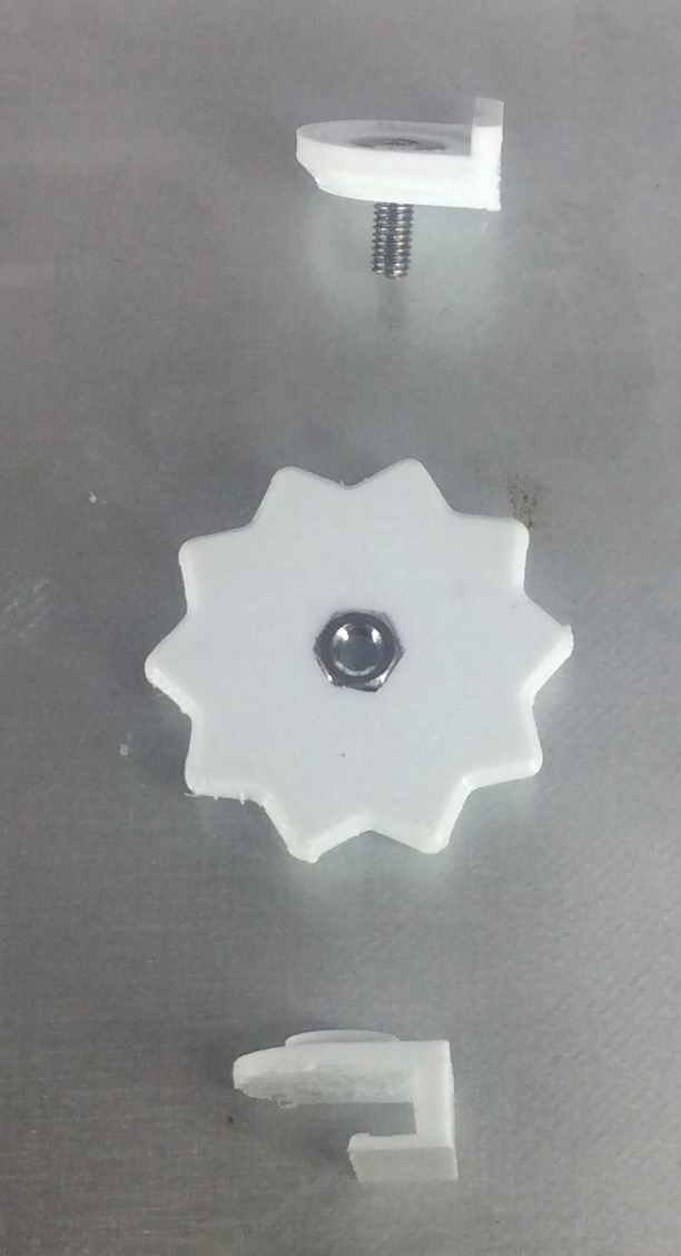

the only little issue with those bits is a) approximate gap is 10mm, b) only way to adjust is to remove and reinsert.

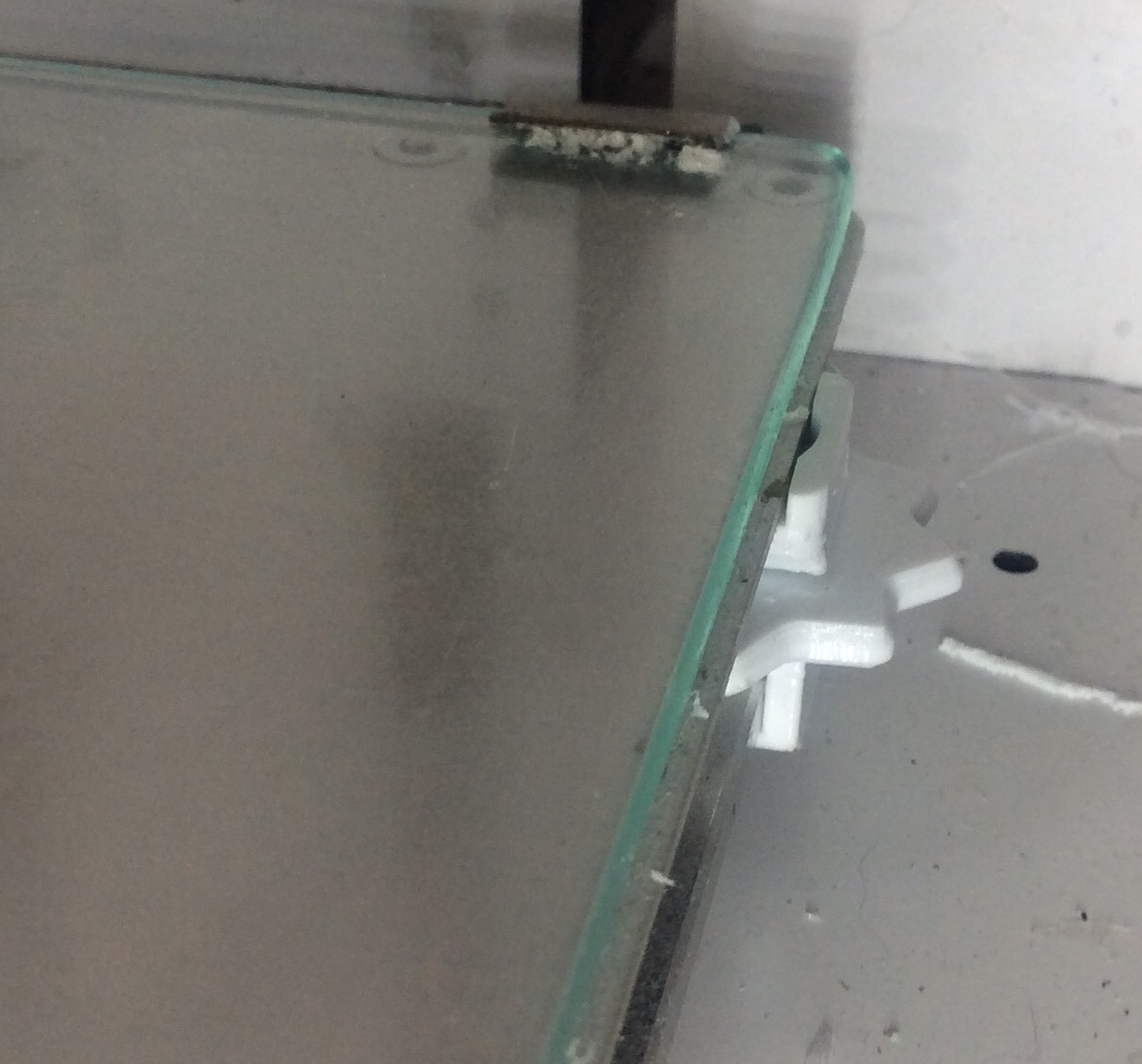

I've designed, printed and tested the little "jack" below, and although not perfectly level I'm now within 0.08mm across my general print area. The 3 printed parts from top to bottom are:
A) Screw cap, m3x8mm screw is inserted, (bore is threaded to lock the screw) the lip goes against the side of the top plate to prevent it rotating.
B) adjuster knob, wit m3 nut pressed into place.
C) bottom plate mount.
The next two photos show the assembly in place on the rear right side as this was the lower point. The last photo shows my levelling test piece, 6 200um thick disks that I print, measure then adjust the screws to suit and print measure and repeat. So my final measurements from back left to front right are:
Back left = 0.12mm
Back centre= 0.20mm
Back right = 0.20mm
Centre= 0.17mm
Front left = 0.20mm
Front Right = 0.20mm
If anybody want to print these parts and try them yourself let me know and I'll but them up on YouMagine.
Other than the 3 printed pieces you will need 1x M3x8mm pan head screw or similar, although a longer screw can be used depending on you gap between the plates. And a M3 nut.
