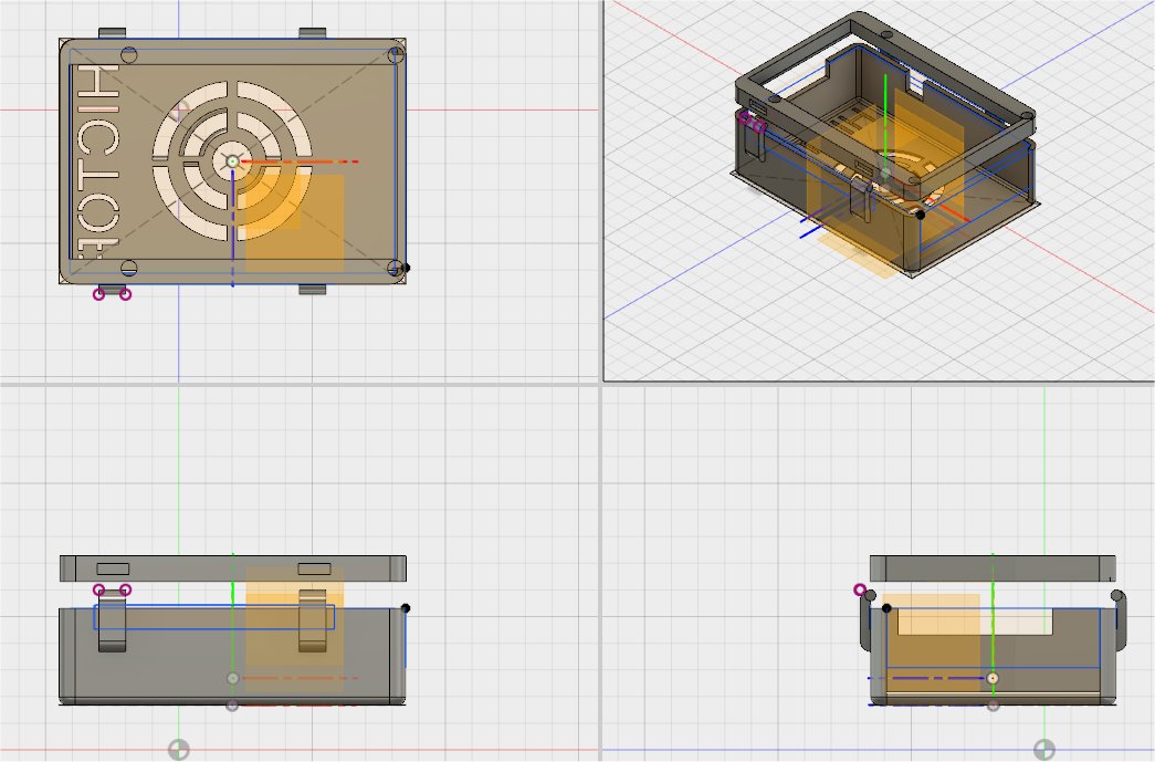

I had never used a cad software before and build this using Fusion 360 Free.
From watching a few You-tube Videos.

I learned the basics of Fusion 360 in less than a day and then started building my Hictop controller case.
As I got stuck I simply went to YouTube and learned how to do the next step until I had the case modeled.
I know that this is not normally the way this should be done but for a sweet program like Fusion 360 Free for hobbyists, it was worth all the trouble. Now that I have the basics down, thought I would go thru all the tutorials and hone in my skills.
