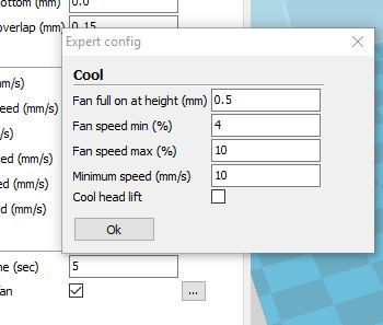

Cura fan settings are as follows

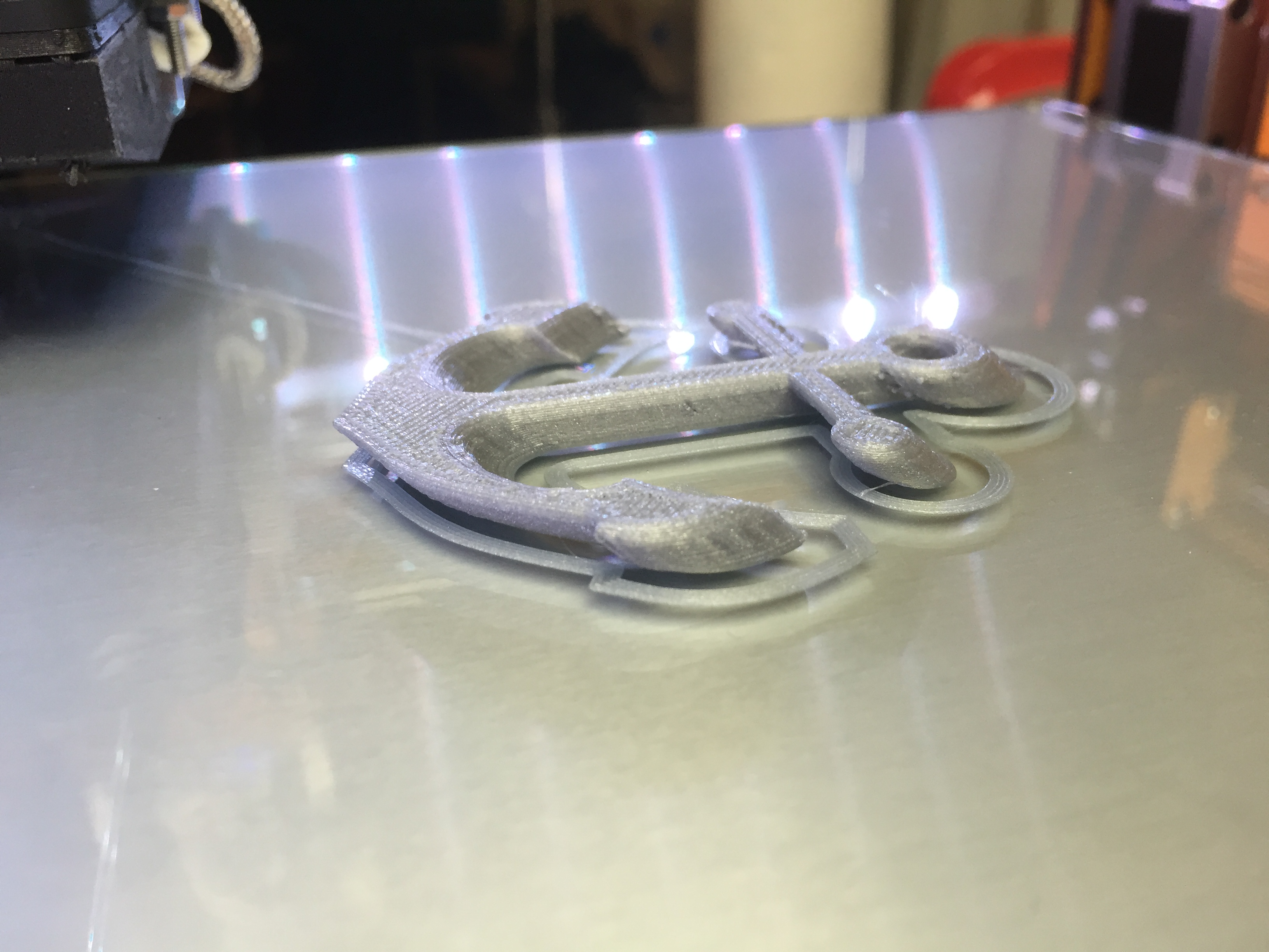

Print result (note left side artifact)
Better view. Not sure if that's an nGen setting or what. But nice to see it's an OK print despite fans not being on.
(Left side view shows artifact on both ends)

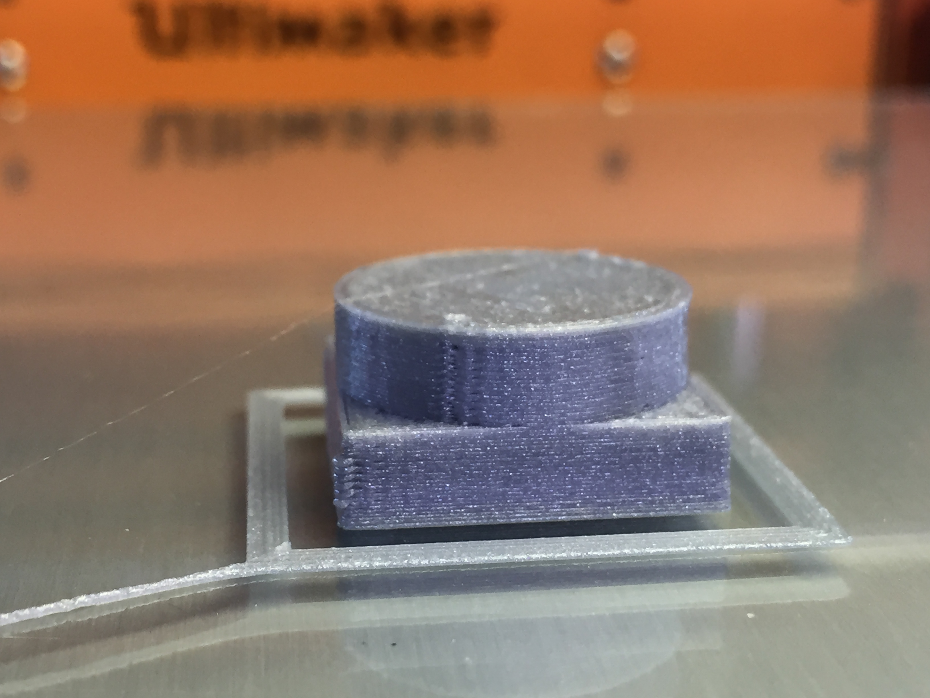

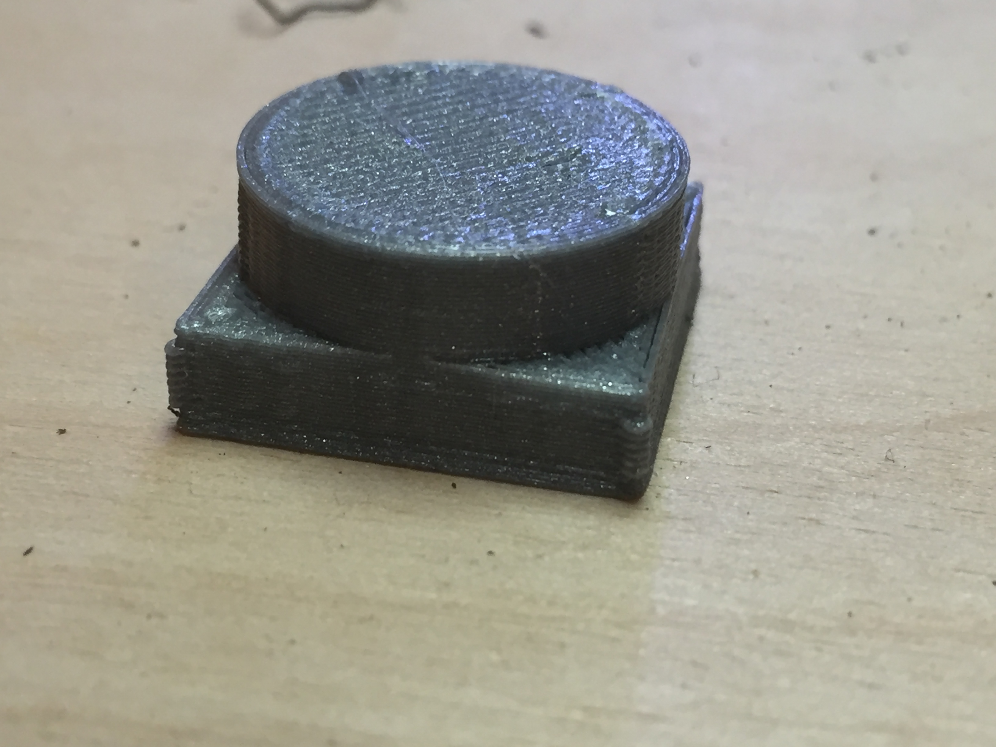

I'm about to put this printer in the trash. More leaning prints

LePaul wrote: (Left side view shows artifact on both ends)
Probably the z-scar...
LePaul wrote: Based on that I am setting the following but not sure 50 fan speed = fan % in Cura?
Should be 50/255 * 100
But that would be quite low -- I would go for the 30%
LePaul wrote:I'm about to put this printer in the trash. More leaning prints
Mmmmmh...
Although this is a common problem, it never happened to me. Double check that your axes are still square (as something might have slipped since last time) and ensure that all pulley screws are tight (not only on the short belts).
The screwdriver provided with the printer is small and it is not easy to apply enough torque on the set screws; I always use a bigger one (I appreciate metric tools is are not easy to get in the US, but a good 2.0 mm hex wrench will help...)

I think 30 is plenty high given the power of the fans. I'm trying to sort out the math. What values should I put in the Cura and fan speeds?

LePaul wrote:I think 30 is plenty high given the power of the fans. I'm trying to sort out the math. What values should I put in the Cura and fan speeds?
Cura uses percentages, so if you set the max to 30% it will be 30% of 255 which is 76 on the Ulticontroller.

Ah so I need to sort out the algebra so fan speed 30 gives me a proper percentage to enter
