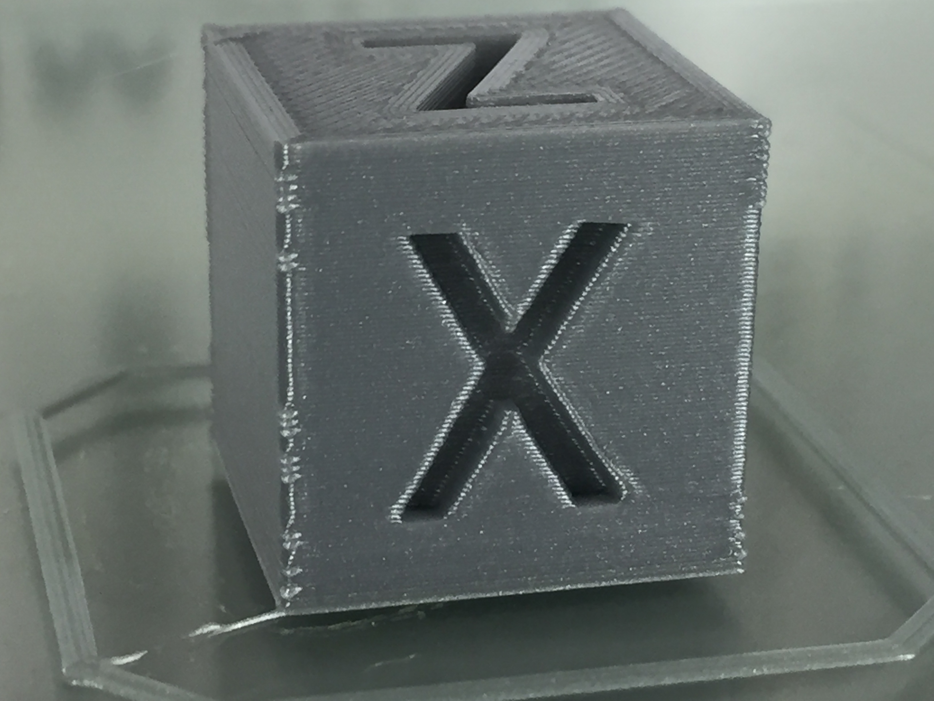

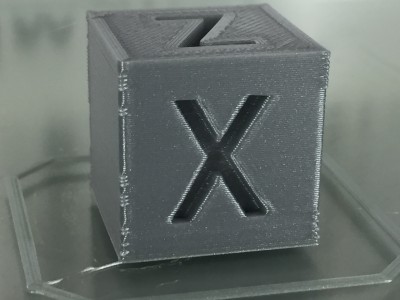

I had it off for these test cubes on two different printers
My Ultimaker 2+
Ultimaker 2+ Extended
Re: Coast at End
With Cura 2.5 (Coasting enabled)

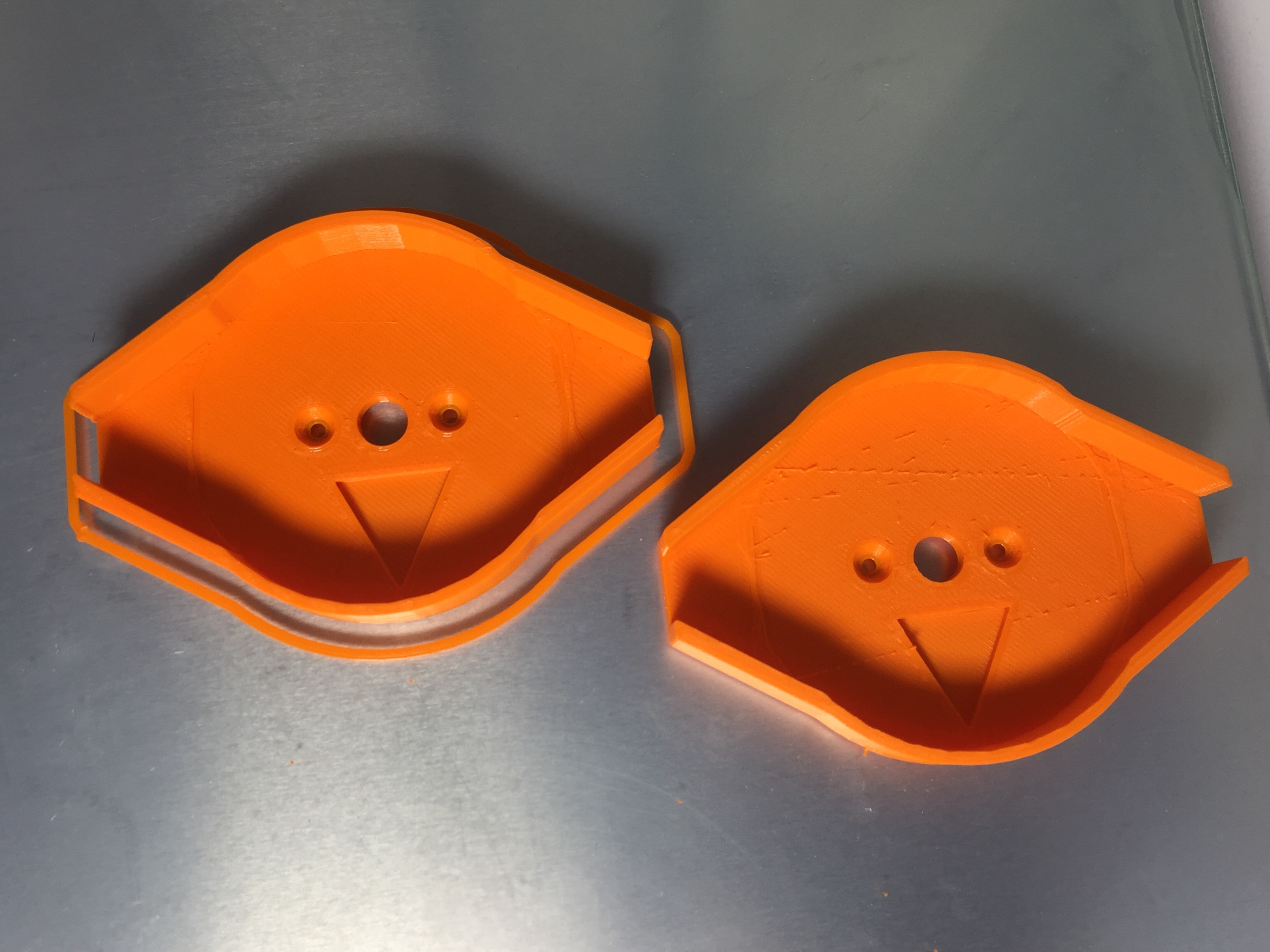

I guess I am a bit stumped on it...I did two of the hub pieces last night ,with coasting off. Came out great! (Pictures coming)

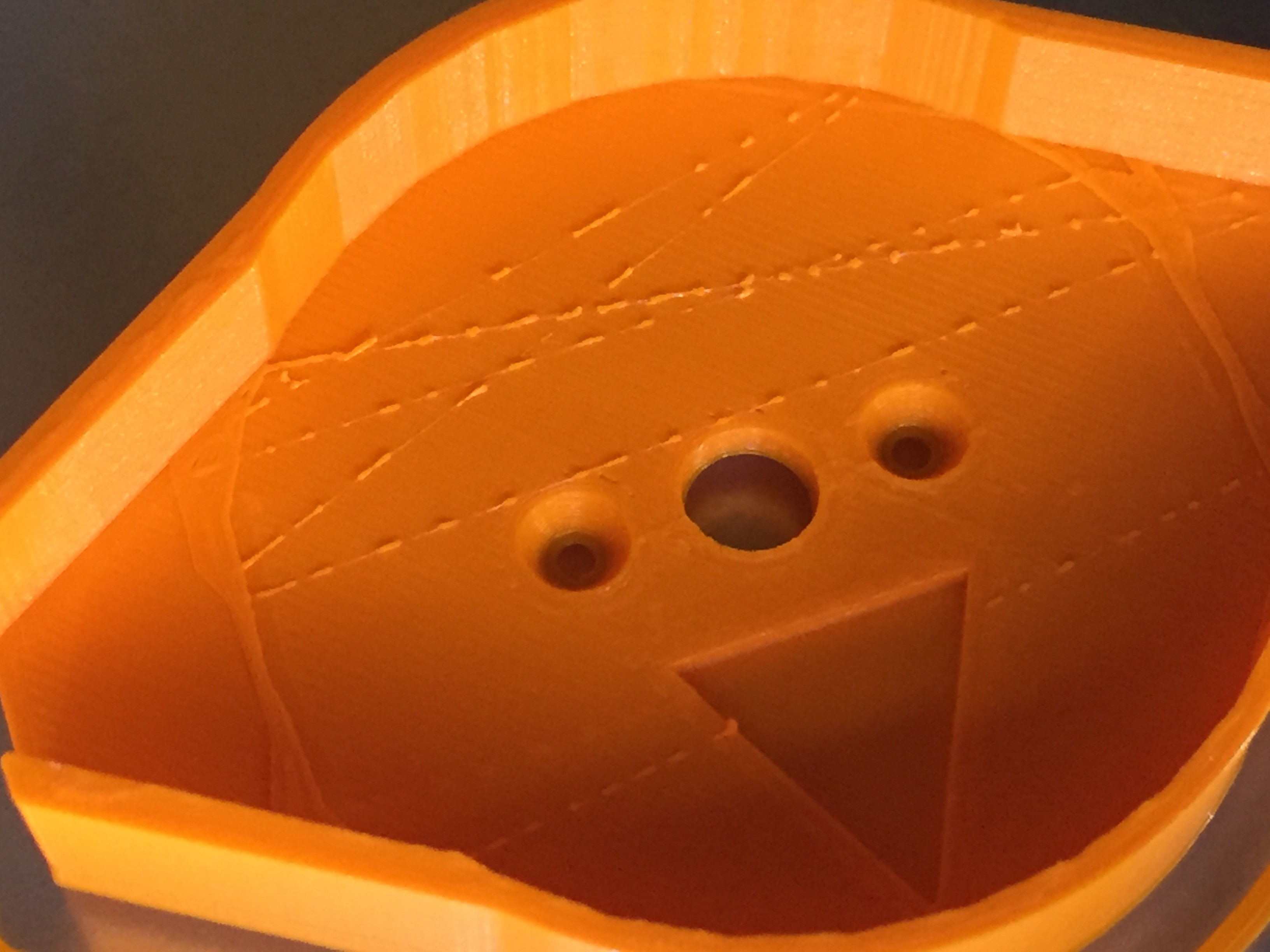

Would Coast at End fix these surface lines?
Re: Coast at End
Coasting assumes your nozzle drips even after a retraction. And that amount then is added to the amount of filament extruded (if doesn't drip).
That and more stuff on a future post of 'understanding why prints like that'.

Well isn't extra. Is just if filament didn't drip, it assumed it did. So depends. There's a more interesting way to remove blobs, but I don't think it can be used the nirmal way. Using negative restart extrusion -0.05 (max) for objets that don't retract much, works amazing for blobs. But it requires to design the object thinking that it will need two different processes. Ofc... you can separate the infill/top/bottom and perimeters quite easy in s3d and use this trick.

I played with this a bit and I could reduce the size of those blobs...but I could not get rid of them completely...and there was a limit when increasing the value didn't improve anything. So to completely get rid of those blobs takes some experimenting and fiddling with more settings :P

I'll try to explain the problem. but is quite big to get a perfect control of all the issues.
First. Motor fails to repeat the movements with or without Torque. (No missing steps, just moves less under torque)
Coasting assumes filament is 'drop' to fill gaps. This releases pressure of filament flexing inside bowden. But as soon it resumes the material on the nozzle have stay X+ time on the nozzle, getting more and more liquid, viscous and more drippy. When the extrusion is resumed, the more liquid filament can move at more speed, making a Hose Effect. Too much make gaps at end and resuming bigger blobs.
About the motor extrusion being so horrible.
http://hackaday.com/2016/08/29/how-accu ... ng-really/
Check the analysis. And assume that the Extrusion is done under torque and Retraction under Notorque (no friction to move it) = Missing MM everytime it moves. With the ZGE at fast speeds, since everything occurs without delay I could actually see this. With Bowden it 'blurs' a bit and makes it much harder to predict.
The solution...
- Extra Retract Distance Negative. Depends on how much torque the motor needs (fast prints, since slow prints at cooler temps everything changes since the Hose Effect is quite hard to actually see).
But to make it perfect, depends on the temperature. I print everything on my stuff at the same temps speeds, that helps enormously to set a number. With the zge is around -0.02 max. But also I need to split the processes to avoid underextrusion when much retractions occur. This way I can control the outside look (where blobs matter) and the details stay at max retractions on a separate process (texts, little details).
Is perfect? Nope.
Solution? A way overpowered Motor motor like Bondtech. And also, a non-missingsteps-board.
This with bowden is muuuch more complex since the variables increase, but it could be used if one knows his materials.
Also.. As a side note. The Hose effect, is actually really usefull for flexible materials at high speeds. Printing 60mm/s 0.2 layers without taking it as a variable would requiere temperatures so high that the material would degrade releasing toxic stuff on the air.

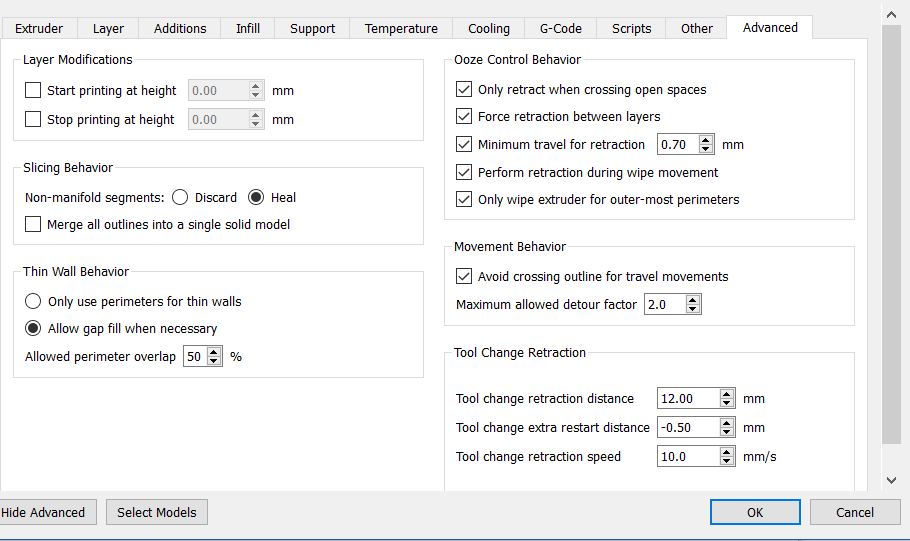

Neotko wrote: Also maybe you have retractions only when crossing open spaces, that removes retractions inside the object perimeter, and the inside counts as not open spaces, so it doesn't retract.
Now that's an interesting comment...I'm at work so no access to S3D at the moment....that must be in the Advanced section?
Re: Coast at End
Yea, last tap
