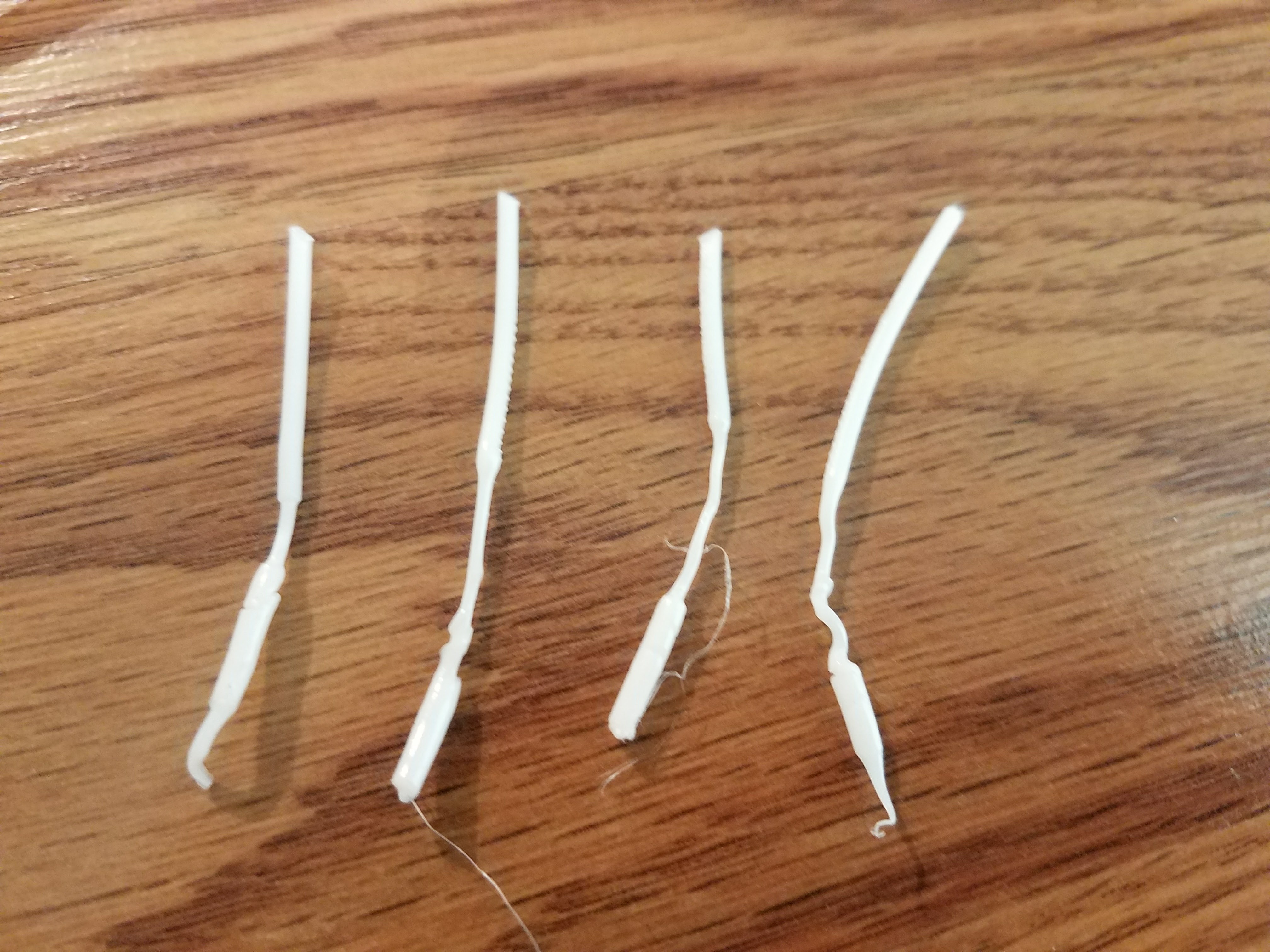

Hey guys,
My Hictop 3DP12 i3 Prusa was working great for several months, and I've enjoyed it. Just for a week now, it continues to jam after 10-30 minutes into a print. The nozzle will clog, nothing will come out, and the machine will go on without pushing any filament out. I've looked through many forums and tried all their suggestions, but none have worked so far. I have replaced the jet fan, throat, and nozzle. I have re-leveled the bed and raised the auto-leveler to avoid the nozzle dragging. I have cleaned out the extruder gear. Still no help. If I pull the filament out after it jams, snip the end, then feed it back in, it will work well again for another 10-30 minutes before clogging again. The interesting thing is that the clogged end always looks the same, 2 normal diameter sections separated by a long thin section (see the attached picture) Could use some help ASAP as I have a delivery to make for this. Thanks in advance!
Matt
Re: Keeps clogging, filament pulls out faster than stepper motor pushes
There are several thing that can cause this, you have eliminated most of them.
First I would Ask if you switch between PLA and ABS this is the major cause of this happening.
Second if the throat the PTFE tubing becomes deformed, Clogging can occur.
Third is that the nozzle and the throat are not touching inside the heating block. Forming a chamber for the filament to pause.
Forth check your cool end fan, this must be working or filament gets stuck in the cool end, at the PTFE gets too hot.
Fifth is checking your thermistor is secure in the heating block. being loose cause the temperature to drop just enough to cause a clog.
sixth is your filament needs more heat than you are supplying. "Not too likely though"
Sometimes your your setting cause problems like retractions, on complicated prints too many retractions can cause a filament clog.
Lastly is that your filament is bad. Try a brand new roll of filament.
Tried to cover everything skip what does not apply.
If I have missed anything, someone will pick up what i missed.

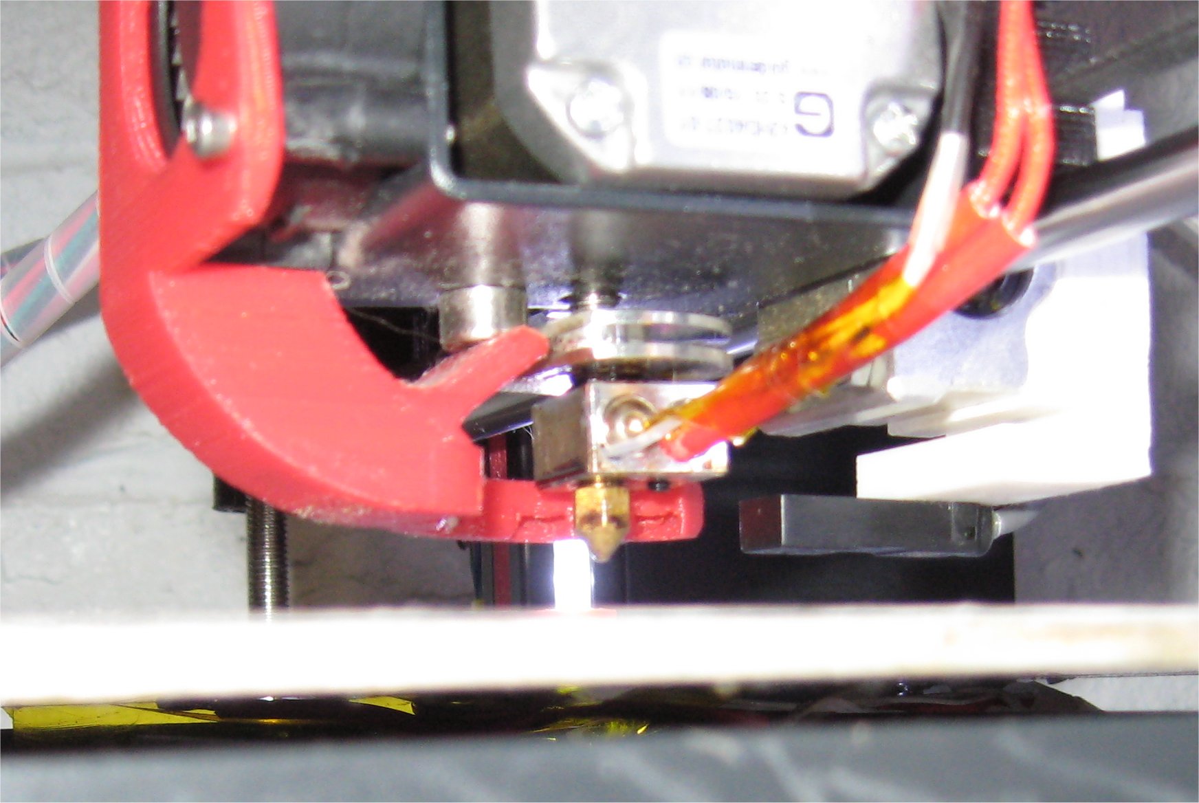

i had this experience when trying to print with carbon fiber filament
i found the carbon fiber was getting too soft on my heatbreak.... sounds like you may have heat creeping...
i now am using a 50mm radial blower as my fan for my heat break and its perfect now.
TheOrvinator wrote: July 23rd, 2017, 11:02 pm Hey guys,
Matt
Hello I have a solution that has been proven My me.
I took one of these heat sinks Cut it in Half between the Fins, making 2 half height Heat sinks.
As Shown.
Remake of Hictop Part cooling Duct
Modified because extruder leaking filament, could not easyily be remove with full circle around Nozzle.
New Hictop extruder duct.stl
(196.96 KiB) Downloaded 988 times
