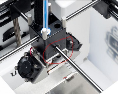

Ok, so when the UM2 print head is rebuilt to 2+, I would really like to have it bolt onto another printer carriage
I am thinking, since the rod bearings wouldn't be used, those plastic pieces could be replaced with a 3D printed one (or CNC'd)
I know for the print head to mount flush with another mount, it should either have a spacer or the replacement piece extrude a small distance outward. I was thinking two horizontal, 5 mm holes would be enough to secure it?

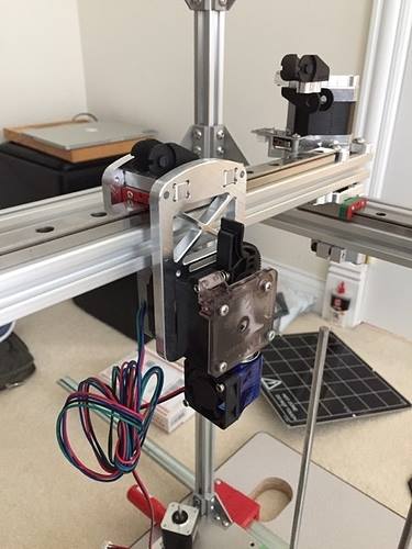

Remove the E3D from this mount and imagine a way to attach the Ultimaker 2 print head in it's place

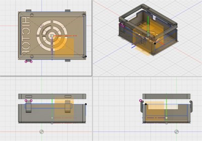

Take a Dive into the world of 3D Modeling.
Thinkercad is for you, it is free it is online and it is so simple to use.
Thou I recommend a free Professional modeling software.
Autodesk Fusion 360 is free for Enthusiast / Hobbyist.
The free Start-Up/ Enthusiast licenses allow you to access Fusion 360 Ultimate with a yearly Free subscription. You can use this license if you are a small business making less than $100,000 per year (or equivalent), or if you're a hobbyist using Fusion 360 for non-commercial purposes.
There a many tutorials on You tube to assist you in making your first Model.

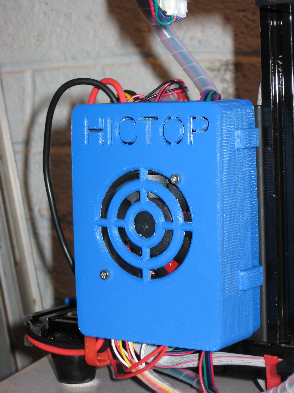

This is my first model after watching the tutorials.
A Snap together case for My Hictop Controller board.

@LePaul, something like this?
Spent about half an hour, fist time i touched CAD in over 3 weeks, just arrived home from a vacation.
You will need to replace the long thumb screws with four M3x35mm screws.
It is designed to fit a 31x31mm hole pattern (Nema17 standard)

I'm using the Ultralight Weight Extruder 713Maker offers (http://713maker.com/ft5.html) Scroll way down.
That's worked really well with my Titan Aero/pancake setup.
With that hole pattern, your mount should bolt right on
