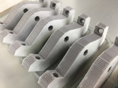

Using Ultimaker PLA Silver Metallic and default PLA profile settings, my last few prints have very thin hairs all over them.
An Atomic Pull came up completely clean and good nozzle shape (one of Ander's test ruby nozzles)
I did 3 more just to be sure...all came out looking good.
Any idea? They clean up quick with a heat gun, but these just started to appear.

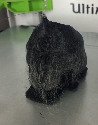

Did your hairy print resemble this one :-?
Re: Suddenly getting hairy stringy prints
What is that Izzy.
That's crazy....I have had hairs like that on many prints but I would say 1/3 of that

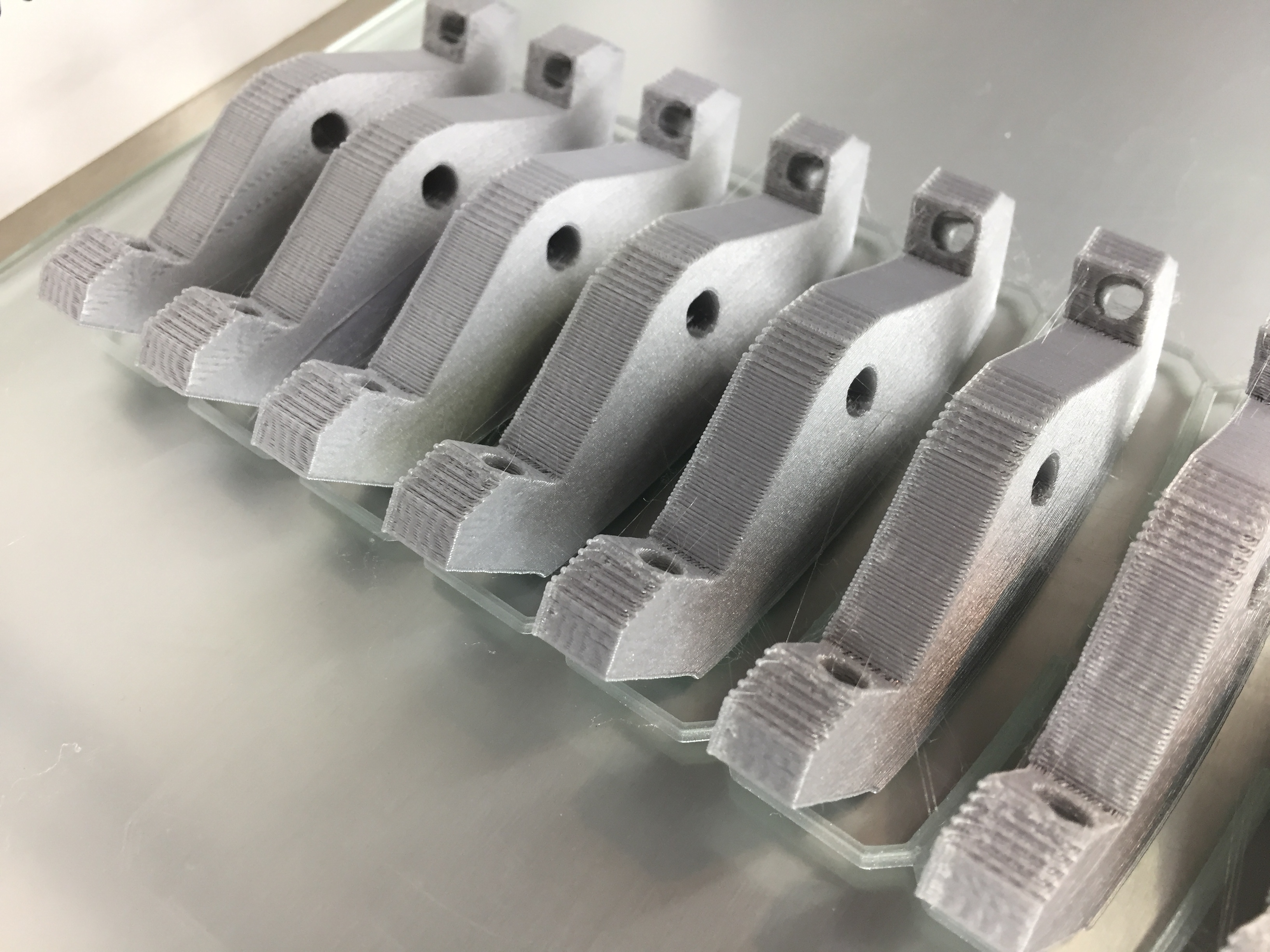

Tried to take a pic of it. Note the center section of the part
My print shown is the hip of the Braq dragon, in Polymaker's PolySmooth, I'm about to test some retraction and fan settings for this material, there's stringy and hairy but this is ridiculous.

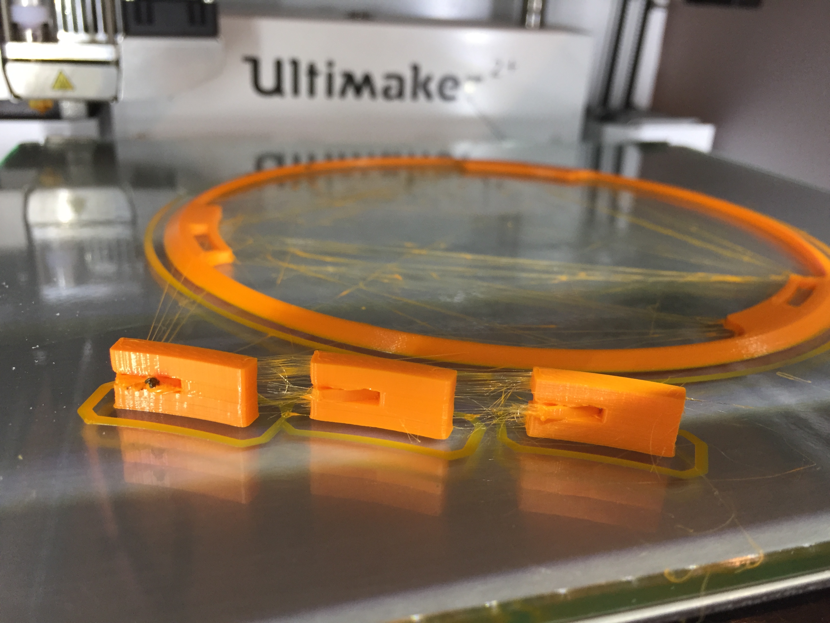

Well I did a few prints with Simplify3D and strings are back

The flow doesn't seem to be consistent. Overextrusion perhaps?
