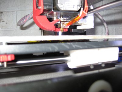

So far, I'm sure I'll have more, I'm having issues with the z-axis and the extruder.
1) Even with the nozzle temp at ~212 (PLA) the extruder just doesn't want to push anything through. Not sure if it's a jam or what.
2) The default z-axis is just below the bed, so as soon as I start a print the nozzle i scratching off the painters tape and leaving marks on the aluminum bed.
Any help would be appreciated!

I just took the extruder fan off the stepper motor and tried to move the extruder motor via the LCD. Nothing happened.

You have to be at least the Thickness of a piece of paper above the bed or you will plug the nozzle with aluminum from the bed.
I have two Hictops both print perfect between 190-200C, 12volt and a 24Volt.
The extruder stepper motor will not function unless you are at least 170C or higher, it is a firmware safety feature.
More likely than not you have plugged the extruder by dragging it across the hotbed. And need to clean or replace it.
To check if the extruder is plugged heat the hot-end while is is above the bed surface 20mm or so.
1. Make sure that the filament feeds to the Hot-end and not stopped by the cooling block. make sure you are feeding about 60mm of filament into the extruder, any less and you are not at the nozzle.
2. When the hot-end reaches 198C while holding the Clamp for the filament like you are feeding it into the extruder. Push the filament into the extruder and see if if extrudes any filament. If not your extruder is plugged and needs replacing, or cleaned.
Cleaning tools can be purchased. I however purchased a set if extremely small drill bits. that were designed for the nozzle.
3. After the extruder extrudes a little filament, and you still have the hot-end at 198C try to extrude a little using the LCD controls.
Remember that the Lcd menu control will extrude or retract you can a hold the filament to see what direction it is traveling.
4. try to print something making sure that the extruder nozzle is at least .2mm above the bed and tape. If there is still no extrusion.
5. Check the direction of the extruder stepper motor My first Hictop the stepper was turning backwards.
This can be done by temporally removing the extruder heater block fan and watching the direction of the extruder stepper motor. while printing any 3D model.
The first thing I printed with my printer was a way to adjust the Z-Axis height accurately. So I purchased a SN04-N proximity sensor and 3D Printed a Bearing mounted adjustable proximity sensor slide mount with thumb screw. This allows me to adjust the height of the nozzle by micro millimeters.

The kit I bought off of Amazon actually came with a z-axis sensor: Sensor. I guess I'm just not sure how to calibrate it or properly position it.
I eventually got the printer to work, but printing directly on the aluminum plate, not tape (printing PLA). Still, I definitely need to run some calibration on it and get everything dialed in, then figure out the best extrude percentage and temp for my spools.

Start Here This is a Slide for your SN04-N. They require a long 3mm screw and small spring with a top thumb screw to adjust.
No firmware changes are required it simply plugs into the Z-End stop socket.
