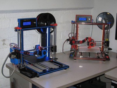

The first 3D Printer 3DP11 12volt is called Red the Second 3DP12 24volt is Called Blue.
Meet the Twins
They Have BuildTak surfaces, Auto Level Proximity sensors, Filament run-out sensors, LCD Cover, Controller Covers with Fans, Heat sinks on all drivers, Power supply case cover, Computer Power Cord socket, Power Supply Switch with a Led Dimmer for interior LED dimming and T slot covers to match their names.
