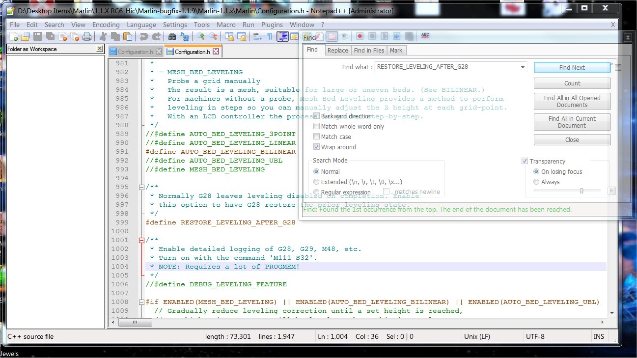

I was reading the Github article
https://github.com/MarlinFirmware/Marlin/issues/10230
Roxy-3D points out the there is a and gives links to the firmware, i can not seem to find this firmware.
#define RESTORE_LEVELING_AFTER_G28
Can any one help with a download location for Marlin 1.1.9 with the #define RESTORE_LEVELING_AFTER_G28 included.

It is in branch 1.1.x, tag 1.1.9. Clone the git repo, then run 'git checkout 1.1.9' to get to that revision state.

Now this was crazy.
Did a search could Not Find "RESTORE_LEVELING_AFTER_G28 "
And I was looking straight at it.
Then I noticed the extra Space in the title, It is crazy because I did the double click to select and then pasted into the search.
