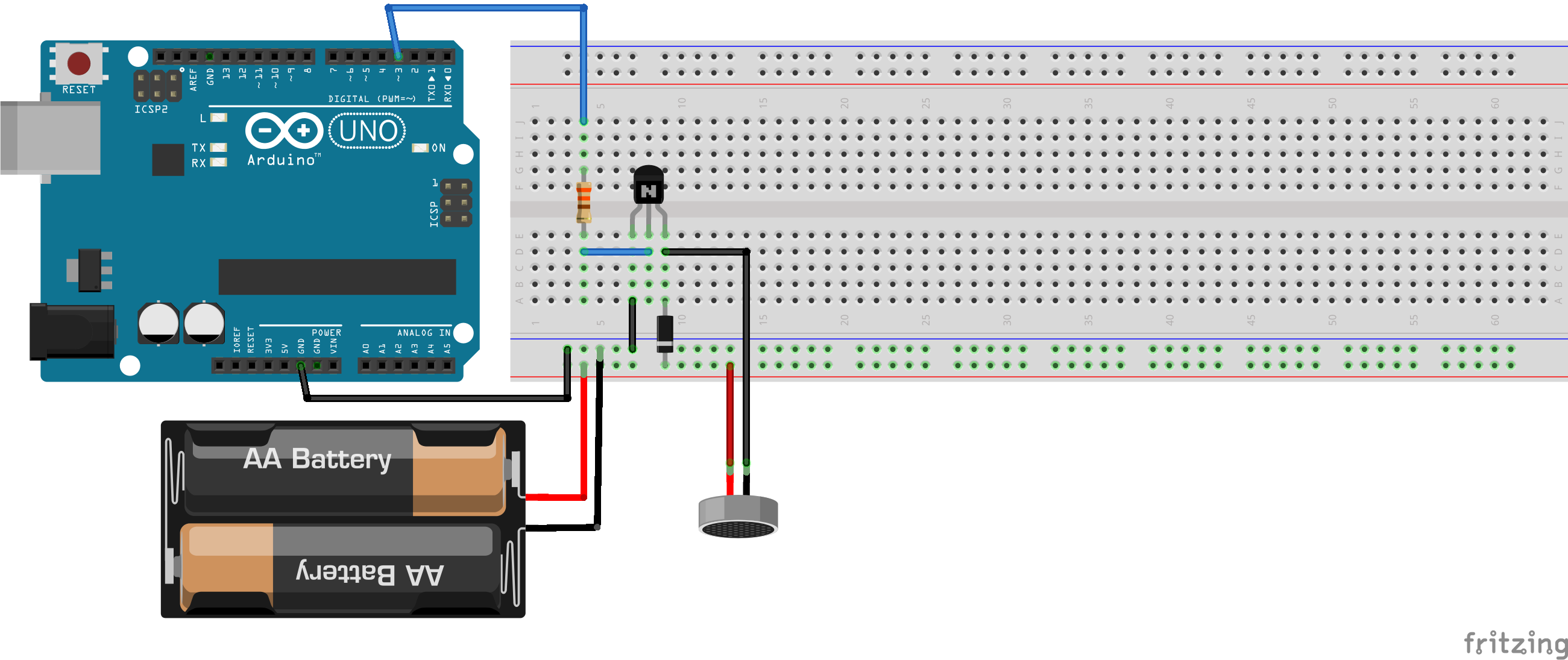

So you need something like this:
For the transistor & diode, use what you have.
For the resistor, to be safe use 2 330 Ohms in series.
That gives us on the breadboard
Now, be careful with the transistor, you need the minus on the emitter and the fan/diode on the collector side (I find the drawing confusing)
Batteries are your 12V battery
Sketch in next episode ;)
