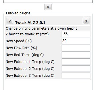

you can adjust Z Axis when printing using baby stepping
#define BABYSTEPPING
Though I believe your referring to Tweak at Z, you can Change printing parameters at a given height.
Tweak at Z.jpg (24.8 KiB) Viewed 14691 times

Just googled 'Marlin Baby Setting' now fully understand about this cool feature.
Thanks again for another useful heads up. 8-)
