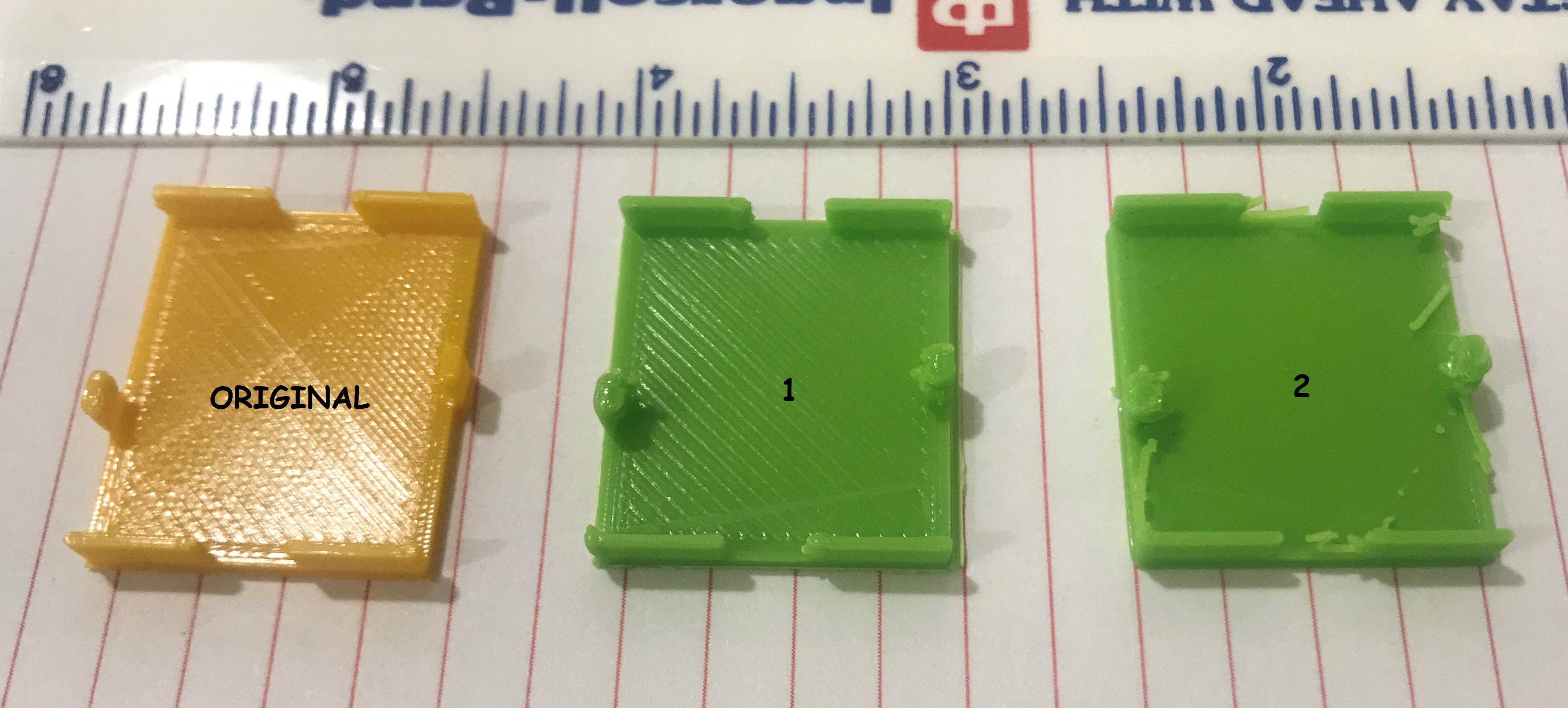

Attached Photo and JPG (inch dimensions) are of item I'm attempting to print

When I print a model similar to the one you are trying to Print I enable a Parts fan at 50% speed.
In some instances printing with supports is required, I do not believe your model requires supports.
Though I have been mistaken before and will be again, as it is difficult to see the overhangs.
When you are printing less and less on the upper layers a "Minimum Layer time(sec) is needed.
