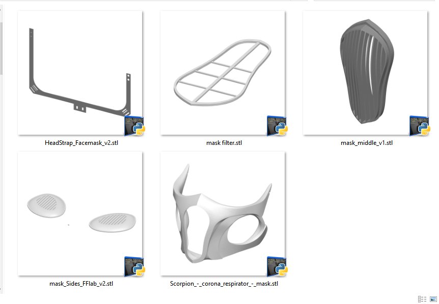

Is there a reason why Cura 15.04.6 will not generate a Support for the attached link model mask_middle_v1.stl
https://www.thingiverse.com/thing:4242337
I would appreciate any help in setting Up Cura 15.04.6 supports for the above model.
Thank You
Cura 15.04.6

Hi @Roberts_Clif,
I just had alook at the link you posted and couldn't find a mask_middle_v1.stl there. I found a "Scorpion_-_corona_respirator_-_filter_middle.stl" which seems to have a flat bottom and no supports needed and a "Scorpion_-_corona_respirator_-_mask.stl" which I tested - I also still have a version of 15.04.6 installed, just in case
- and for me it generated supports for that file. Attached a screenshot of the layer view that shows the supports and a second screenshot that shows the settings used. Machine is a UM2 with Olsson Block.

After downloading the mask I could not find the exact mask so left a link to a similar one.
Above is the mask I Have. model can not get support on in upper right.
Thank you for your assistance.

What I found was on " Ultimaker Community of 3D Printing Experts " posted by Labern " you can change the x-y distance "
Started to Play with the Distance X/Y (mm) found that a change from 0.7 to 0.8 was all it took now I have supports in Cura 15.04.6.
