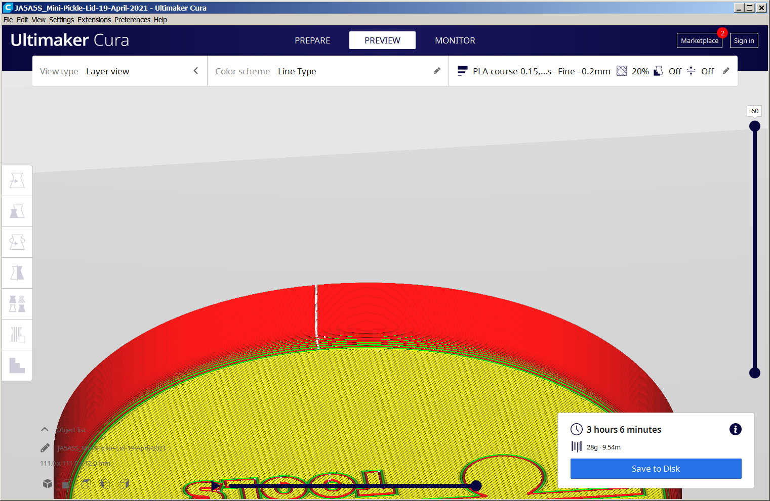

I have just installed Cura 4.90 and looked at the Lid with the "Pip"
I has colours to help see how it prints.
As you can see there is a line where the "Pip" is.
It's just off-centre the same as the part.
I'll have to do some investigating.
Posts: 4059
Re: Strange pip on outside of print
Looks like Z seam
