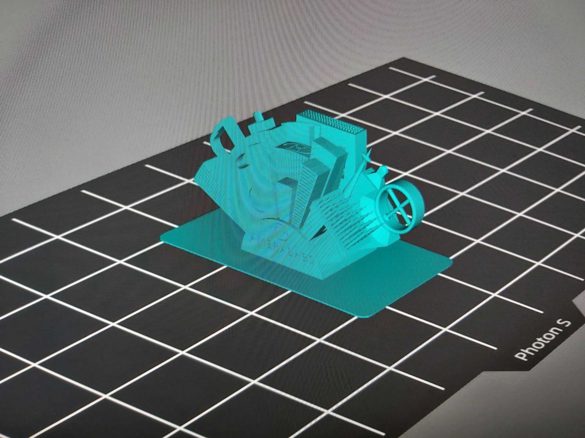

What make of resin are you using. I found the Anycubic had a few problems and switched to Elegoo ABS like, now I get better prints.
Can you post some photos of the failed prints. Also can you do a screen shot of the part in the slicer software with supports.

Have you tried printing a simple model, the one above looks really complicated.
