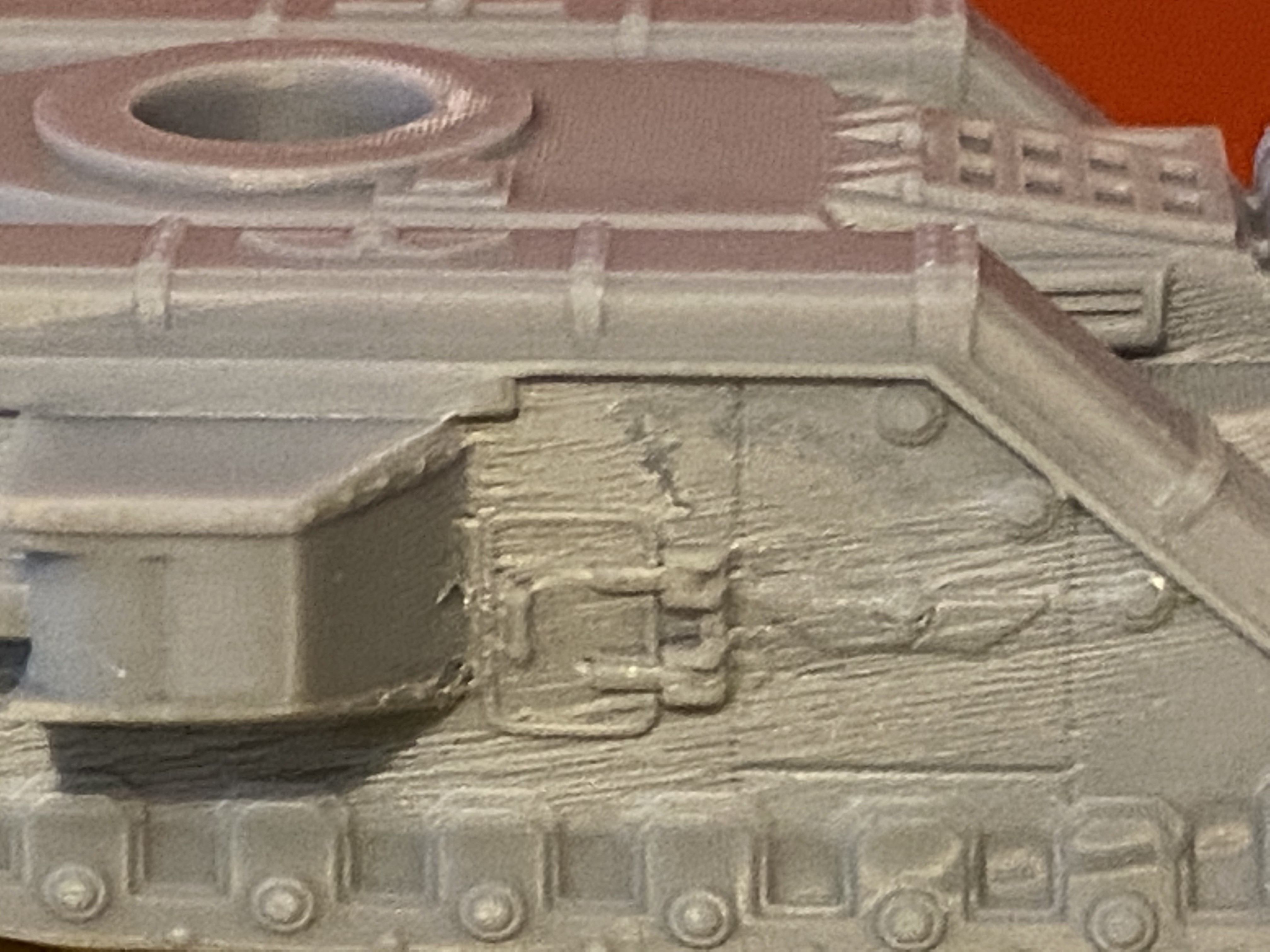

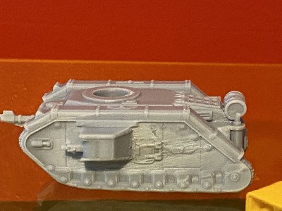

Hello boys. I just bought my first printer, an Elegoo Saturn 2. I am using Elegoo’s Standard Grey resin as I am learning how to work this machine. I have been lucky so far and stumbled into some good prints using Elegoo’s suggested settings.
Today I printed a mini of a Warhammer tank and most of the print came out very well, however on both sides of the print there was some warping. I didn’t notice the issue until after I had cleaned this print in 99% IPA. So this issue came about before I cured it.
The print is not hollow as it is not too large. In fact it’s is a little over twice the original file size.
Any thoughts on what I did wrong? Thanks ahead of time for the advice!
Posts: 4059
Re: I have an Elegoo Saturn 2 and it Rocks, now what did I do wrong?
That's very interesting The YouTube Channel ModBot said he had inconsistent issues and he traced it back to bed leveling using their leveling card.
His fix was bed leveling using a standard piece of paper instead.
