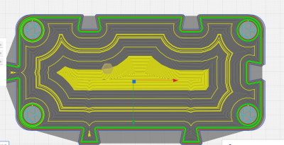

I am running Cura 5.71, and had the same issue in 5.11. When printing a solid base with concentric pattern I am getting a strange order in how it prints. See the screen shot attached. This is exactly how it prints. It increases the risk of a failed print due to it jumping around so much. There is no rhyme nor reason. It prints a single line, skips a few millimetres, prints another line, maybe runs some adjacent ones. Then jumps to another area, prints a line, then goes back and fills in half the middle .... and so on.
Anyone explain this behaviour and how to force it to just do a sequential progressive concentric print.

I'd suggest submitting that to the Cura Github, they answer pretty quickly. Be sure to give them all the details and files needed.
https://github.com/Ultimaker/Cura/issues
