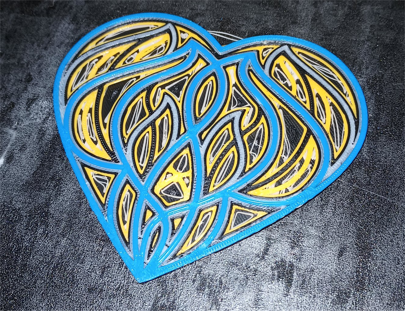

Currently learning to operate my newest Anycubic Kobra 3 combo printers an the Anycubic slicer Next.
I and finding that the print tower is quicker than using the waste bucket, if there is room on build plate.
I am still getting used to them a few minutes ago 3D Printed the model link, using different colors and PLA.
The layer adhesion between the lower black layer and first color change adhesion was not sufficient, I noted nozzle temp dropped 10C.
Though this contributed to layer adhesion problem I also noted that the other layers adhesion was better.
This tells me that small changes in filament temperature can cause significant layer adhesion problems.
The print speed can also cause layer adhesion problems with more detailed models print speed should be reduced.
Looking inside to the second layer you can see the adhesion did not hold very well to the first layer
Want to note this because the Anycubic Kobra 3 print is faster than any 3D Printer I have used,
I have to remember print slower on detailed models too make sure of 2nd layer adhesion.
