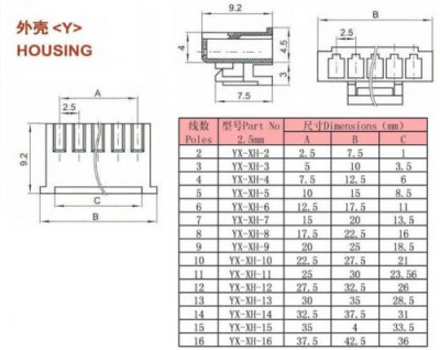

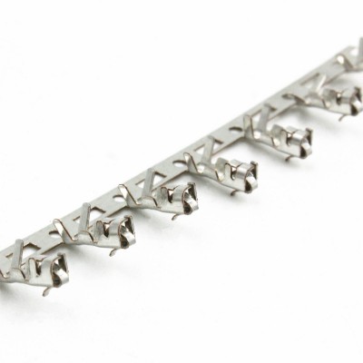

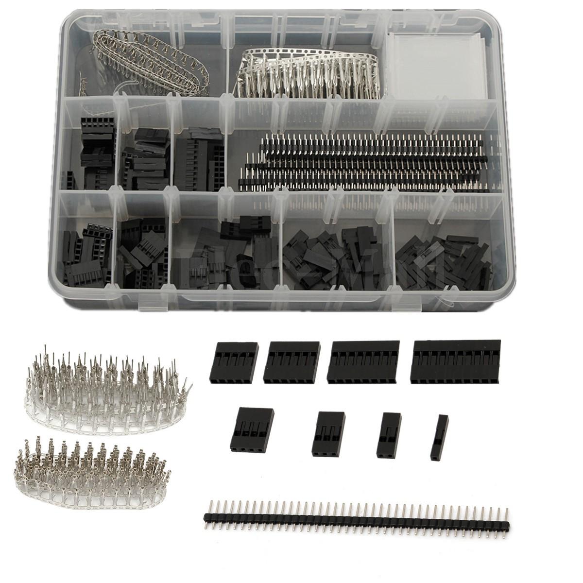

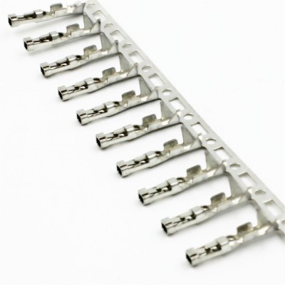

The XH terminals are called XH2.54mm Female Pin Connector Terminal but after you find them they add they are for DUPONT connectors, they aren't, see images.
XH connector part numbers chart to search images and a Dupont Kit I found...
