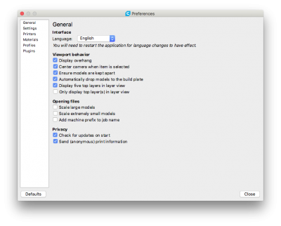

Maybe the first things to check are the Cura preferences. There is an evil one called 'Scale large model' which is checked by default and that one will almost silently resize your models...
Cura Prefs
Cura Prefs

Re: SketchUp with Cura 2.3.1
Yeah many of us got dinged by that auto scaling. I thought they changed the pop up to alert you it had been scaled down to stay on the screen longer?
Either way....it should be OFF by default, in my opinion!

Paul will confirm, but yes it has rescaled your part,
Image 2 it has shrunk to fit, image 4 it is too big for the print area.
It may be that your STL output has picked up a large surface or plain if it is a part that should fit within a 220x220 box.

Be aware that in many cases the part will fit...when the orientation has been adjusted (rotated, moved vertically, etc) But, for some reason, Cura leaves that setting on by default, so it shrinks it to fit the load view....which sucks. I had several parts shrunk down a few percent and I didn't notice it until I tried aligning different portions of the assembly. They owe me some filament!!! :)
Uncheck that option Izzy mentions and move the part around to fit as needed.
