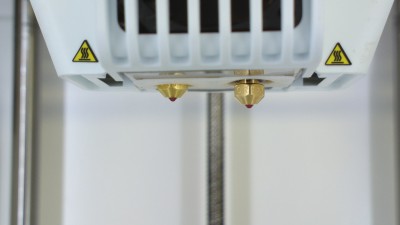

The new active leveling takes less time by starting closer to the build plate.
I wonder if this means that the auto bed leveling is now incompatible with my new heater blocks, where the nozzle sits about 2.5 mm lower? :-?
Auto leveling was working nicely with the rubies by the way.

LePaul wrote:Intrigued, since I hadn't seen any non-Ultimaker nozzle packs supported?
I designed a new heater block for the UM3 some time ago.
We want to print abrasive things with two materials and designing a new block was easier than making new ruby nozzles that fits the UM3-block.
The new block has a feature that reduces the stress on the heatbreak when changing nozzle, without that you would risk destroying the heat break when tightening the nozzle.
I was about to start at thread about it, but there are more people working in similar solutions and I wanted some input from them first.
