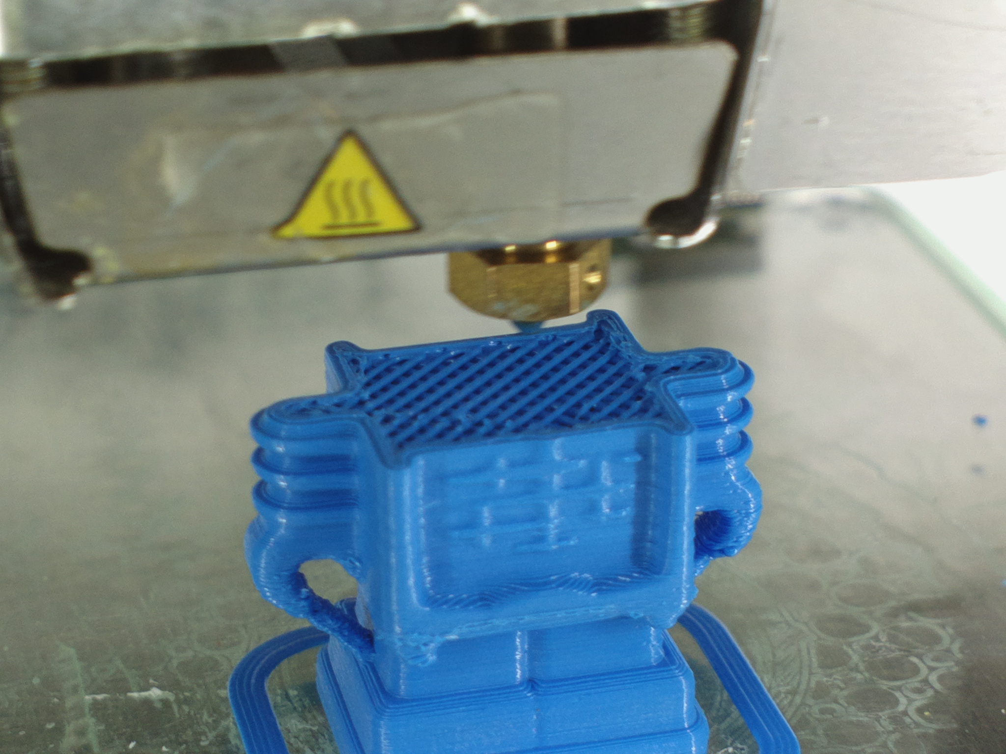

It works really well with 40% infill though, at least with 1.75 mm filament and direct drive
Instantly switching from 30 mm/s at 0.1 mm layer hight (outer wall) to 60 mm/s at 0.3 mm layer height (infill) is no match for the direct drive, it only underextrudes the first few millimeters:
