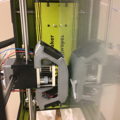

I finally fixed the metal shield for the fan shroud by gudo so now I have better fans on my UM2 head
Running a test print now with the "crappy" reel of Ultimaker filament to see how the fan shroud works and holds together. Fan speed set to 50%.
Once I know it works fine I will make a small modification to the hinges and then print a new version.
PS: Image rotation courtesy of phpBB... DS.

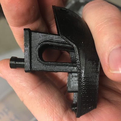

Got everything dialed in pretty good for printing PLA @0.1 mm with Gudo's fan shroud. Fan speed is down to 30% now. For 0.2 and up I haven't tried so much but I think it will be enough to up the temperature a bit.
These photos are from a print with Polymaker Polymax.

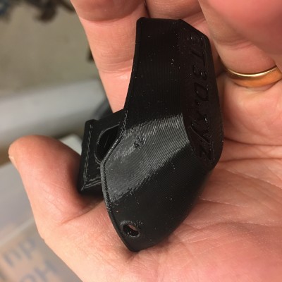

Printed a 3Dbenchy with Colorfabb XT to see if the suggested settings were ok before starting to print all the parts for the F1 steering wheel
So 0.2 mm @245C/70C, 50 mm/s...turned out pretty good. Fan settings same as for PLA.
Bridging looked good also (part for the steering wheel):

Wow, you did that with XT? That's a notoriously difficult filament to dial in correctly
Re: Ultimaker Original+ -- Green Edition
Yes, its XT.
All I did was read the recommendations on Colorfabb's homepage and tried that
The big parts for the steering wheel has some slight warping issues. So that's the one area that I need to improve right now...but for these parts it doesn't really matter. It's a good project to experiment with XT and learn how to use it
